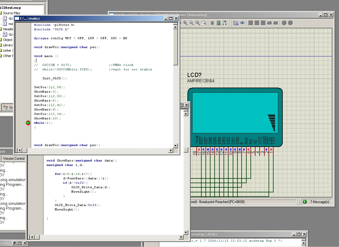

here it is better yet:
void ShowBars(unsigned char data){
unsigned char i,d;
    for(i=0;i<14;i++){
        d=FontBars[(data)][i];
        if(d!=0x55){
            GLCD_Write_Data(d);
            MoveRight();
    GLCD_Write_Data(0xff);
    MoveRight();
//call like:
SetPos(112,58);
ShowBars(3);
SetPos(112,50);
ShowBars(6);
SetPos(112,42);
ShowBars(8);
SetPos(112,34);
ShowBars(10);
it works fine if i remove the *2... remember this:
your looping 14 character inside a 2 dimension array. the array counts each 14 as 1
to better understand fill in the array data:
const rom unsigned char FontBars[11][14]={
11 arrays of 14 byte data meaning
1 = 0-13
2 = 14-27
etc.... but the array sees it as
1 = 0-13
2 = 0-13
etc....
the 1 and 2 are address to the 14 byte data start so if array 1 is in address 0x10 then array 2 starts at address 0x10+14 = 0x1A
so :
ARRAY ELEMENT             ADDRESS             bytes
         1             0x10             0-13
         2             0x1A             0-13

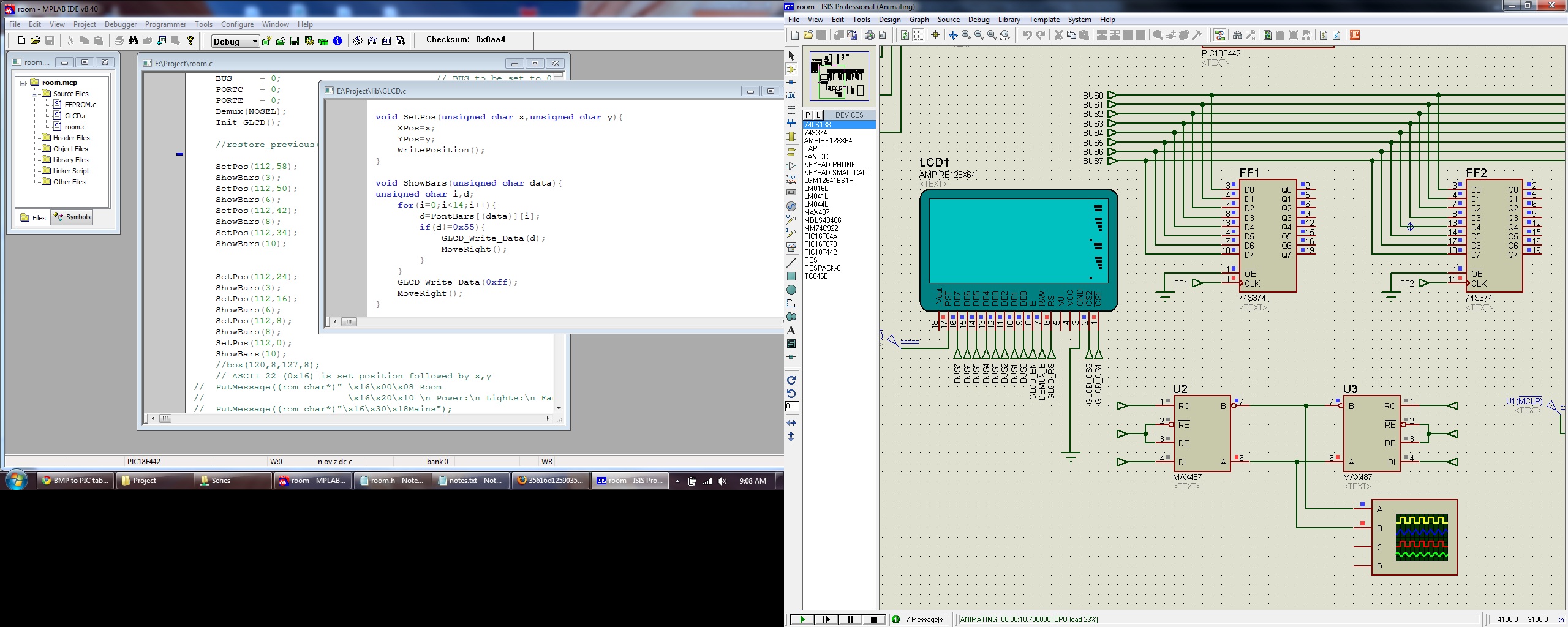

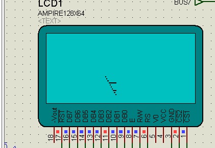

You code is not working :( Also when i remove the * 2, the result doesn't remain the same.
unsigned char i,d;
switch(data){
case 0:
data = '0';
break;
case 1:
data = '1';
break;
case 2:
data = '2';
break;
case 3:
data = '3';
break;
case 4:
data = '4';
break;
case 5:
data = '5';
break;
case 6:
data = '6';
break;
case 7:
data = '7';
break;
case 8:
data = '8';
break;
case 9:
data = '9';
break;
case 10:
data = ':';
break;
for(i=0;i<14;i++){
d=FontBars[(data-48)*2];
if(d!=0x55){
GLCD_Write_Data(d);
MoveRight();
MoveRight();
Works fine, takes both ShowBars(*"8") and ShowBars(8) to display correct :)

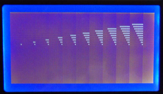

You really don't need to define characters, this is what the code I posted earlier produces.

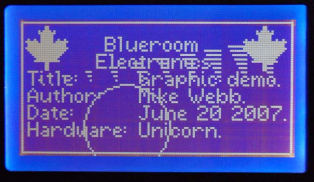

Try this function,
void PutBars(unsigned char x,unsigned char y,unsigned char Percent){
unsigned char i;
        for(i=(100-Percent)/10;i<10;i++){
            vline(x+i,x+10,y+2*i);
It puts the display at x,y with percent/10 bars.
This is what I get with,
        PutBars(0,10,10);
        PutBars(12,10,20);
        PutBars(24,10,30);
        PutBars(36,10,40);
        PutBars(48,10,50);
        PutBars(60,10,60);
        PutBars(72,10,70);
        PutBars(84,10,80);
        PutBars(96,10,90);
        PutBars(108,10,100);
Edit, it looks like the emulator isn't emulating reading the display correctly.
With text etc.

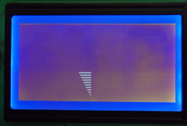

Edit, just had a thought, I made i local in my copy. Try,
unsigned char k;
        for(k=(100-Percent)/10;k<10;k++){
            vline(x+k,x+10,y+2*k);

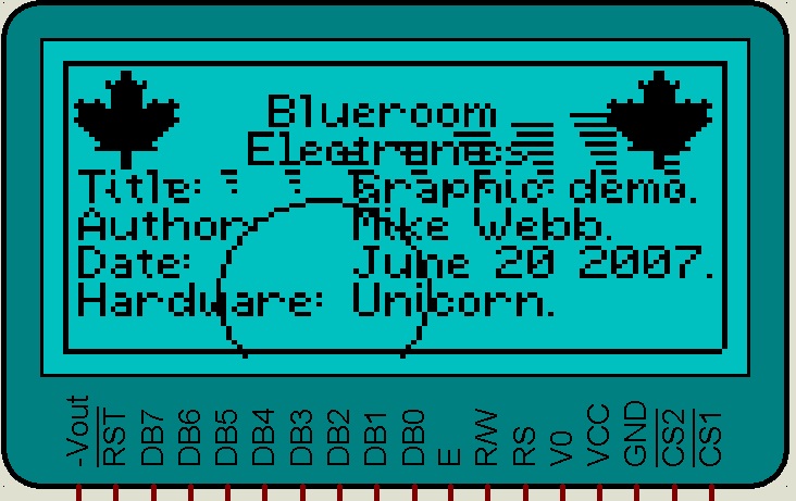

Pommie can you please kindly send me the library files you are using. Also the controller name of your GLCD. I want to test this on proteus. In my one year experience with Proteus, its never deceived me once from the actual output in hardware.
Here you go Pommie :)
Seemed as my GLCD library was different :)
I told you its not usual for Proteus to mislead :)
Thank you very much for bearing with me, i know i am a newbi (as said in my account profile)
AtomSoft thanks to you too for your time and effort. :)
