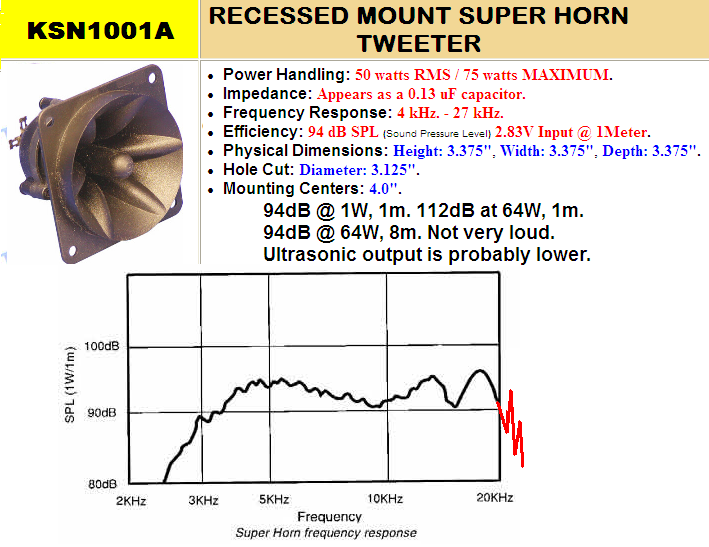

Use a piezo tweeter, intended for PA use - they are probably the easiest to obtain (and cheap) and will provide reasonable power levels beyond human hearing.

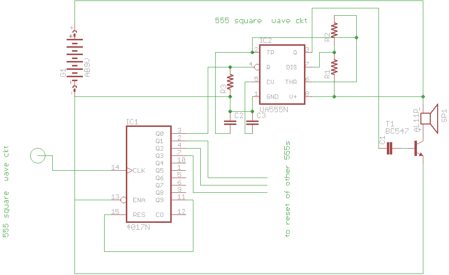

The circuit I have already uses a PIC that output a random frequency from 2khz to 6kh.
My new design idea is cycle from 2 khz to 8 khz and a second "sounder" that outputs from 15khz to 20khz.
I think a PIC can output a frequency that high.
THEN add an amp maybe?
ALL using a single PIC. We don't need no stinking badges oh i MEAN 555 ETC.
Reason for the lower frequencies is a study done at some University that showed that deer responded better at 2 - 8 khz than at ultrasonic frequencies.
A piezo tweeter has many resonant peaks. Here is one with a 12dB peak at about 12kHz and another at about 18kHz. We don't know what is its output level above 20kHz but it probably drops off. It won't be loud enough to scare away an animal unless its power is 64W and the animal wears it.
The target species that I am wanting to scare off is a deer. Deer can hear up to a mile away and ability to determine direction.
Just what EXACTLY is FREQUENCY RESPONSE vers FREQUENCY RANGE?
That "speaker" you posted looks like a winner but driving it may be a whole other ball game.

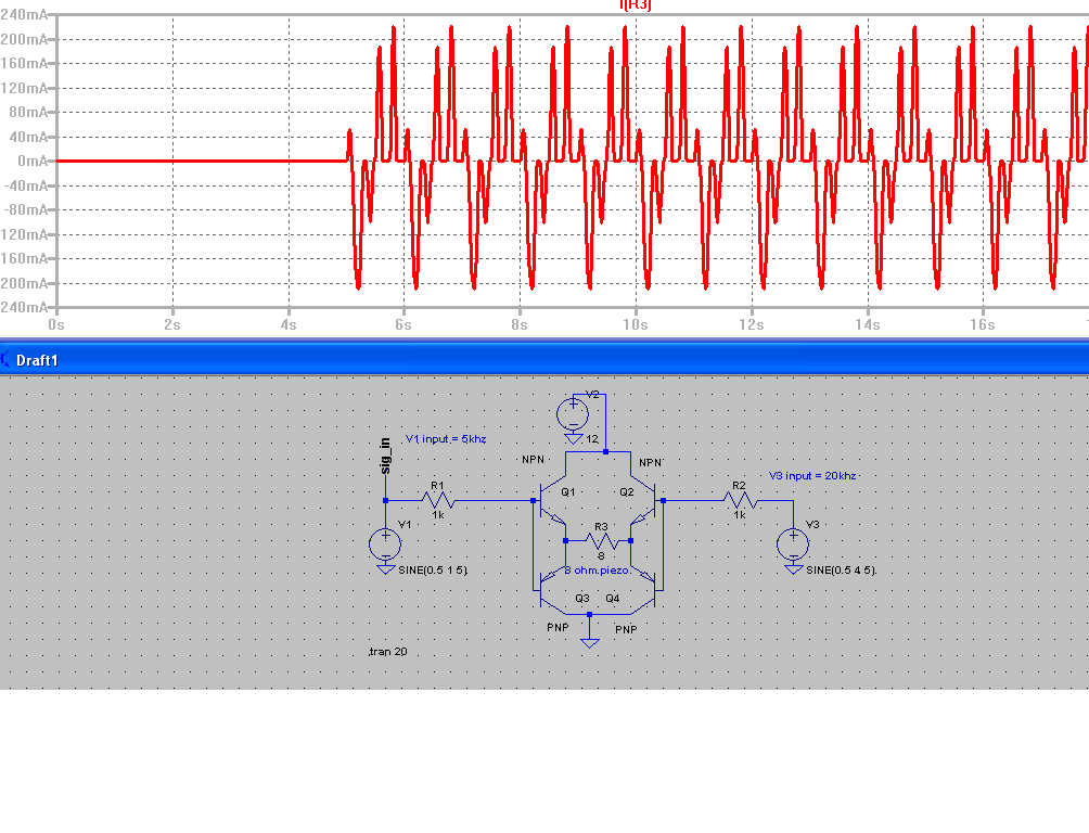

Planning on MAYBE a small amp. Saw a schematic that uses 4 NPN transistor in a push pull type amp.
Was/am contemplating on even an LM386 but using a better amp may be a better decision.
crazy idea or not??
Got to contemplating what would happen??
inputing two different signals into a push pull amp.
One input 5khz and second input 20khz.
Using LT SPICE with 1hz and 4hz inputs.
Would it even work??
