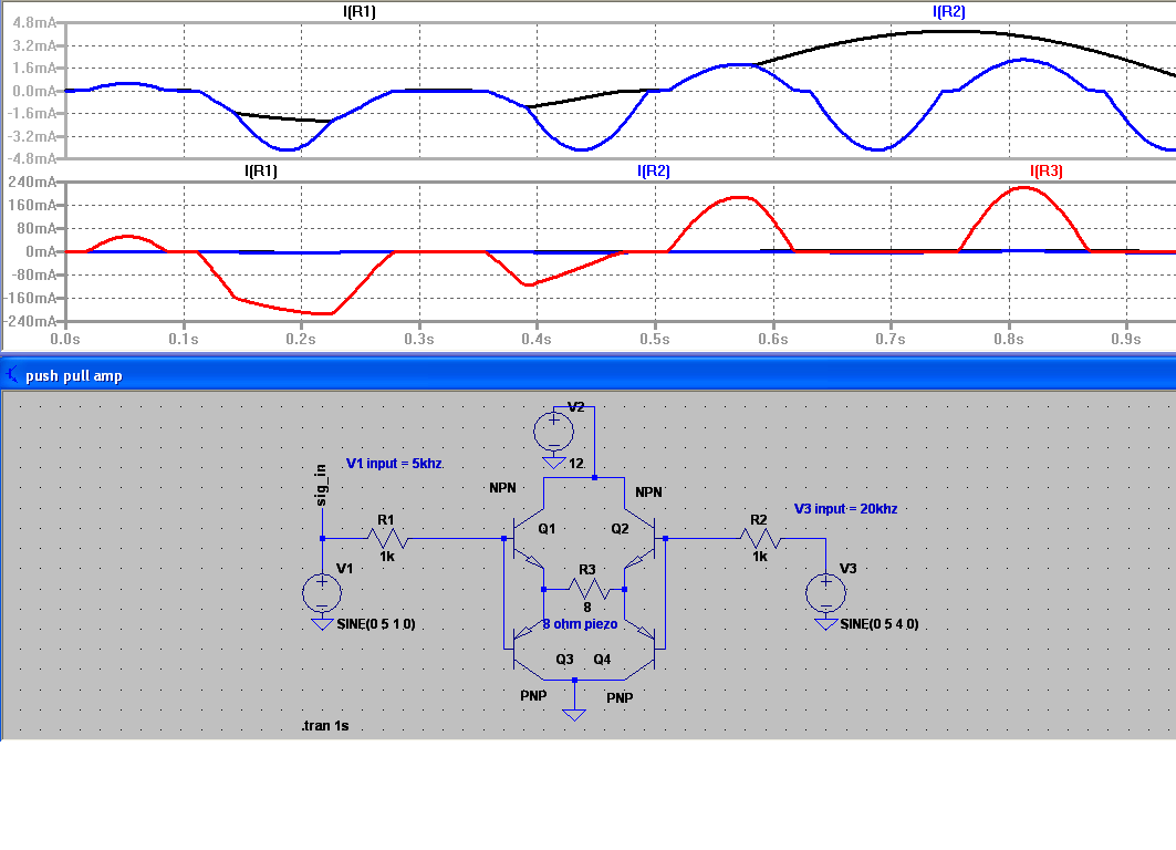

Contemplating the push pull amp I posted earlier. And inputting two different random frequencies 2-5khz for one input and 15-20khz for second input.

using this amp I assume that it puts out 2.4 watts of power?
240ma X 12v = 2.4 watts
the input resistors show very little amperage but the 8 ohm resistor (piezo horn tweeter) shows upwards of 230+ma.
am I in the ballpark or am I missing something?
I need to find the impedance of
I calculated 4.8W into 8 ohms in an earlier post.
The piezo tweeter is not 8 ohms and its loudness is calculated with the voltage that is produced into 8 ohms.
The GT1016 tweeter is not loud enough with only 4.8W. It is rated at 94dB with 1W (2.83V RMS) at a distance of 1m.
You will feed it 4.8W so its loudness at 1m is 101dB.
It will be 95dB at 2m.
It will be 89db (not very loud) at 4m.

The impedance doesn't matter because it is not a coil and magnet speaker. It is a piezo which is like a capacitor. Its output level is rated at the voltage that an amplifier produces 1W in 8 ohms.

The datasheet for the TDA1518 and for every other ordinary car radio bridged amplifier IC shows that its output is 22W at a horrible-sounding 10% distortion (it is clipping like crazy because its volume control is turned up too high) into a 4 ohm speaker and when its supply is 14.4V. Its output is only 10.1W at clipping into 4 ohms when its supply is 12.0V. Then its output voltage is 6.4V RMS which produces only 5W into 8 ohms.
