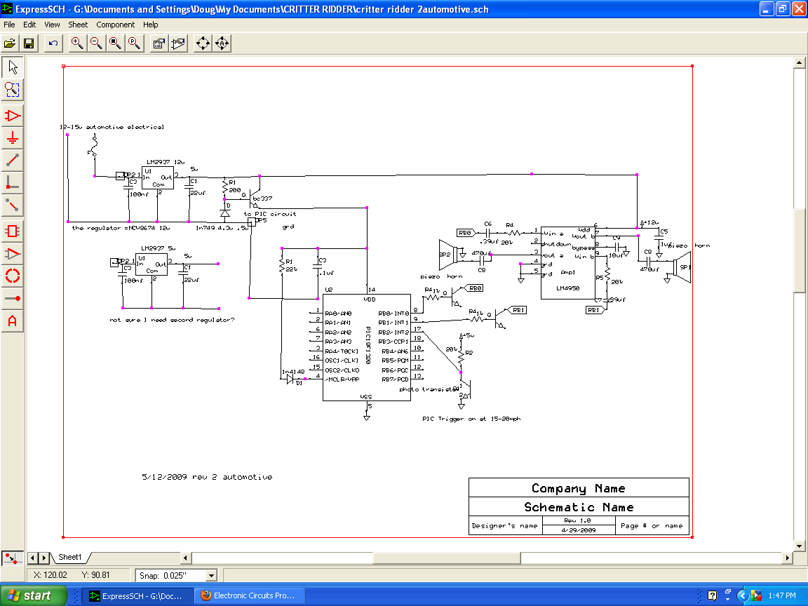

Here is a prelim schematic.
How do I know what the impedeance is or just wait until the tweeters get here?
Hopefully just connect?
Any guidance is welcomed.
Thinking of using two voltage regulators? as indicated on schematic.
I am learning by doing and asking for suggestions.
No impedance, it doesn't matter - it's NOT a voice coil.
Why regulators at all? - isn't that a car chip anyway? - google doesn't seem to find much about it.
I am generating the randoim frequencies using a PIC (see schematic) so 5v is needed.
This unit is placed outside the car in behind the grill.
As for impedence, BLT SOUND (purchased 6 tweeters from) sent me an Email suggesting if connecting to an amp then put an 8ohm (thinking 2ohm) resistor in series with tweeter. About a 5-10watt resistor. sounds kinda big??
Feed the PIC via a regulator, but not the amps.

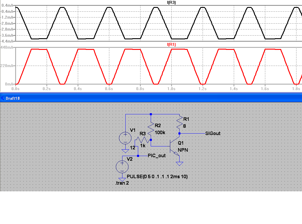

Would a 1 transistor amp between the PIC outputs to the "power amp" help any or just spinning my wheels?
add from PIC out to amp input
to increase the output of the PIC?

Mr DEB,
You have the LM4950 amp as a stereo amp so its output is very low (1.7W). Instead you should use it as a bridged amp so its output is much higher (5W to 6W). Its bridged output can drive a few piezo tweeters.
The Piezo tweeters are capacitors so the 470uF output coupling capacitors are not needed. A bridged amp also does not need an output coupling capacitor even with a normal coil and magnet speaker.
If you have a 50W amplifier then 5W to 10W resistors should be in series with the tweeters. A 2W resistor is big enough with your low power amplifier.
The resistors in the circuit for the LM4950 amp sets its gain so an extra transistor is not needed.
But your schematic is missing the negative feedback resistors so it won't work.

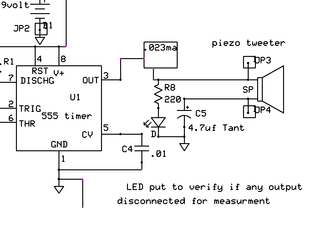

results of 555/tweeter connection test
Got my tweeter horns on Saturday **broken link removed**
then connected a 555 to see how much the circuit draws etc.
used a 8uf cap so I can hear - I get sound, GREAT no smoke!
used .01 cap and just a clicking upon connection, no sound but LED is lit so must be outputting.
disconnected LED, inserted DMM in line with tweeter and 555 pin 3
set meter on 4ma scale and get .o23ma
awfully low??
awfully low??
is this right??
Output from a 555 is going to be low, but you can't use a multimeter in that way, it won't read anywhere near accurately so doesn't give you any idea what the current might be.
You also don't require a capacitor in series with a piezo tweeter.
