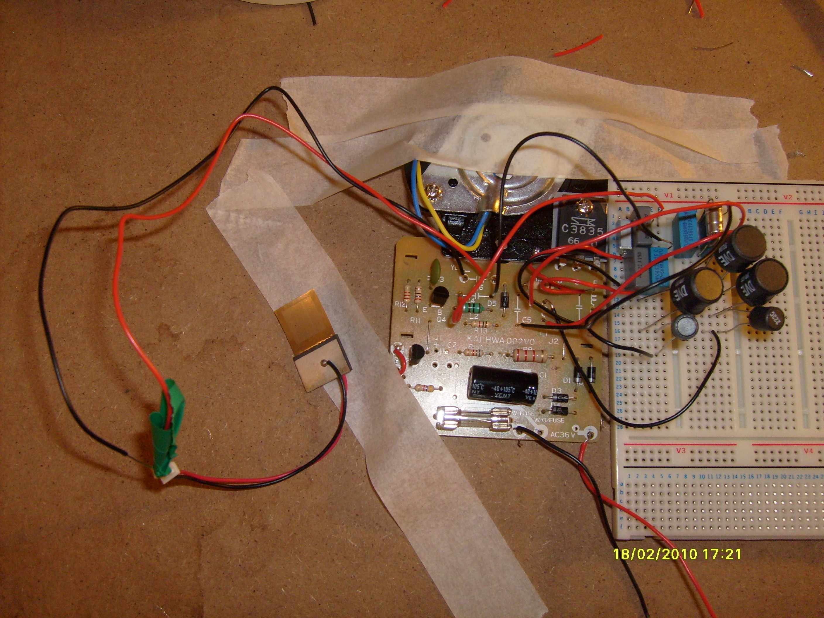

Hi Eric,
I took out C4, C5, C6, L1 and L3 and replaced them with wires. I fed those wires to a breadboard, on the board were components scaled up by around 16. I checked the cap and inductance of the values on the breadboard (inductors in series and caps in parallel) and then connected it all together. I replaced the atomiser leads with the 130KHz piezo atomiser.
C4 = 1.195uF
C5 = 273nF
C6 = 18.25nF
L1 = 753uH
L3 = 47uH
The piezo briefly buzzed and I got a voltage reading of 9V and I think 50Hz (could be wrong) and then the circuit died. I tested the piezo and it still buzzed happily in the audible range.
Could you think of anything I did wrong? I will put the circuit back together and see if it still works, but I don't think it will. I can keep the original piezo and will throw away the circuit board, but what about the components on the breadboard. How would I know if it was ok to keep any of the caps and inductors on the breadboard?

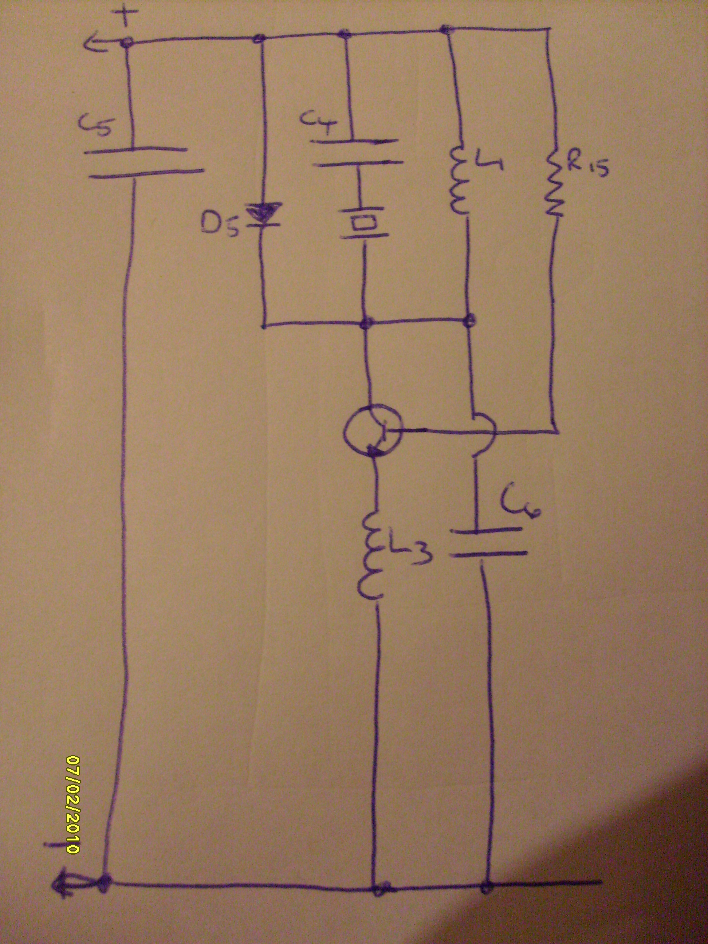

It occurs to me that this result was inevitable. Should I close down this avenue? I don't have enough experience of electronics to know whether this is likely to happen again, or have much idea what went wrong. I could make sure the circuit really is dead and if so buy some more. I did quite enjoy testing it :)
Regards,
Antknee.
Edit. I hadn't connected C6 properly and seem to have blown a fuse. Maybe the circuit has survived. Too tired for any more testing today.
Hi Antknee,
I'm visiting family a few states away right now so can not provide a proper answer. Will be back on Sunday. I would not expect a calculated component substitution to work on first try but rather you will need to tweek it to achieve resonance.
Since you are starting with the circuit shown in your S6307065.jpg, the transistor base biasing is through more resisors to V+ than shown in your latest sketch (I assume).

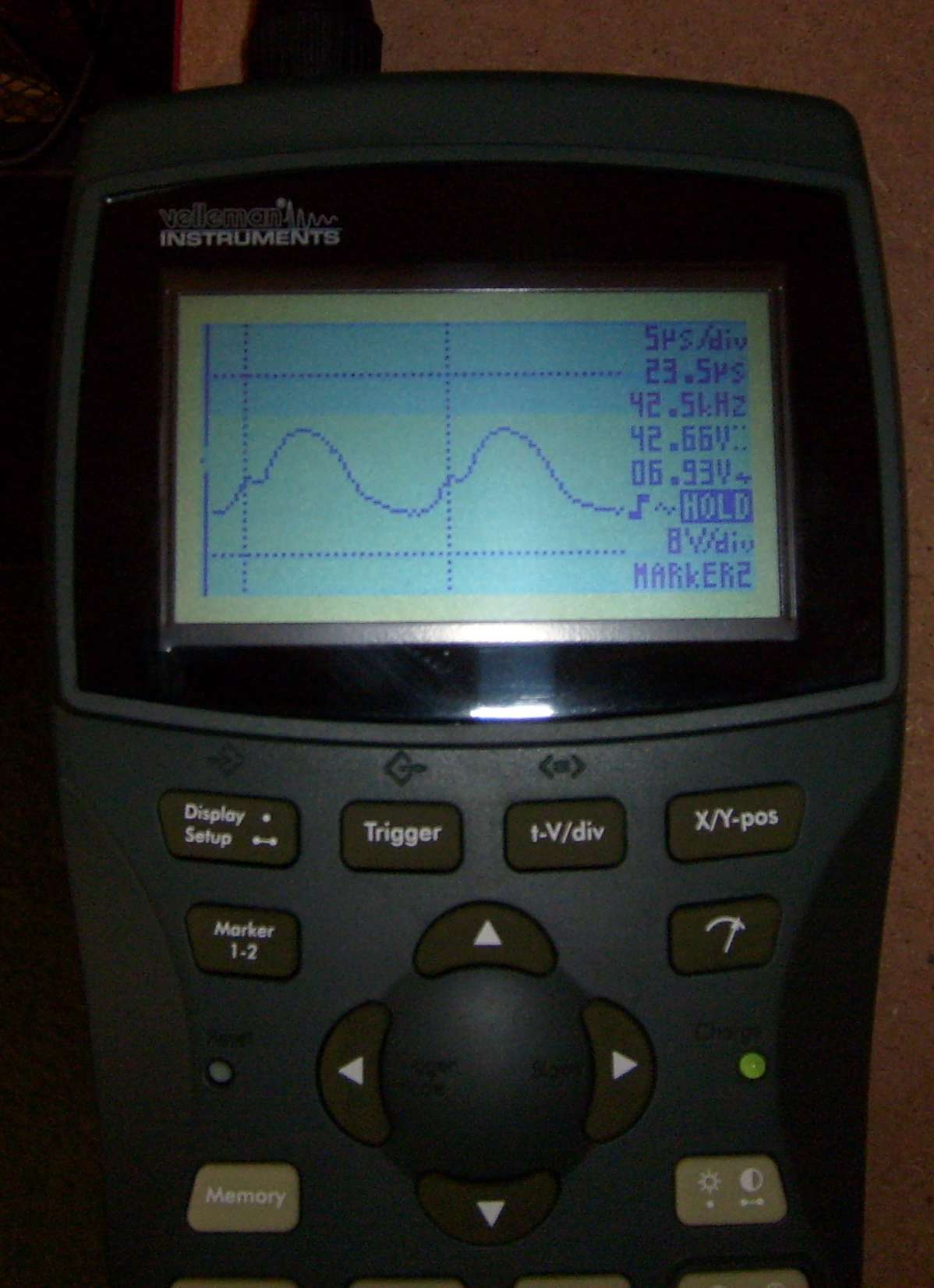

Success!
Today i have had the circuit oscillating in line with what it should be. So i'm happy :D
I haven't changed anything on the breadboard from yesterday. I made sure C6 and everything else was connected properly.

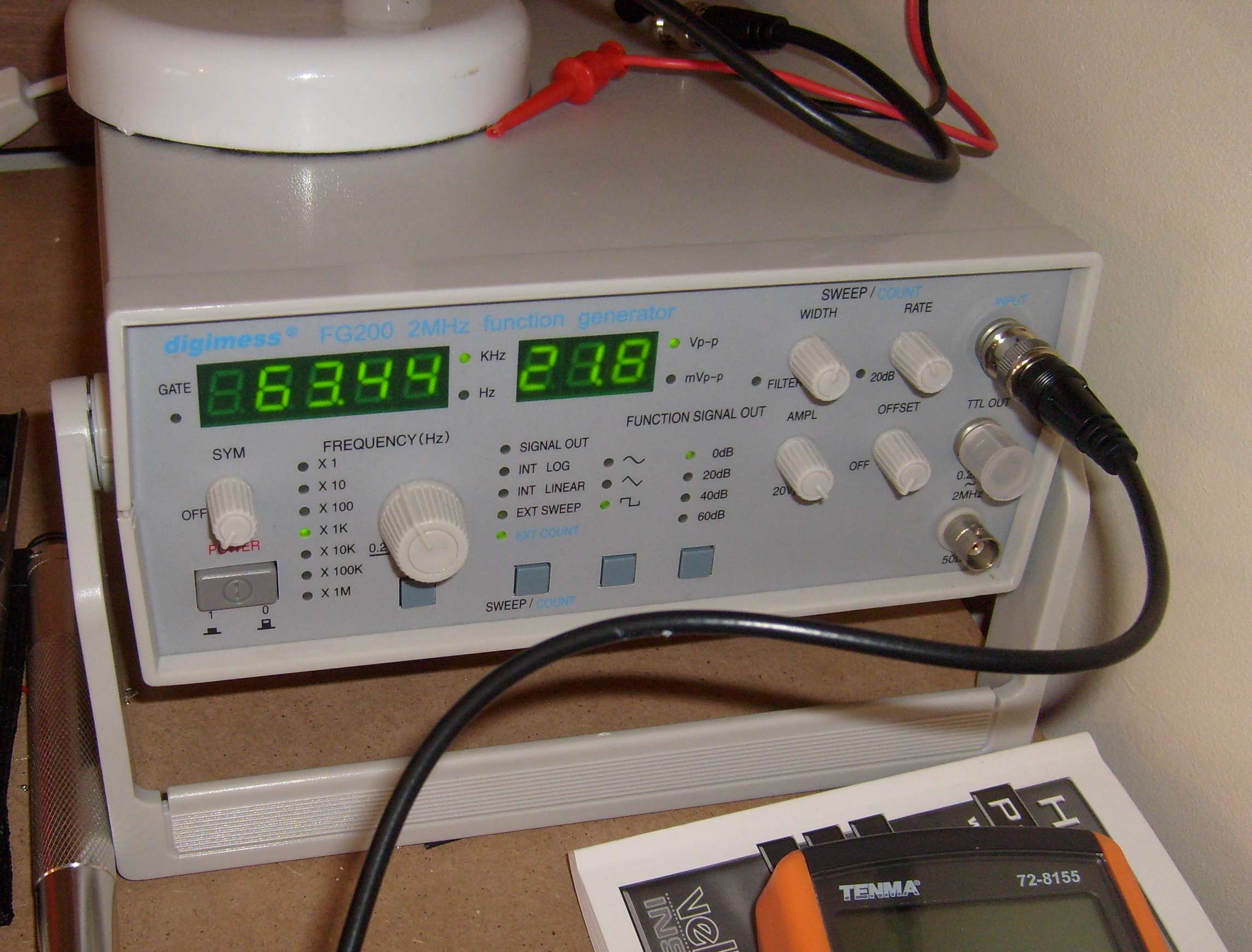

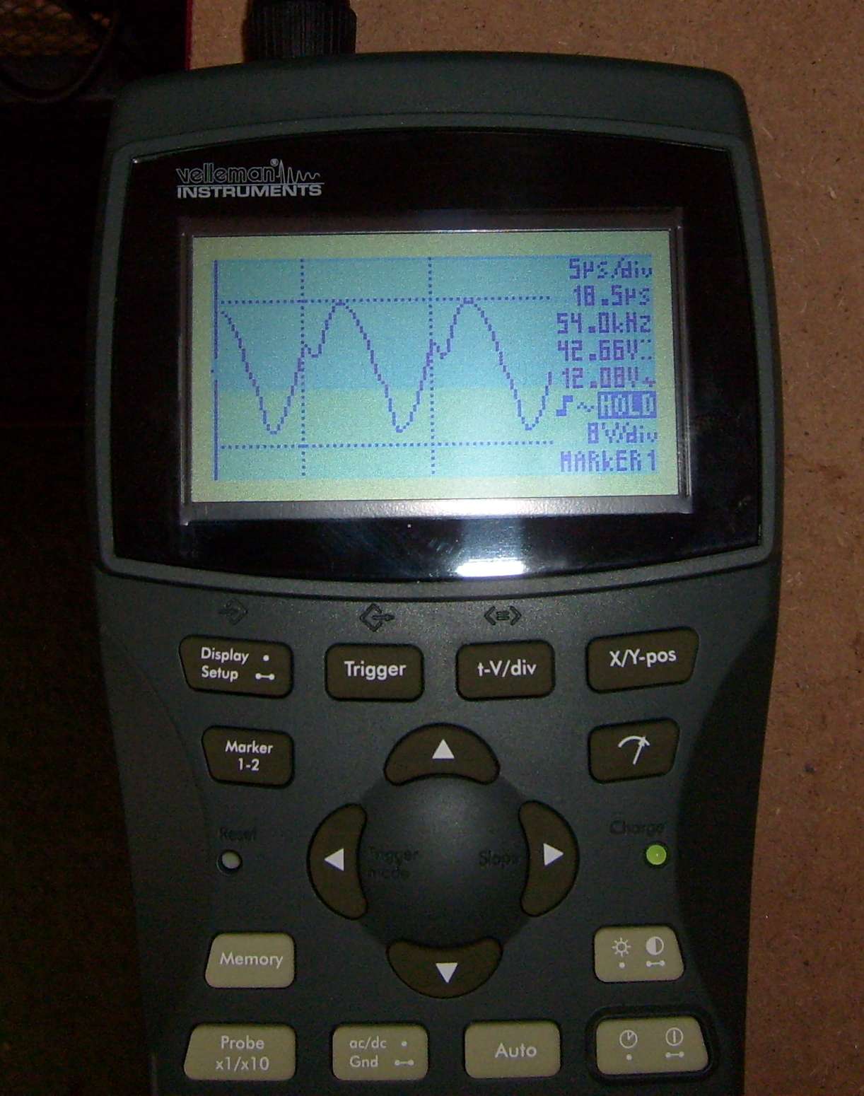

The oscilloscope measures two different frequencies. Perhaps one is the tank frequency, I'm not sure.
The first is 54KHz at 40V peak to peak and the second is 42KHz at 20V peak to peak. I also measured the frequency with my signal generator, this came in at 63.5KHz. I was aiming for 130KHz and scaled the components accordingly.

Hi Antknee,
For now, cold snowy weather here on the east coast of US as well.
To your circuit: nice job with component values. The L1-C6 tank in the source of the 42Khz signal. The piezo isn't ringing though. Since the reactance of your piezo at resonance is <50 ohms and the original piezo ~2 ohms, I think your feedback current is too low to get the piezo to oscillate. Try increasing R15 to about 50 ohms to match the the piezo. Here is where parts swapping is useful. Again, keeping reactance/resistance ratios the same as the original, change C5 for a reactance at 130Khz of about 100 ohms (12nF). Make these changes stepwise noting the effect. Try R15 = 0, increase C6 to lower it's reactance, etc.
Increasing the start up to be closer to 130Khz would be helpful as well. 42Khz is about 32% of target while the original was 700/1666 = 42% (I measured about 800Khz or closer to 50% of target).
Increase base bias by decreasing R13 (currently 1K, drop to 330) or by decreasing the other bias resistors (R9, R10, VR).

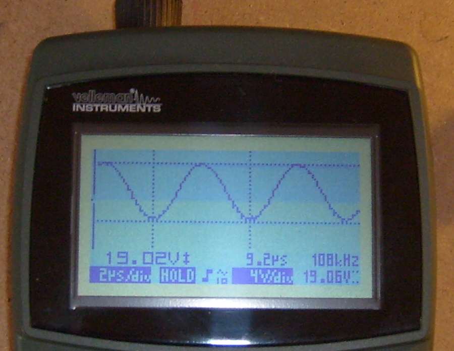

I did it! * Big grin * :D
It oscillates at 108KHz with 200V peak to peak and even atomises. I'm so chuffed!
The original circuit worked with R15 at 100ohm and C5 at 200 ohm impedance. I had to try it a few times more.
The tank frequency of 42KHz is L1 at 750uH and C6 (18.2nF) in parallel with the piezo combo (0.9nF).
The resonant frequency is C6 + piezo combo (19.1nF) with L3 (43uH) + implied inductance of piezo (70uH). The implied inductance looks too high and the resistor in parallel with the piezo would have dragged down the frequency, I will come back to this.

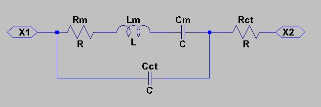

nice sine wave... looks like resonance to me...
it would be difficult to actually find the values of the "implied" inductance and capacitance of the series resonant circuit that is "seen" by the oscillator. these two values are electrical equivalents of the physical characteristics of the crystal. the 0.9nf you measure across the crystal is the actual contact capacitance, and is the parallel capacitor in the equivalent circuit of a crystal which looks something like this:
Rm, Lm, and Cm are characteristics determined by mechanical parameters of the crystal, and are the series resonant portion of the crystal. Rct and Cct are the contact resistance and capacitance. when you measure the capacitance of the crystal (assuming you are far from the resonant frequency when you do so), you are measuring Cct. Cct lowers the resonant frequency, but usually not by much.

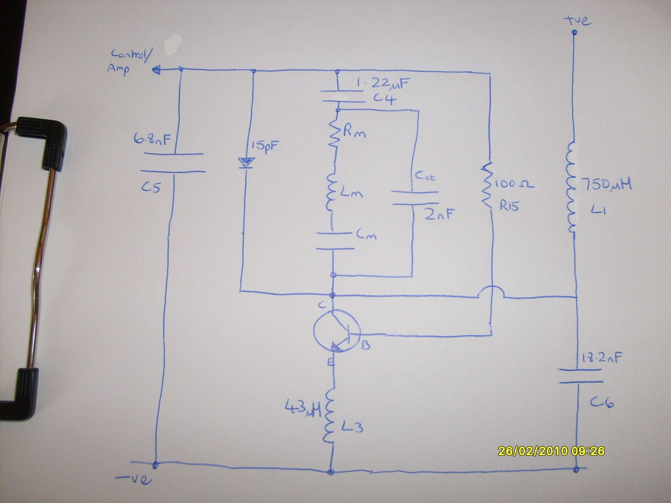

I'm finding the resonances hard to understand. I've uploaded a schematic of the circuit I have, the values have been checked and the frequencies are reproduceable. The tank frequency is 42KHz and the resonant frequency 108KHz. The piezo came with a datasheet, it notes resonance at 133KHz, impedance of 100 ohms and a Cct of 2nF.
I'm trying to understand how to calculate the tank and resonant frequency. Post #49 of this thread gives an indication.
I calculated the tank circuit frequency as:
The series combination of Cct (2nF), C4 (1.22uF), C5 (6.8nF) = 0.9nF
To this I added C6 in parallel = 18.2nF + 0.9nF = 19.1nF
L3 (750uH) x 19.1nF = 42KHz
To calculate the resonanct frequency of the board:
L3 (43uH) + implied inductance (70uH) = 113uH
19.1nF x 113uH = 108KHz.
Regards,
Antknee.
reducing C4 will raise the resonant frequency.
