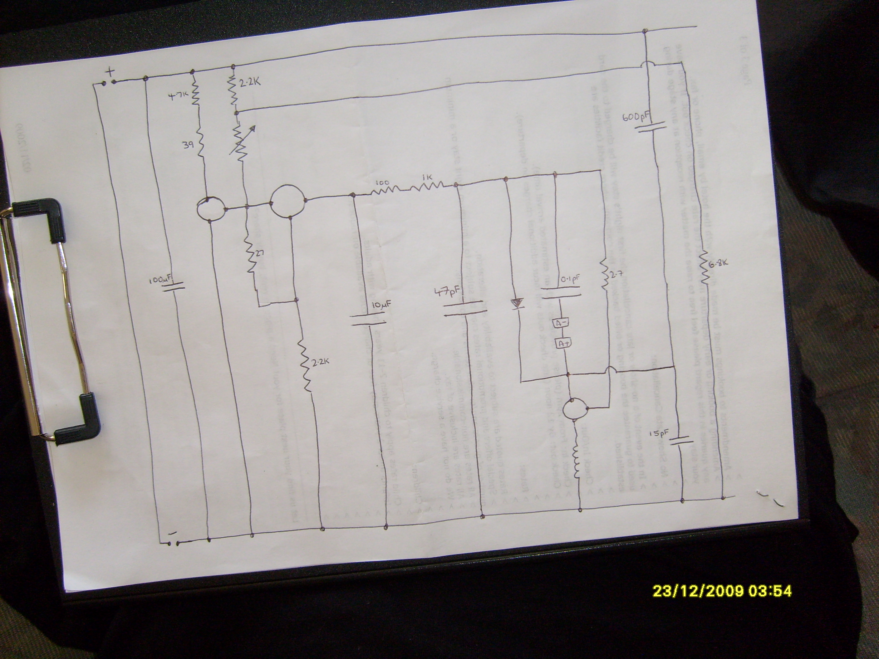

I have a humidifier circuit board which I wish to adapt for use for use at a different frequency. Currently the circuit operates at 1.6MHz and I wish it to operate at 100KHz. The atomiser, which is mechanical and essentially bubbles off the water, has an equivalent circuit which is LCR in series with a shunt/static capacitance in parallel. So to 'neutralise' this affect and ensure power is delivered correctly the accepted practise is to shunt the atomiser with an inductance either in series or parallel.
Now the resonant frequency (1.66MHz) is determined by F=1/(2Π√(LC)). So I should be able to replace either L or C with a variable component and essentially tune the frequency down to 100KHz.
My question is this - which component do you think it would be best to replace?
I've done some electronics in the past but I wouldn't describe myself as skilled in this field.
I have mapped the circuit board in a picture at the link below. A+ and A- represent the atomiser. There are two inductors, one is marked up like its a resistor at 100ohms. It is an inductor at 100µH (my mistake). There are quite a few capacitors, of those I wouldn't know which was best to replace.
Thanks. I'll reply promptly to thoughts and I hope it's not too difficult a question.

Antknee, your circuit does not make any sense, I suggest that there are numerous errors in there.
As Nigel commented, I would expect that the atomiser element is designed to work at a fixed frequency, in this case 1.6Mhz.
Trying to operate it at 100khz sounds like a poor idea, why do you want to do this?
The piezoelectric transducer has a mechanical resonance at 1.6 MHz. Driving it with a different frequency will probably accomplish nothing, even if the circuit is resonant at the new frequency.
Would be a lot easier to validate the schematic if it had the component designators on it. The B C E notatons for the transistor leads would be especially helpful. While you're at it, please mark the blue and yellow transducer wires. (Where is the transducer on your schematic?)
Also, post a data sheet for the new 100kHz transducer so we know the impedance that you're matching to.

It looks like I'll have to print your schematic and add my own component designators (R, C, Q, etc). Then I can trace the board and try to understand the circuit and how to modify it. Maybe in a day or two....
A few problems......
The capacitor in series with the yellow wire CANNOT be 0.1pF.
Is the capacitor from the collector of Q4 to ground (green disc) really 10uF?
The capacitor from the big transistor C to V+ is electrolytic. Recheck, it isn't 600pF.
There are terminals labeled "SW". Is it a switch? What does it do, if anything?
What does the rheostat "VR" control? Power or frequency?
I can read the markings on the big transistor, I need the markings on Q3 and Q4.
What are the R designators of the:
2.2K near R11 (it might be R12)
2.2K near C1
1K near L2
The C designators andmarkings on:
Black tube near R15
Green disc near Q4
Orange drop near L2
Burgundy drop next to the blue wire
What are the markings on C6?
I'll bet that the round device next to C6 and R15 is an inductor! It's 600pF on your schematic. It's probably in fact 60uH.
I've taken a pick of Q6 the capacitor in series with the yellow wire, it says .1K
Please explain. I do not find a device named Q6 in series with the yellow wire. All that I can see is a capacitor. It is 0.1uF, and appears to be C4.
L1 on your schematic is still a 600pF capacitor.
The photo of C6 is the unmarked side. What are the markings?
What are the markings on the face of Q2?
What are the markings on the face of Q3?
Please, attention to detail is important.
