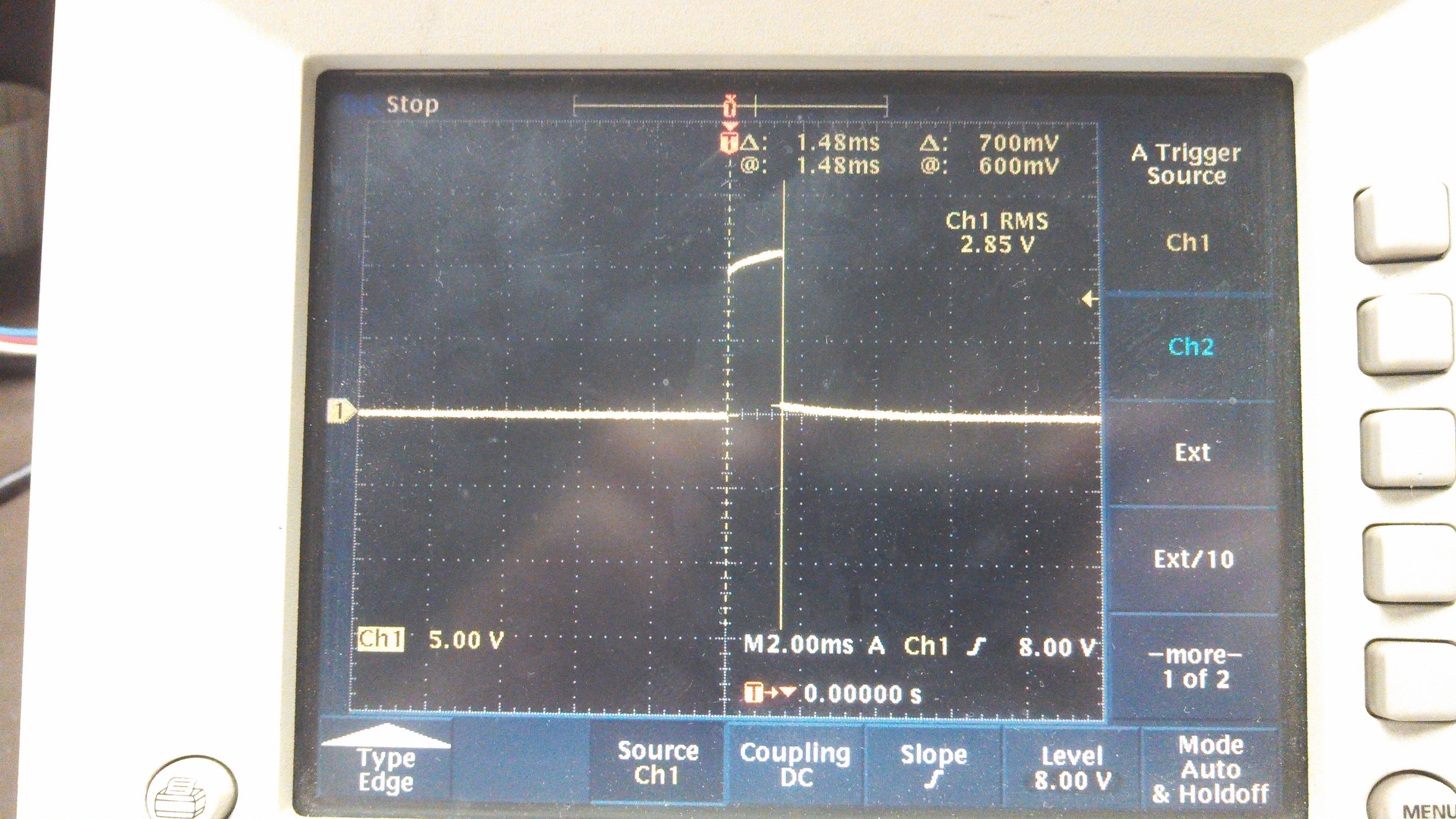

TTL waveshaping, RC networks

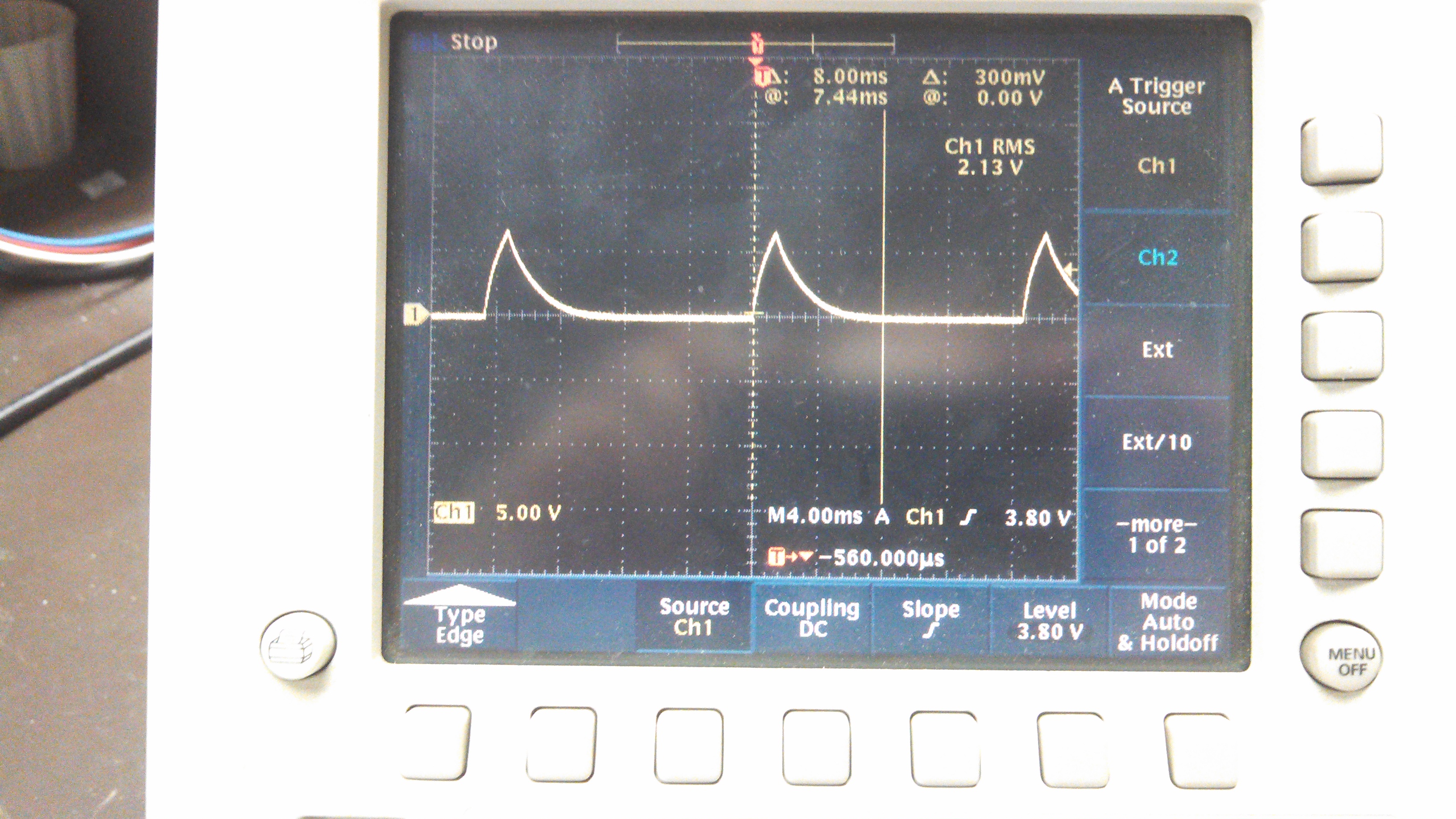

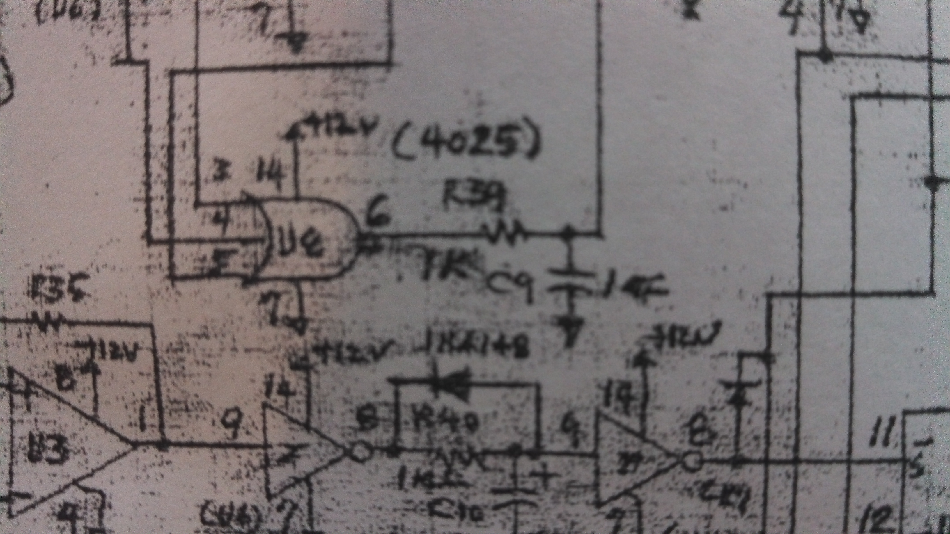

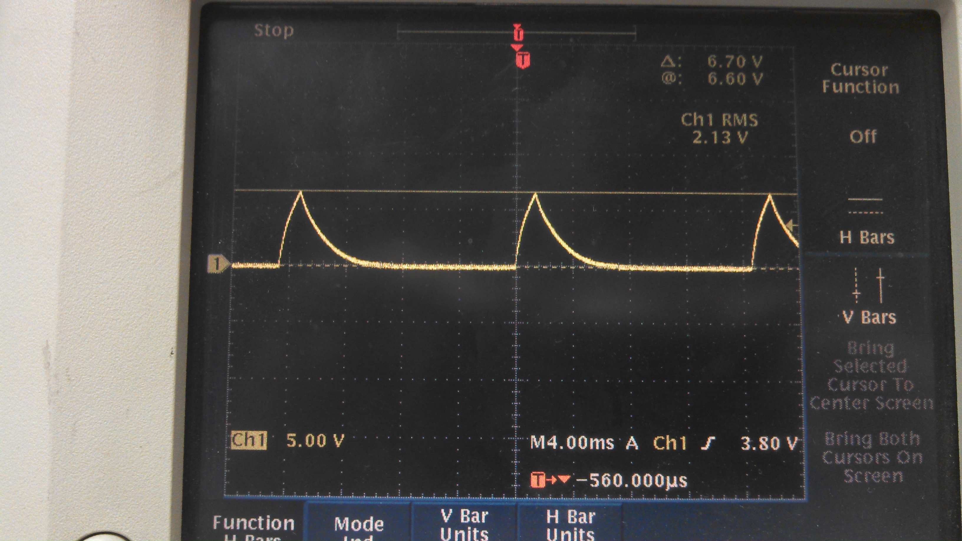

The output of U8 , 3 input pin NOR GATE , Pin#6
The output of U8 pin#6 , the shark fin waveshape goes to U10 pin#6 SET input
Why is the waveshape a sharks fin? the RC network changed the waveshape from a square waveform to a shark fin
But why was this waveshape used?

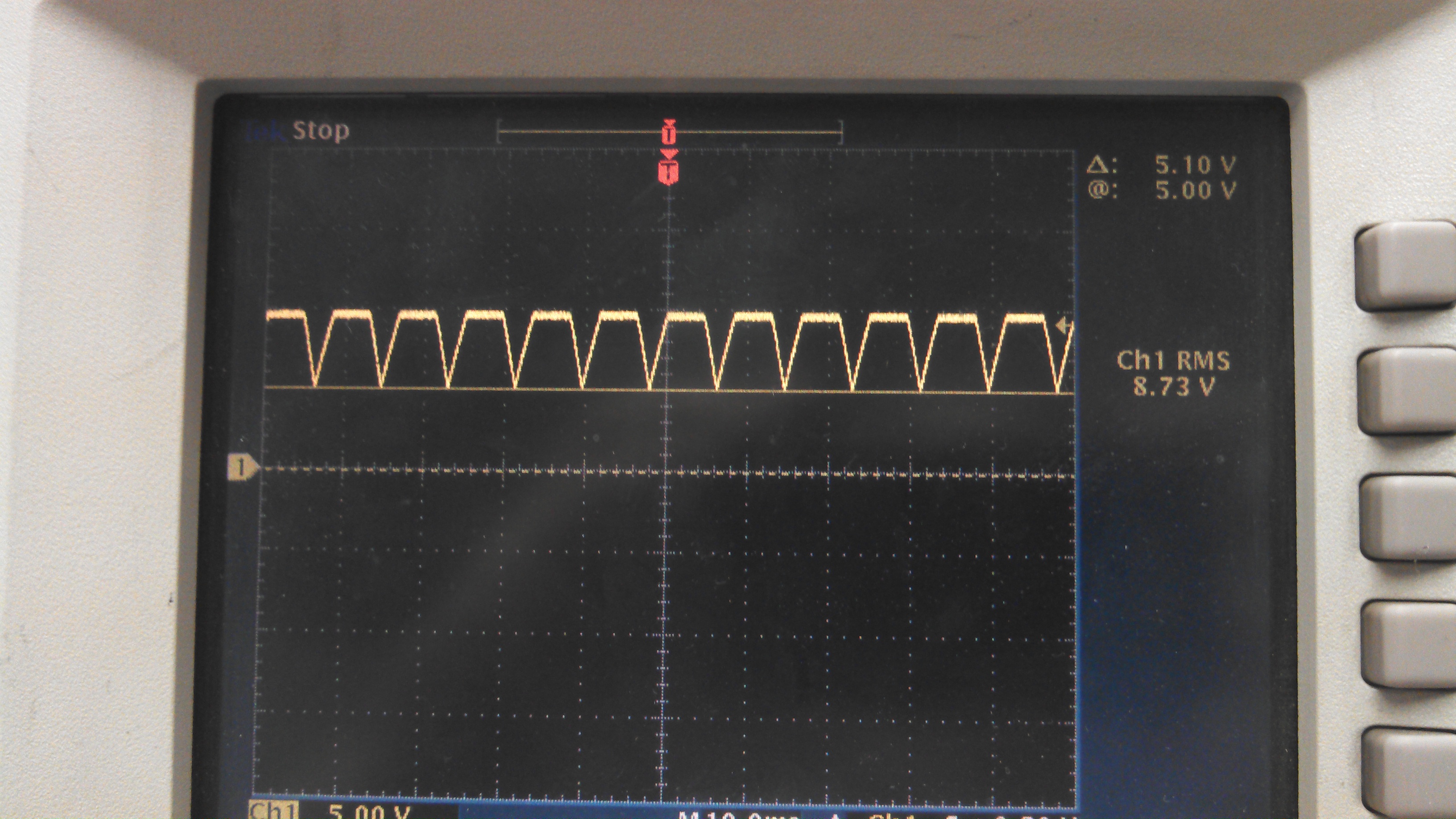

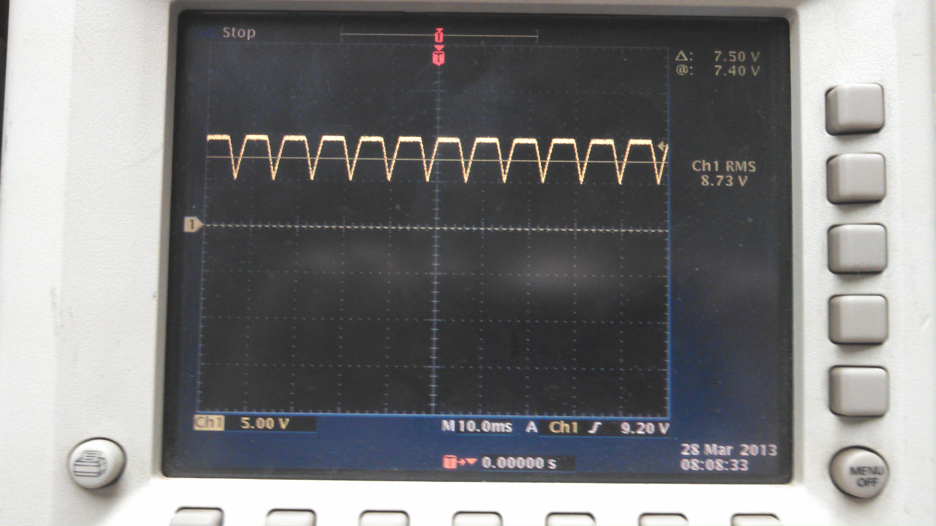

Look at this rectified waveform on U5 output pin#1
Is the DC offset at 5 volts?
Or is the DC offset at 7.5 volts?
First waveform is 1.48mS
Second waveform is the shark fin is 8msec.
Do you know why the time delay was used? for what reason?
Does the waveshape trigger the flip flop differently than a square waveform?
when using different triangle waveshapes for the inputs to logic gates or flip flops, what does it do different than using square waveforms/pulses waveshapes?
1.) It gives you less ON time and a exponential decay OFF time
But what does that do to the logic?
Why would the logic signal source need to have a time delay RC network or a waveshaped to be triangle or shark fin to the inputs of a GATE or flip flop, etc?
Do you know why the time delay was used? for what reason?Does the waveshape trigger the flip flop differently than a square waveform?Why would the logic signal source need to have a time delay RC network or a waveshaped to be triangle or shark fin to the inputs of a GATE or flip flop, etc?

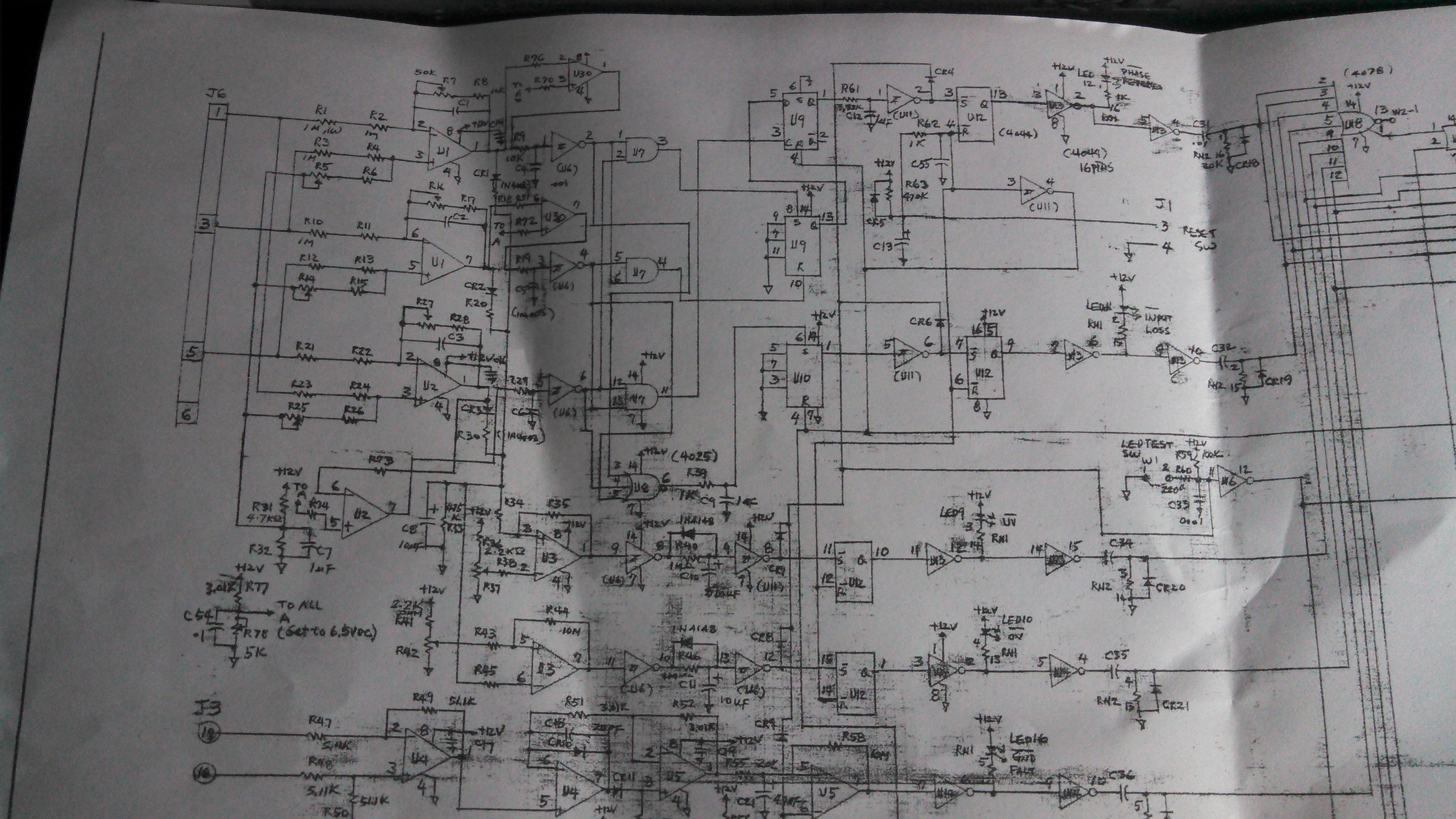

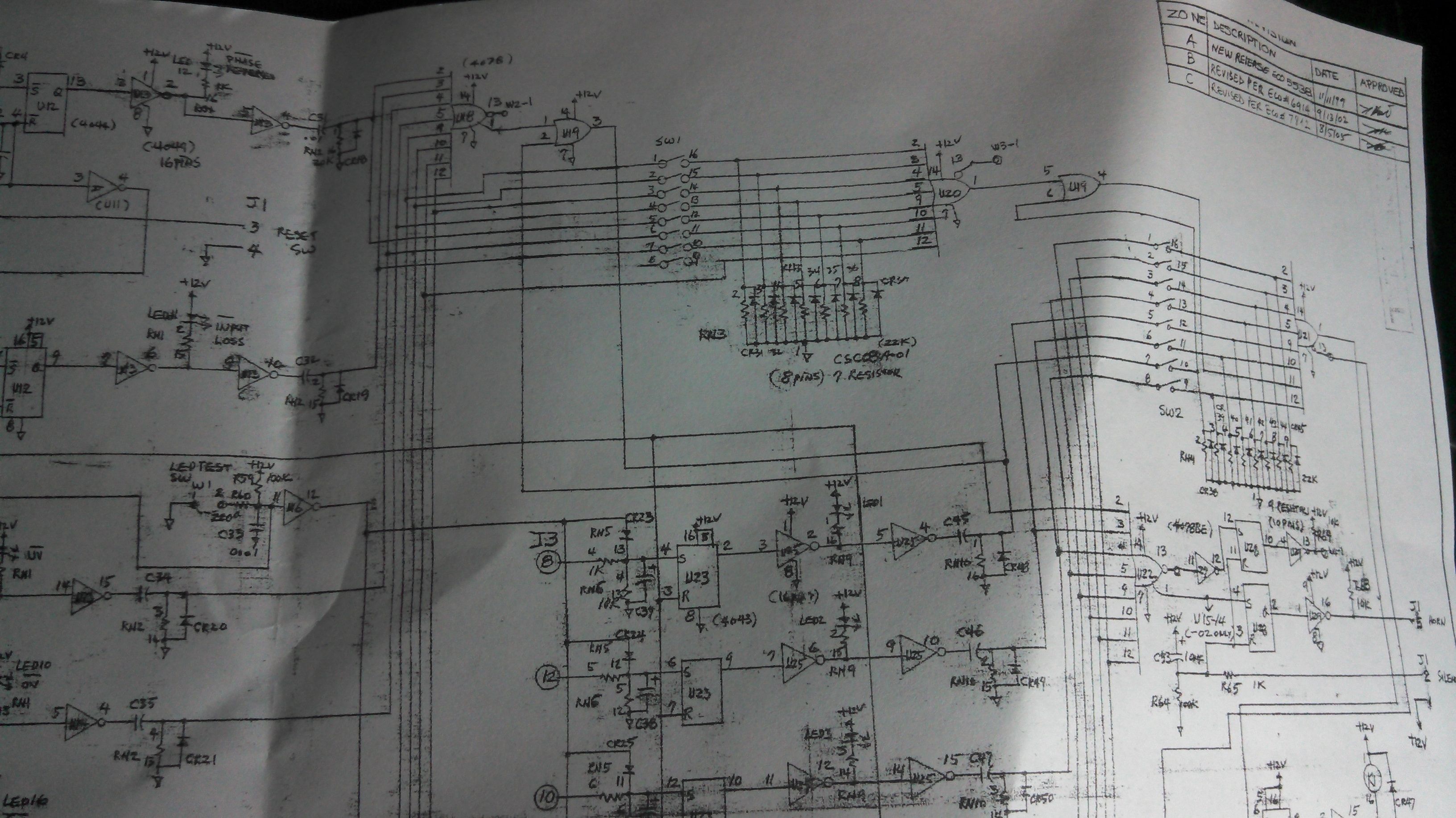

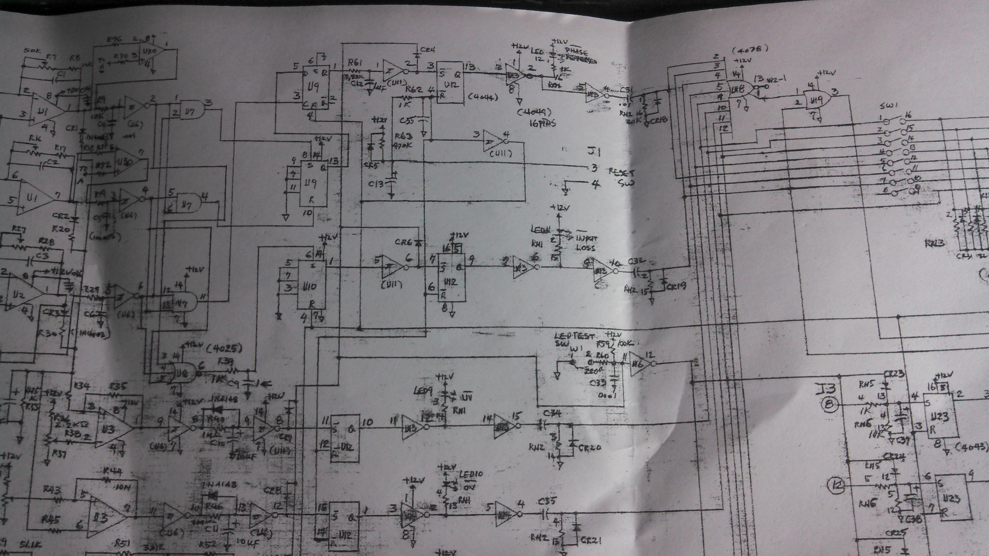

We need to see the rest of the circuit to answer those questions.
Ok it looks like that circuit monitors a 3 phase power line. The outputs of the phase detectors are OR'd together in the 4025 NOR gate. If any phase is lost the output of the 4025 sets a latch to indicate the loss. The RC network delays the pulse to set the latch, this is probably so it is not triggered by short power fluctuations. The latch will trigger at a specific voltage level on the input, the ramp (shark fin) waveform just delays the voltage change on the input pin so it triggers a bit later.
Looks to me like that section detects a loss of all phases. If we look at U10 the Set input takes a logical high as true, so that means the three input 'NOR' gate actually functions as a negative logic 'NAND' gate. That condition will light the LED.
But as far as the RC network, i agree it is probably there to prevent very short transitions or noise from setting the FF and thus turning on the error LED.
BTW those jpg files do not have to be that large to be clearly readable. A max of 2000 pixels of either dimension (width or height) is good enough. Bigger files take too long to download even on a fast connection because the site limits the transfer rate.
What do you mean how a NOR gate is functioned like a negative logic NAND gate, how so ? and why did the designer do this? Instead of using a NAND gate, because he used a NOR gate, why didn't the designer just use a NAND gate?

It appears that if that section is working right the LED will light when you loose all three input phases. You can try testing for that if possible. To check the actual RC network you'd have to use a scope or pull one lead of each device (being careful not to wreck the component) and check the resistor with an ohm meter and the cap with a cap meter. Alternately buy those two parts, check them, then replace them on the board regardless if you suspect them.
