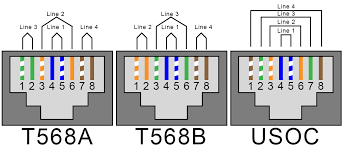

Why? For two lines, it matches the USOC assignments.
I think the reason why the pairs are so close is because the USOC 1 & 8 are too far apart.

Functionally, using 568A or 568B makes absolutely no difference at all, as long as both ends are the same. Electrically they are identical.
The only thing that matters is consistency, so you don't forget what you used if you need to reconnect anything...
Virtually everything now uses 568B colour code, so sticking with that keeps things consistent.
The reason the two inner pairs is like that is that originally only two pairs were allocated for Ethernet, for 10BaseT then 100Base T.
Pins 4 & 5 were used for a spare pair, left free to allow the same wiring to be used for telephones. An RJ11 plug fits the same socket and connect the centre pair as a phone line.
The idea was it could be unified wiring system, with each installed cable used for either data or voice depending how it was patched, or both with passive splitters.
Just be sure if somebody is helping you install connectors, you both agree on which standard to follow. One of our installations was seriously delayed when every cable had the ends wired in the opposite standard. One guy did one end, the other guy the other end.

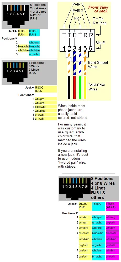

Sort of. Until I re-wire/wire the system, I'll have some quad stubs that will need to connect to an RJ45 patch panel.
Any totally re-wired or new phone jack will be CAT6 and RJ45 with an insert making it a 6P6C jack at the equipment end.
There will be an 1RU RJ45 Patch panel wired in parallel for telco patching.

Looks like 568A is the way I will go because of telco connection. I don't anticipate more than one line. There is a gazillio locatiions in the house. The system is basically now a 4 station cordless phone system. Had to have speakerphone and had to have touch tome. There is a UPS on the cordless base station and the phones can work about 12hrs or more on standby.

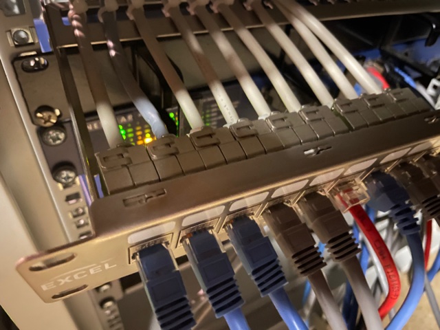

It looks like one of the better ways to do patch panels is with Keystone connectors. They would be easier to wire in my case.
The Siemon Z-max connectors seem really cool. They can be purchased for D openings and their proprietary openings.

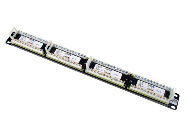

I'm using a 48 port patch panel that uses these
punch downs.
This

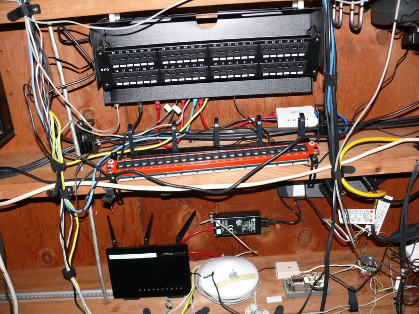

is my patch panel. The patch panel rotates with stops for access to the back.
Currently, above the patch panel is a bunch of RJ45's. They are plugged directly into two small switches. One is a 5 port gigabit switch, the other a hub. They are on a shelf.
Red would be parallel RJ45's for telco. There is a router mounted on DIN rail. Near the router attached to the red wire is a POE device that powers a DSL modem elsewhere.
On the lower right hand corner, grey box,
there is a bunch of telco wires. The white covered box is telco and just under it is a stand-alone bell.

You might want to add a cable management panel to help with the routing of cables..
This
Wow...you need to clean that up... :)
Remember, that "mess" is in the ceiling. That is cleaned up.
There is a QNAP server in the ceiling too. Plan is to put a 1 RU 24 port switch accessable to the patch panel. Cables are secured using velcro ties with a hole that mounts them.
I really like using DIN rail to mount stuff. I found out the hard way that you he to have the DIN rail about 1/8" off the wood. If there is a leak (bathroom is nearby), water will follow the channel formed by the top of the rail and he wood.
The white dome is an Apple snow airport. My initial network was a dial-up wireless internet. I got free dial-up. Because runnning cable was difficult to the modem, I used powerline Ethenet on the WAN port to reach the modem. The wireless Access point is where it needs to be (In the center of the house in the basement)
Unfortunately, I needed a repeater (This was 802.11b) to reach the living room. Line of sight is severely attenuated. The repeater was placed about 10 feet from where the laptop normally was used. Getting outside on the swing or porch was impossible without the repeater. The earth and a shed severely attenuated the signal. The repeater has clear access to the porch through a window about 20 feet away.
My power line over Ethernet was a Neverwire unit. It was reliable when it worked, but it died twice. Repairable under warranty once.
Since I modem upgrade, I realized the importance of DIN rail. I don;t have any near the NID. I generally have two modems availabe.One I use and is configured in bridge mode. The other is configured standalone. when it's time to troubleshoot with y ISP, I need to be standalone and direct connected. I put a jack near the washer, so I'm not plugging into the ceiling. I did too much damage causing the laptop to fall 3 feet when I had to plug an RJ45 into the ceiling mounted modem.
I have a 3-port RS232 controlled RJ45 AB switch made by Electrostandards that is certified to gigabit speeds. "Planss" are to use one port to switch t the DSL line and another to switch the Ethernet so I can electrically swap the modems. I might wire a direct port to my bedroom. If I do it by wireless, I'll need a repeater.
