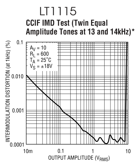

Some purists who can detect very small amounts of IMD will say that there isn't much high frequency gain left in Op Amps used for high gain, so the feedback gain is quite low and the IMD is much higher than the typical 1kHz THD test would suggest. YOu would need a number of frequencies above 10 kHz to cause this low frequency aliasing or Intermodulation Distortion. However my ears are already adjusted to the distortion in music and compress distortion on radio. But dearly miss my Bogan tube stereo amp and large single stage 12" Phillips speaker with tuned ducts in 4cm walls of compressed particle board for the acuity of imaging of all sources of sound in stereo or quad. It wasn't the best but it sounded like live music.
But then for low gain (x10), this Op Amp looks pretty impressive, which is pretty hard but not impossible to do with discrete BJT's, but very easy to do with low noise vacuum tube pre-amps and with much more gain.

...But then for low gain (x10), this Op Amp [LT1115] looks pretty impressive, which is pretty hard but not impossible to do with discrete BJT's, but very easy to do with low noise vacuum tube pre-amps and with much more gain. ...
Hell, didn'know about that beauty.
... very easy to do with low noise vacuum tube pre-amps and with much more gain. ...
'very easy' for you maybe!
Didn't know about low noise in tubes either. Thinking about it though, the front end video amps on the older RADAR systems used low noise tubes and they worked very well.

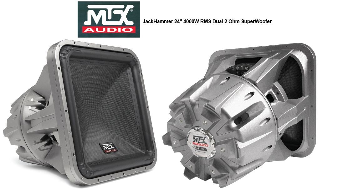

I had a car that came with 2 ohm speakers on the rear shelf and its 10" subwoofer had its amplifier with a voltage stepup power supply.
Look at these car subwoofers:

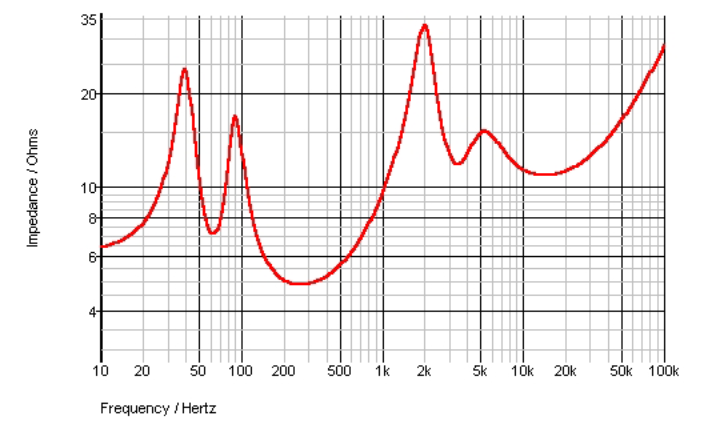

As the other members say, the speaker impedance is designed to match the amplifier V/I characteristics. 15 Ohms was used in the valve days for hi-end amps because it was the best compromise between the output transformer design and speaker coil design. As far as the speaker coil is concerned, 3 Ohm is the best. That is why it was the standard for years- it uses a small number of turns with relatively thick wire which is more rugged, cheaper to manufacture, and better for heat dissipation. Why 15 Ohms then? It's because of the output transformer. The higher the turns ratio the harder it is to get a good performance. 15 Ohms is also better for distributed speaker systems as it has 0.2 the current of a 3 Ohm system for a given power, thus the resistive losses are lower- just like the mains power grid. For weedy amps, like in the early battery-powered transistor radios for example, speaker impedances as high as 300 Ohms were used.
Since the 1970s the trend has been towards 8 Ohms to match the V/I characteristics of solid state amps. In general 3 Ohms allows more power from a solid-state amp because, to a first order approximation, it is easier to provide more current than more voltage.
By the way, the stated impedance of a loudspeaker is only nominal. If you measure the resistance of an 8 Ohm speaker with a multimeter, it is likely to read around 7 Ohms, but this changes, sometimes radically, through the audio frequency spectrum, and some 8 Ohm speakers, with cross-overs, can drop to as low as 2 Ohms, particularly at bass resonance and the cross-over point of 300Hz to 3.5KHz.
4 Ohm, 8 Ohm, 15 Ohm make no difference to the audio quality of a speaker. In fact, it is not uncommon to see the same speaker chassis available in all three impedances.
