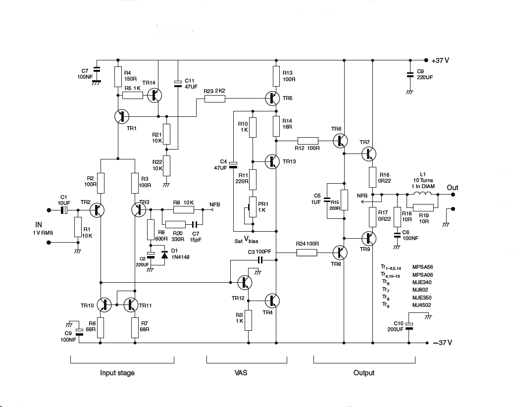

...Can anyone post a 3055-2955 40w amplifer circuit? I found a good circuit but it's 60w on 4ohm load and 40w on 8ohm load...

Hi Nikolai,
I have put the amp circuit in post 162 by itself so that we can refer to it simply, as APA162.
It is a simple, very good amp.
Treat it as a model for you to work on. Don't worry about the power line voltages or transistor types. They can be changed to suit what you want.
So far your requirements are 40W into 8 Ohms and 2N3055/MJ2955 output transistors. The next thing is to know what other transistors you want to use.
Once you give that. I will let you know where to go from there.
In the mean-time, you could start assembling the other components and even start building without risk.
Notice that APA162 is divided into three stages: Input Stage, Voltage Amplification Stage (VAS), and Output Stage. This is more or less standard. The way that the three stages are designed has been proven many times to give excellent fidelity: high current output, low distortion, high slew rate, wide frequency reponse, good frequency stability. It was designed by Douglas Self*, one of the best audio amp designers in the world.
Once you get the layout and power supplies sorted out you will have an ideal facility for future improvements. The first thing would be to use the output power transistors that I reccommended in post 126 (MJL3281A_MJL1302A).
If you have any questions please ask.
* Audio Power Amplifier Design by Douglas Self, Sixth Edition, Page 382, Published by Focal Press.

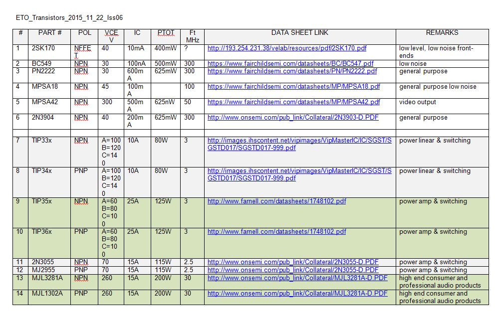

I want to use 2n3055 on output stage but, I can't find 2955, I have call to stores but no stores have MJ2955 or sth. 2955. May I have to use TIP34-35 or some other complementaries? Or use only 2n3055?
I small signal transistor low noise is available, BC549 and PN2222. MPSA18 MPSA42 2SK170
Hi Nikolai,
I have been meaning to ask about your component buying situation. Where can you get components from? Can't you buy by mail order from RS, Farnell Mouser, Rapid etc? Please let me know, not only because it would be interesting, but also it would also help to understand what the component selection constraints are- I don't mean to pry into your affairs.
I will have a look at TIP33C_TIP34C & TIP35C_TIP36C. Take note of the 'C' on the end of the part number- that is very important.
I will also have a look at the other transistors that you mention and get back.
