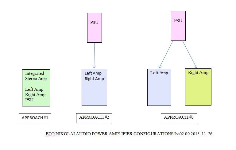

Some questions for you. The answers will save me a lot of time:
(1) Are you going for just 1 class A stereo audio power amplifier, 40W into 8 Ohms (will drive 4 Ohms too)?
(2) Do you want a single power rail or + and - supply rails?
(3) In the attached block diagram below, which approach would you like (Approach 1 would be possible but it would mean a big case. Approach 3 is the best)?
Here are my answers:
(1) I want make 2x20W class A to drive 2 speakers to make satellite systems
AND 4oW class A or AB to drive subwoofer
=> I need total 3 amp circuit , two 20W and one 40W
(2) Single rail make the circuit smaller, easier and safer but you can choose any will be best for audio quality
(3) yes the Approach 3 is the best, I can easy fix the problem or arrange circuit more compact
Thanks Nikolia,
That is a great help.
In view of your information this is what I propose:
(1) Approach 3
(2) Split power supply rails. (my calculations show +- 30V @ 1.58A each amp. Must be stabilised. Calculations are only notional at the moment till checked fully)
(3) Three amps all the same ie 40W into 8 Ohm Class A (you can make any power lower simply by reducing the supply line voltage)
(4) It looks like only 2 of 2N3055s per amp will manage but it will be close. Again calcs not checked.
(5) It looks like the heatsink requirements are not as demanding as I thought.
(6) I suggest that the power transistors be mounted onto a block of ally without insulating washers. The ally block would then be bolted to the heatsink with an insulating mica sheet between it and the heatsink. Ally block say, 70mm x 70mm x 10mm. You say you have cast copper. That would be even better but not essential.

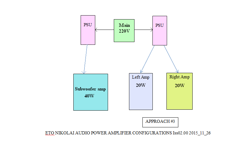

Power supply options
(1) One single power supply for all three amps. all in same case.
(2) One power supply for sub and one power supply for the two amps all in the same case
(3) One power supply for sub, One for left, & one for right, all in the same case.
(4) One supply for sub in own case. One single power supply for left and right in separate case.
(5) One supply for sub in own case. One power supply for left, one supply for right in same case.
In terms of performance and flexibility I would suggest that (5) above would be the best all round, but in terms of quality (3) is just as good.
I will work on (5) for now uuntil you tell me which way you want to go.
Where the supplies are in the same case, wether independent or not, there is no reason why a single transformer cannot be used. You will need a separate pair of winding on the transformer secondary for each supply.
Components for each power supply (assuming split rails)
This is notional at the moment but I give it to you so you will get an idea of what is likely
(1) 2 of transformer winding 28V RMS (to be defined exactly) 3A rating or above.
(2) 2 of bridge rec 10A or above
(3) 4 of 10mF or above caps 50V or above
(4) 2 off 2N3055 (this may change)
(5) 10 100nF or above ceramic capacitors 50V or above
Transformer
Each supply, (comprising +-rails) requires: 28V x 3A x 2=168W. (this is not the power used by an amp, which is 94W)
From that you can calulate the power of the transformer
For the sub it would be 168W up
For the two amps it would be 336W up
I think microwave transformers are around 1Kw but not sure. If so one transformer supplying all three PSUs in one case would be good.
Thank you, (5) will be best, before you post, I calculated the supply +-35V and 2A :p
I think I will wind 2 primary coils, microwave oven must >1000W if no it doesn't effect.
Mica insulator for to-3 case are availlable. I have draw the supply circuit 1 week ago, I will post tomorrow.

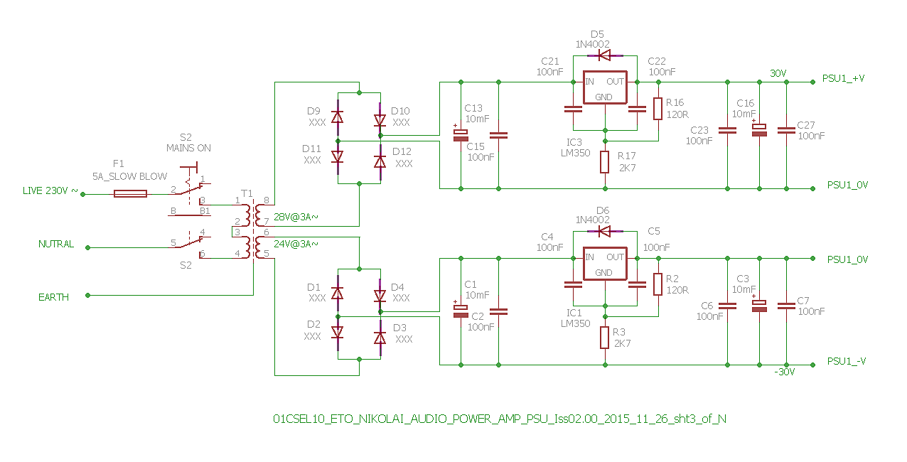

Hi Nikolia,
First rush of amp PSU below.
Is the LM350 a problem for for you . If so what voltage regulator can you get, if any?

Hi Nikolai,
Our posts crossed. I just posted a PSU design for you to consider but if you have one sussed already that is fine. Just a couple of points though:
(1) my calculations show that for 40W @8 Ohms you need 3.16A peak. therefor the standing current in a class A amp will be 3.16A/2=1.58A
(2) from that you get the voltage= 3.16A * 8 Ohms =25.30V
(3) from that you get the supply rail voltage: allow 5V overhead (so the amp does not saturate) and you get 25.30V +5.00V= 30.30V. We are not going the fuss with 300mV so you get a round 30V. Thus the amp needs +- 30V rails, at a constant 1.58A.
(4) Each output transistor thus dissipates 30V * 1.58A= 47.4W, under static conditions.
(5) Knowing the maximum 2N3055 junction temerature of 200 deg C and the thermal resistance, juction/case, of 1.52 degC/W you can do the thermal budget to see if the 2N3055s can do the job. I recon with a heatsink of 0.92 degC/W or less it just will, but it will be tight.
I don't like to counter your good work but +-35V supply rails would be too much for 2N3055s: +-30 is max.
Sure mica washers are available for the TO3 case, but they introduce a thermal resistance of 0.7 DegC/W. If you do what I suggest and use an ally block you, could probably half that, which would give the transistor an easier time.
I don't fully understand what you are saying here. Two primary windings will not be necessary, unless you are thinking of providing a tap for operation on 110V US supplies. Can't you leave the primary of the transformer as is. Just unwind the secondaries and rewind with the secondaries that you want. The thicker the wire you can use the better.
With approach (5) you will need two independent 28V RMS windings on one transformer for the sub and for the two amps you will need four independent 28V RMS windings on another transformer. If the microwave transformer is 1KW, you will have a fine pair of PSUs.
I suspect that a 1kW microwave oven transformer might get very hot if operated continuously at only 600W because a microwave oven is not used long enough for it to get hot.
But these three amplifiers will not use anywhere near 600W so the transformer will be fine.
I never play my sound system continuously at full blast because I hate acid rock so my transformer can be de-rated.
