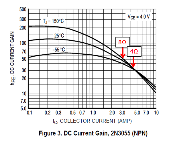

Without getting too deep, here is a graph showing current gain (hFE) against collector current for a 2N3055. The first red arrows show the hFE at an output current of 3A with an 8 Ohm load. The second arrow shows the same power output but with a 4 Ohm load (4.24A). Notice that the Hfe has dropped from 50 to around 36.
Using the 150 deg C line is reasonable because that is about the temperature that the junction would be after driving a load for a while. This drop in Hfe will add distortion in a number of ways, depending on the amplifier design, of course. What is not shown here, is the change in Vbe, and Vsat. The first introduces more distortion and the second reduces the maximum voltage that the amp can output into a 4 Ohm load.
Interestingly, you wouldn't want to use this transistor in an audiophile amp for any ICs over about 700mA peak, because the hFE drops off so fast. And the situation is even worse if you look at the worst-case hFE on the datasheet, which is only 20@ 4A
Compare that graph to the IC/hFE graph of an audiophile transistor, where the hFE is reasonably flat from 50mA to around 5A. The worst-case hFE for the 2N3055 is 20@ 4A but the worst-case hFE for the MJL3281A is 75@ 5A and still 45@ 8A. And if that is not enough the ft of the 2N3055 is 3MHz compared to the ft of 30MHz for the MJL3281A.
