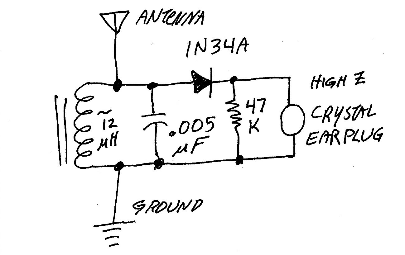

I also want to know can 1N4148 replace 1N34 in crystal radio. I can't find 1N34, no stores I asked have 1N34 or other germanium diode. ( I can make 300ft antenna and good ground for strong signal ) ( 1N4148 heated or red LED in series with 1,5v cell will be good idea??? )
No the 1N4148 will not replace a 1N34 or 1n34A. What makes the 1N34 different is the low forward voltage drop, on the order of .3vdc, the 4148 is around .6vdc. So for your crystal radio you would need a germanium. I don't know why you are having trouble finding the 1N34 diode. Using Google, this was the first link on my search results.

A heated 1N4148 diode will come down in forward voltage, but it takes maybe 100 degrees C to come down by maybe 0.25 volts bringing it down to maybe 0.35 volts.
You can also try biasing it with a little DC to help get the dynamic forward voltage down. It's hard to adjust though, maybe with a DC feed back circuit.
A red LED biased with 1.5v might come down to 0.2 volts but i've never tried that.
They also make fast low voltage Schottky diodes for small signal high frequency use.

Good luck with your escape, freedom awaits you :) Okay, I am just kidding. The whole idea for using the 1N34 diode was that you could build a powerless radio due to the .3 vR drop of the diode (I don't understand why the datasheets say 1v?). I built my first crystal radio when I was 10 and it worked. The trick was winding the antenna. I would just try and get the right diode, and if you still can't get it, then maybe you should escape, I hear the weather in Canada is lovely this time of the year:)
A diode has internal resistance so its forward voltage gradually increases as its current increases. The germanium diode I showed has a typical voltage of 1V at 10mA but is 0.35V at 1mA and is only 0.2V at 100uA.
The 1N4148 silicon diode typically is 0.73V at 10mA, 0.62V at 1mA, 0.5V at 100uA, 0.38V at 10uA and only 0.27V at 1uA.

The way he wants to try the 1N4148 diode is by heating it up first. An Si diode has a negative temperature coefficient so the hotter it gets the lower it's forward voltage becomes. He will have to heat it up quite a bit though.

Wow, pretty interesting thing I saw today! I never thought that the a diode's junction voltage drop (forward voltage) is depended to temperature in such GREAT way! First I connected a 1N4148 diode in a crystal radio and heated a lead of the diode with soldering iron almost 10 seconds. I got the the AM radio working after almost 5 seconds with small volume and got it increasing second by second. At last it was working same as 1N34 or any schottky diode. (However it's not a solution/alternative for crystal radio. To get the radio working the diode need to heat up in such bad way, the diode would not be able to survive more minutes.)
Another test is to measure its voltage drop by applying heat. I connected the diode in DMM's test probe and started to heat the lead of the diode. (I have no temperature meter.) I heated its one lead almost 45 seconds (I was thinking the diode is going to blast, but it's fine still). Voltage drop was 612mV at first and got around 250mV just after around 10 seconds of heating. Then decreasing voltage drop was not fast like till the 10 seconds. Around last seconds I got just 160mV hardly and I stopped heating (I do not want to waste parts actually). So nice part is to make temperature sensor! :)

The diode can probably take about 175 to 200 degrees C so maybe 150 deg C wouldnt be too bad, heated up slowly. The reverse leakage will also increase, from maybe 10na to 10ua (1000 fold). The forward voltage will also be less for lower forward currents. A general purpose tester probably puts out more current than when used in a radio.
Purposely changing the temperature higher and lower could act as a sort of squelch adjustment.

An old RED LED is 1.2V
An IR LED is 0.8V threshold
Silicon LED 0.5 to 0.6
Schottky diode 0.1V is best bet, Typical examples are the 1N5711 or BAT41.
