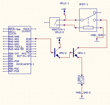

Hi, I need to know what the minimum base current required by a tip3055 is... the issue I have is that I want to create a circuit where there is 8 transistors, the base of each controlled by a pic, with the collector controlled by a relay... diagram below, showing just one of the transistors... i need it so i can set the transistor to open, without the fuse blowing, and then when the switch is pressed and the relay closed, the fuse will blow..
NPN1 is a TIP121
NPN2 is a TIP3055
and the fuse is a 100mA quick blow.
Cheers
Sam
PS - reason for usinf a 3055 is that eventually I need to be able to draw 10A through the circuit...

1) You forgot to look at the datasheet for the 2N3055 transistor.
Its max collector current is only 15A. The current is unlimited before the fuse will blow so instead the 2N3055 transistor will blow.
You need something to limit the current so it is less than 15A.
2) You forgot to look at the datasheet for the TIP121 darlington transistor.
Its max collector current is only 5A to 8A. The current is unlimited before the fuse will blow so it might blow before the 2N3055 transistor blows.
3) You forgot to look at the datasheet for the microcontroller. Its absolute max output current is 25mA and in this circuit it is unlimited. The microcontroller might blow before all the other stuff blows up.
You need a resistor to limit the current from the output of the microcontroller to less than 25mA.
:D :D :D

The relay is supposed to draw 10 A, isn't it? The transistors are used to amplify the current from the logic outputs to drive the relay's coil (you need one bjt). Is this thread related to the other one you started?
The relay's coil is driven from a switch, not from the transistors.
Hey, the fuse was 10A, now it is only 100mA. The little fuse might blow first before the transistors blow.
A little 100mA fuse won't pass 10A for very long.

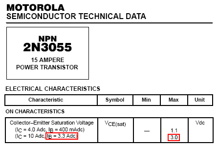

The 2N3055 transistor has a wide range of spec's from not bad to terrible:
1) 10A collector current.
2) A whopping 3.3A of base current.
Its max saturation voltage is a whopping 3.0V. You cannot use a base current of 10A because its max is "only" 7A. It barely amplifies.

Why are you even contemplating bjts? Surely this is a job for a MOSFET!
As I posted above, why even run the fuse current through a power transistor? The fuse blows when the PIC output is high AND the switch is closed. Instead of doing this AND function in the fuse circuit, do it in the relay coil circuit. You can probably do it with a TO-92 NPN.

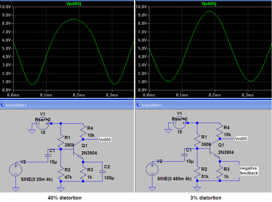

But transistors built for amplifiers still make good switches - and if you're talking transistors designed as switches, they are usually specifically designed for such purposes as RF power amplifiers, line output transistors, and SMPS transistors.
Any transistor with a low impedance voltage input and without negative feedback is very non-linear if its output level is anywhere near the supply voltage peak-to-peak.

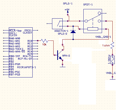

for some reason i didn't get the emails telling me people had replied to this... don't worry about this now, change of design for other reasons has rendered this obsolete, but, just to make it a bit clearer, the fuse isn't a regular electronics fuse, but actually an "electric match" used for firing pyro's... I need to build a circuit whereby i can "arm" the channel (close the switch to that channel) but not actually fire it.... using the 3055's when i had enough power to arm the channel there was enough power to blow the pyro, with only one pyro on the channel the fire current is approx 300mA, but it's going to be much greater with 20+ pyro's on each channel... tbh i don't think ive made this any clearer, but hey, im using relays now as they do what i need of them...
