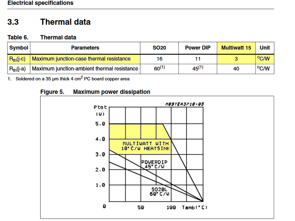

are they on a heatsink?

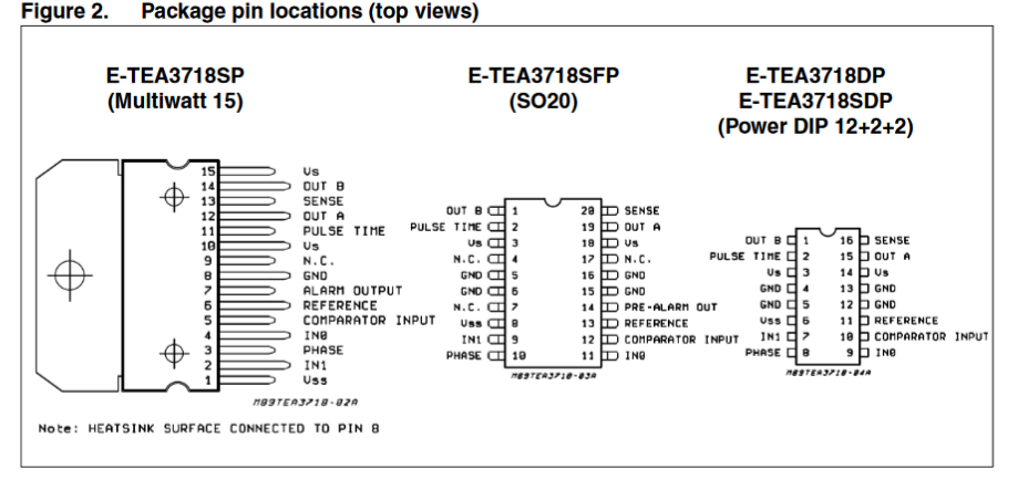

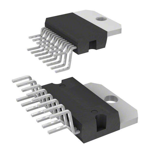

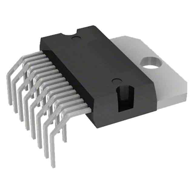

The 15 pin tab version ( TEA3718SP ) for attaching to a heatsink is obsolete.
The only sources are such as ebay, and they tend to be pricey!

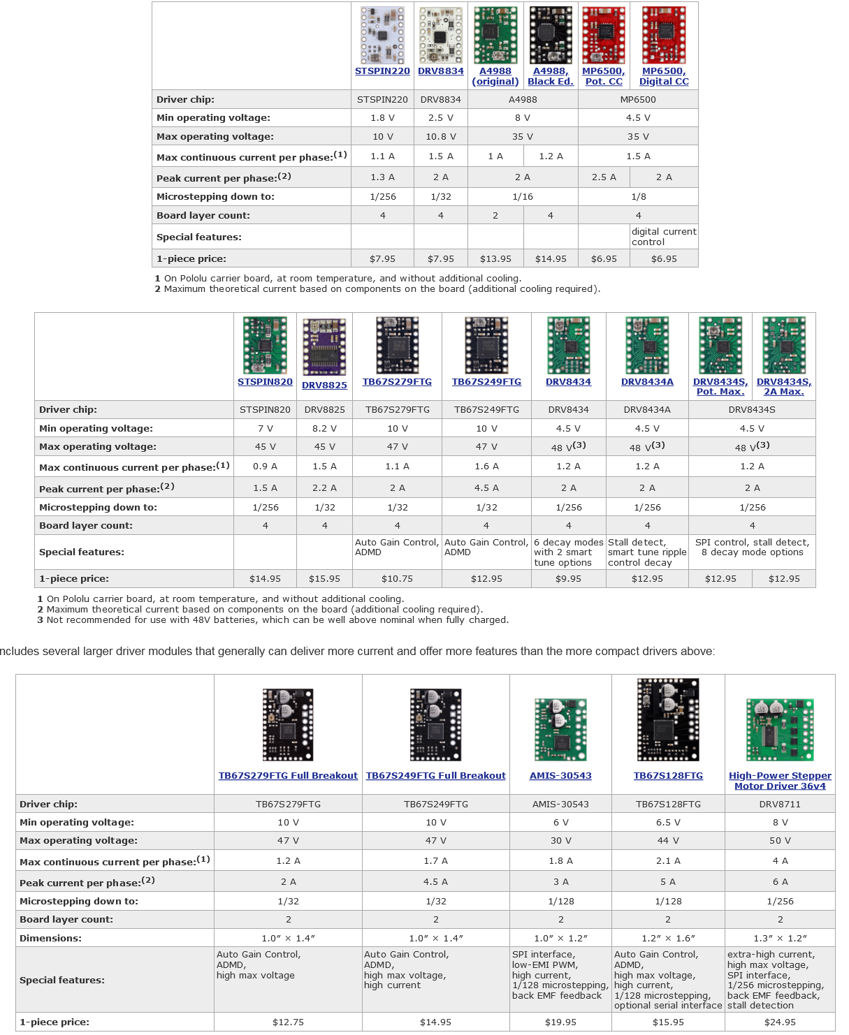

The price/performance ratio of FET bridge drivers >2A makes the BJT design 1.5A max obsolete but still useful for lower current apps.
