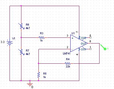

I am trying to design a thermistor based airflow sensor, but I am having trouble with getting the output voltage at a suitable level.
My current circuit takes two 4k7 positive coefficient linear thermistors set up as a potential divider and the second thermistor is externally heated with an additional resistor so that the potential divider is constantly biased one way.
However, the output has a very small swing of 0.1V - when measured through my 10bit ADC is only 30points. Given that the line could be noisy this isnt acceptable.
I tried amplifying the signal through a non-inverting op-amp but I need to reduce my input voltage by around 1.6V before I can amplify it - any thoughts?
Need a schematic of your setup.

The thermistors have a linear response, and only one is subjected to cooling via airflow.
If audioguru's here, he'd bash at you using a 741. It's an extremely lousy IC.:D
What is it that you're trying to amplify? The 0.1V output? A single stage differential amplifier is enough to obtain the desired output. See the datasheet of LM358, they're better op-amps, not the best though.
I know 741's are shoddy, but it was more about getting the theory right first.
The because of the thermistors dynamic range, but I am only going to have them running at about 15deg difference and so the resistances will be approx 4k7 and about 5k.
Using potential divider equation I want to keep a value of around 1.7V (and when no diff its 1.65V).
Ideally I want to constantly drop about 1.6V before amplifying the actaul difference... (or just amplify the difference between the two readings)

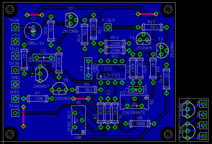

Hi Vizier87,
you might also want to take a look at the circuit designed by Steve Woodward. It heats one transistor for a constant temperature difference of both to be 50deg/C. So the airspeed doesn't really matter. Measuring airflow with a single LM35 doesn't take ambient temperature into account, and therefor can't be precise.
I wish I had an anemometer of his design when crawling through air channels and pipes measuring airspeed. The hot wire anemometers just need a little kick to become unusable, and replacement and calibration was awefully expensive.
Two transistors, mounted side by side don't take much more space than the hot wire pen, but they certainly can stand a lot more mechanical stress.
I also designed a single sided PCB layout for the anemometer. There are four wire jumps - necessary only for a 100% ground fill. The sensor board is the small one on the right side.
Boncuk

Hi, and thanks for everyones input.
It really helped just have specific terms for everything, but I think I am going to run two LM35 (or other linear temp->voltage sensor) through an instrumental differential amplifier.
This simulates perfectly, and should be relativly cheap to build.
Thanks again for the help.

I have used a device similar to the LM35 before and the response is fairly quick. I was planning on heating one of the LM35's hotter using a transistor driven resistor (using a PIC as a control - measuring the mark-space ratio)
I simulated the circuit in pspice (using voltage source in place of the LM35) and with a 0.1V diff (10deg) I was outputing 0.95V (this gives me around 31points of ADC per degree of difference).
Realistically the environment wont go less than 5deg or greater than 50deg so I should be ok.
