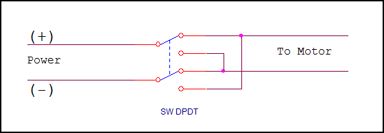

Yes. With a reversible DC motor a single DPDT (Double Pole Double Throw) switch can be used. Preferably On-Off-On with the center position off. The circuit would look a little like the below drawing:
That is merely an example of reversing polarity to a motor. that's all it is. Motor current needs considered, a real circuit would be fused and other details worked out. The switch would need to be rated for the full motor current.
