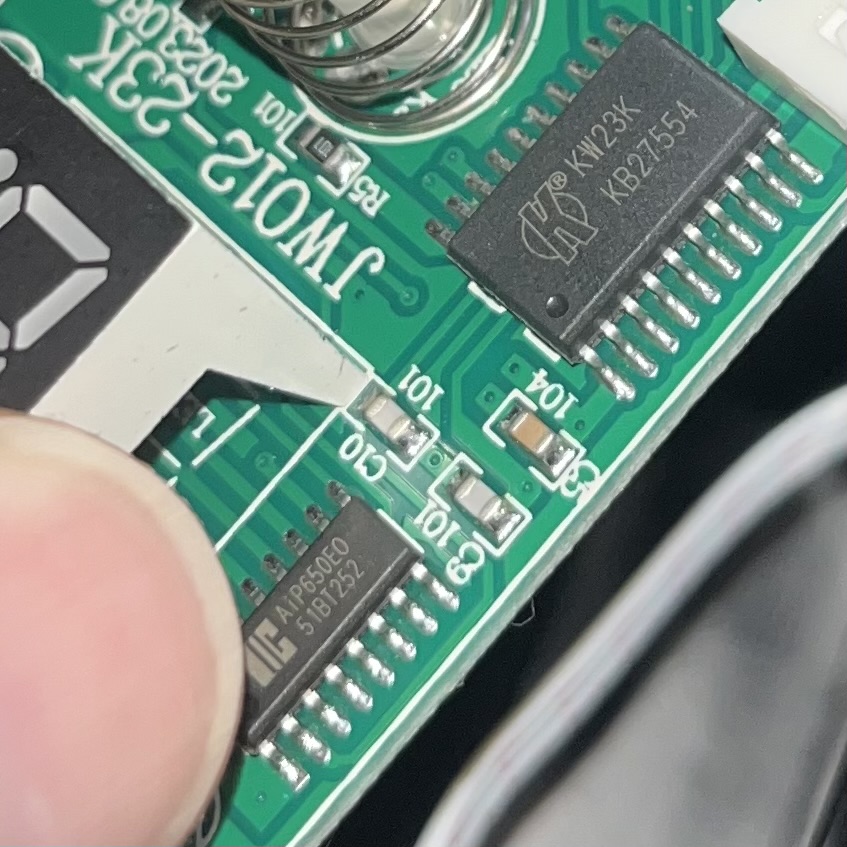

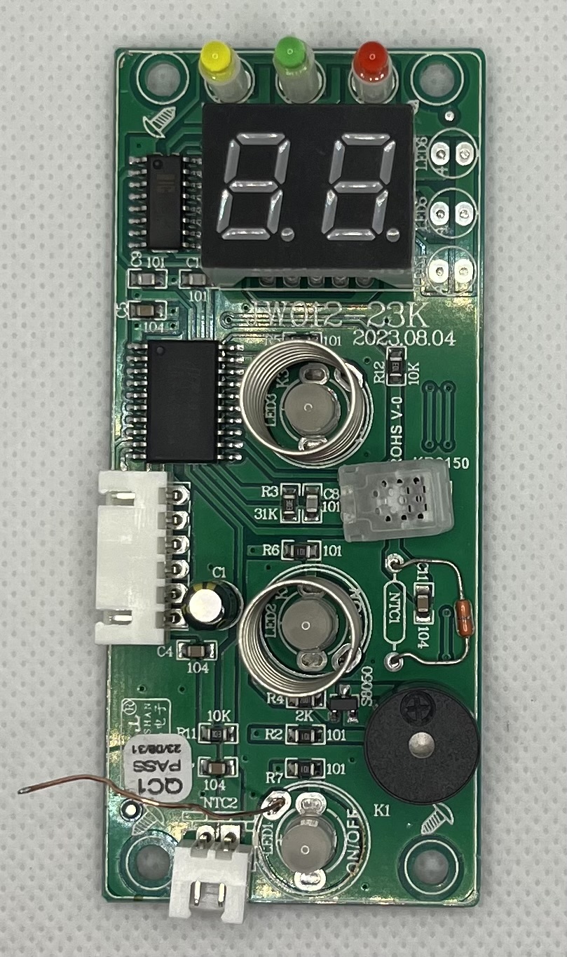

this was taken from an appliance that requires the press of a touch button to turn on.
capacitive touch button uses a spring with a single lead. power button is the first one from bottom to top (spring already removed).

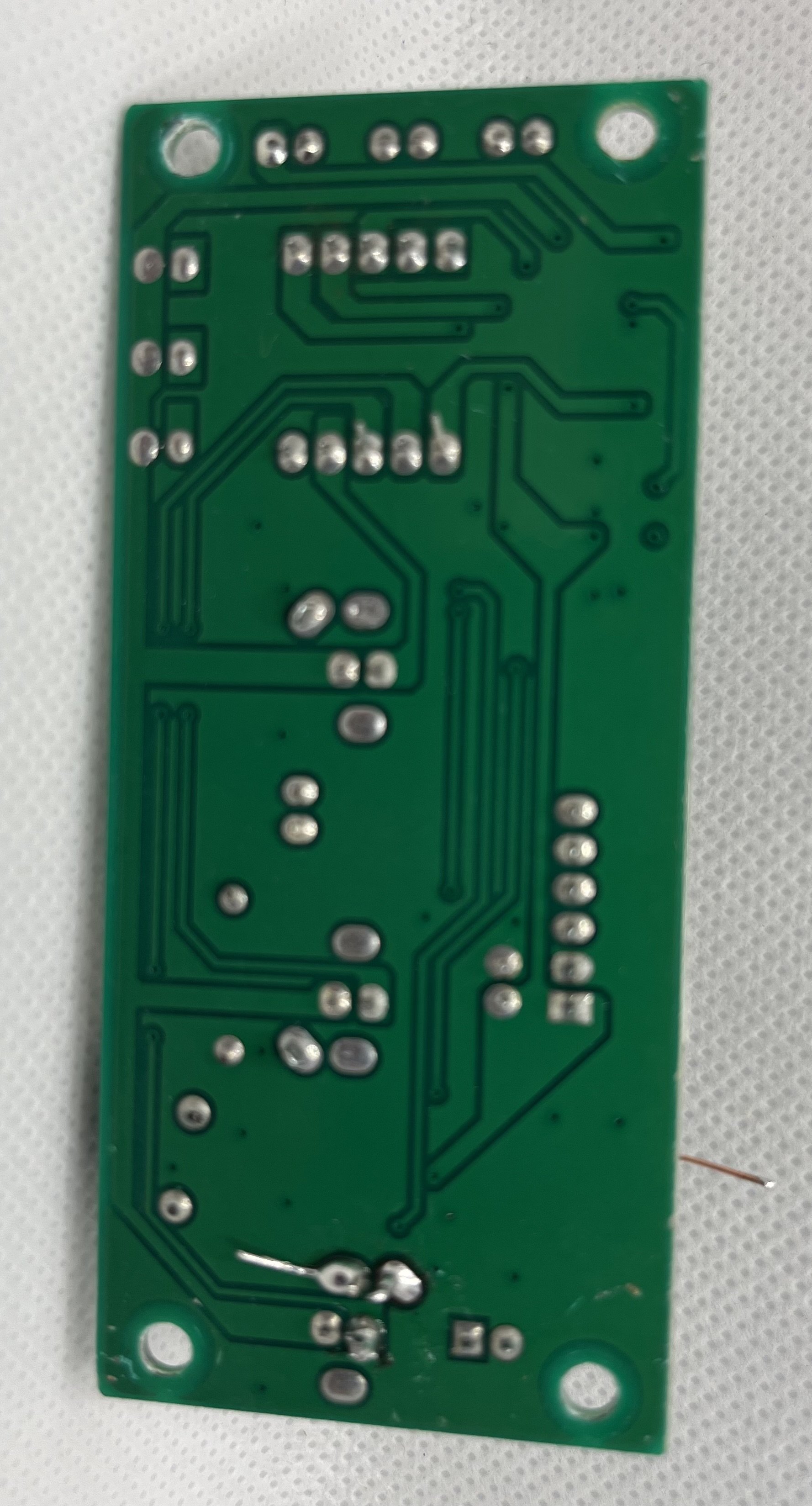

I tried to short the spring lead to ground (as shown in the pictures) with no success. should I try shorting it to VCC ? any idea the best pin to pick ? should I add a capacitor and/or resistor or a single jumper is enough ?
thanks in advance
shorting it to one of the legs of the LED does work but not as intended. it randomly switches between states (on/off) in a period of a couple of seconds to sometimes a couple of minutes.

Check for shorts. Photo is too fuzzy around your rework on bottom.
I mean only around the switch. Does the sensor have 3 pins + a guard ring?? You'll have to reverse engineer it. Otherwise AC couple the LED pin to the pad you need to bridge.
It’s just one spring (not shown in the picture) with a single pin. I tried to short this pin to multiple different places to no avail. I’m guessing I need some kind of pulse generator with a delayed single pulse. Maybe a RC circuit ?

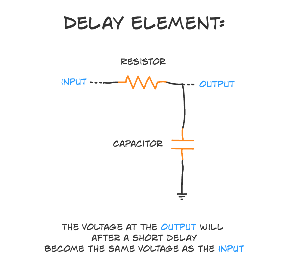

I was thinking something like this in the hope the capacitor would trigger the button ON while charging and then leave it alone for good (open circuit after fully charged).
The way your pcb works re the touch buttons (again assuming the correct pdf) is that it is looking for the change in state on the touch pad.
So, you touch the touch pad which the IC on your pcb detects as a change of state.
After determining that it is a legitimate touch, the IC causes something to happen i.e. turns on or lights a LED or whatever.
The IC then checks that the state has reverted back to the condition that applied before you touched it.
This is where you need to look at the how that circuit you linked works (RC delay to anyone else looking at this thread) and read the description a little more carefully i.e. "The voltage at the output will after a short delay become the same as the input" - it means the state on the input (touch) pin will not revert to it's original state after the initial turn on until you turn off the power.
By all means try it, but I'm pretty sure you'll find it won't work the way you want.

what if I swap GND and INPUT (VCC) in the picture below ?
I don't think it will make a difference, but as before, try it and see what happens.
Just be aware the input pin is expecting to see no more than 30pF, assuming the IC on your pcb is as per the above datasheet - are you able to read the numbers on the bigger of the two IC's and post here?
I am sorry for the delay.
Bigger one:
KW23K
KB27554
Smaller one:
AiP650EO
51BT252
