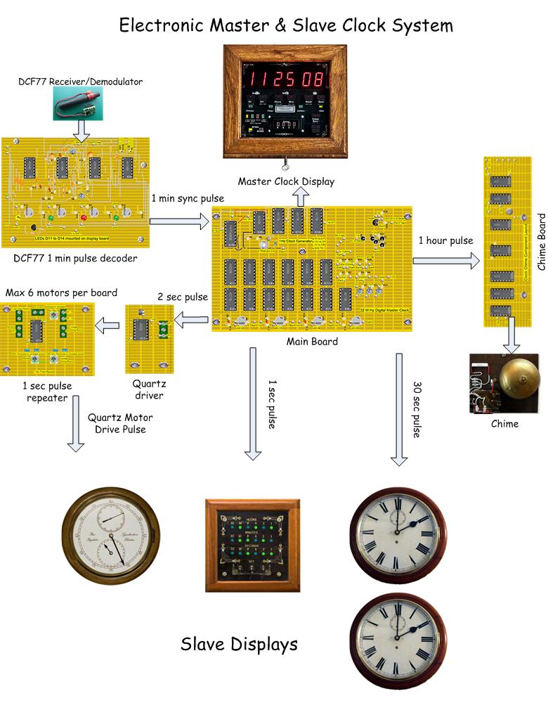

I have been thinking about using this circuit to sync my master. My master sends out 30 second and 1 sec pulses to drive my slaves. I am therefore limited to syncing my Master to within 1 second or my slaves will be out of sync.
My plan is to run my master a fraction fast (it does this anyway). This means the Master will work as normal but the 32.7KHz dividers will be reset or synchronized to the DCF77 pulse whenever it has received an error free frame. This means that as long as the Master is less than 1 second fast when it is synchronized by the DCF77 the slave seconds driven by the 1 second pulse will remain correct. In real terms this means one sync pulse from the DCF77 per couple of weeks to keep my master on time.
If for example the DCF77 failed to output a pulse for 3 weeks and my master was just over 1 second fast it would sync at exactly 1 second fast.
In real life my DCF77 sends out a good pulse every minute so this should not happen.

I spent Weds adding the DCF77 decoder into my Master clock. I had already pre-built and labeled the new switch mount along with the labeling for the LEDs (Lazertran onto aluminium).
To keep all the circuits together I added a new base to my Master and fitted it with another hinge so I have easy acces to the DCF77 board. There is now a hinge for the top and another for the base. The lower hinge is a lift off type so the whole clock can be removed from the wall.
After completing the mod I discovered that "the sync on 60seconds" switch in my Master is not required and can be left on all the time. I have added a note on my schematic on line.
The clock has now run overnight and is still "in sync". I will keep a close eye on it for the next few months.

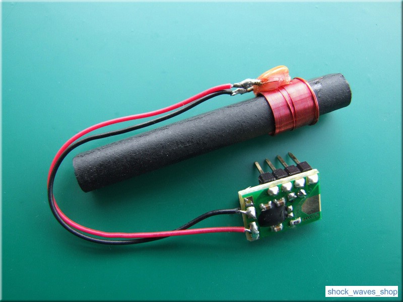

DCF77 module from Ebay
I have contacted the supplier of the DCF77 module on ebay and they have confirmed they we will be stocking the module as a long term stock item. The modules cost £12.85 with £1.85 postage. Looks like they will post world wide as well.
This module seems to work well in the UK, I'm just south of London. It will loose signal near LCD TVs or low wattage light bulbs but then they prob all do.
See links below.

I can't imagine it would be hard to make a DCF77 receiver yourself. Have you ever considered it? The frequency is so low you can use opamp bandpass filters around the carrier frequency. I would try myself, but I don't think my location is the best for DCF77 (or any other radio timecode for that matter)..
From reading many sites on radio controlled clocks the receiver is the part that causes most problems. My old Maplin project clock from the late 90s was the same and setting up the reciver was a real pain.

System layout incorporating the DCF77 decoder
Here is a very basic layout of my system with the DCF77 module and decoder board included showing some very basic interconnections.
