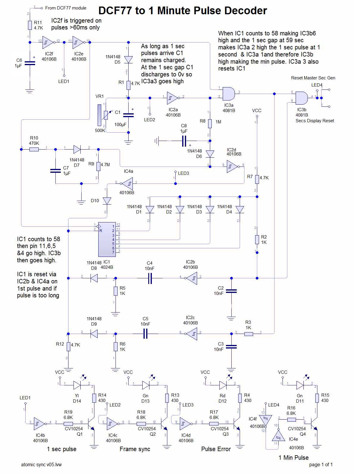

I have changed the values of VR1 and C1 (on my diagram) to 50k and 100µF as IC2a was being held low.
You mean VR2? C1 should be 10uF as it (along with R1) set the length of the output pulse and IC2a output is used for a number of functions. 4k7 * 100u --> ~0.47 seconds. It will require a few 100ms pulses before the 100u cap is charged. You should either decrease R1, or use a 500k pot and 10u cap (as per original). If IC2a (input) was being held low, it's because the pot was set too low.
The circuit works fine if I disconnect R7 (R4 on dougy83's diagram) where it goes to IC2d and connect R7 to +ve.
The inverter IC2d with R7 disconnected is perm high on it's output.
If the inverter output is always high, then it should have the same effect as connecting R7 to +ve. I don't believe this is the case, see next paragraph.
Can anyone explain how the 2 RC combinations C7&R9 (R12&C8)and R8&C8 (R11&C7) work in this circuit so I can work out what components require changing?
R9 is just a pull-down, not a timing element (well not much;)).
R10*C7: C7 goes high if an input second pulse is high for too long: this is an unexpected/signal-faulty condition. It discharges during the gaps between pulses.
R8*C8: C8 goes high a second or so after the 2 second break has been detected: this is an unexpected/signal-faulty condition. As C1 has been increased without changing R1, IC2a output will be high for >4 seconds while C1 is charged with 100ms pulses each second. This will mean that C8 will have ample time to charge, and IC2d will go low after a break, resetting the counter. C8 discharges after the first pulse after a excessively long break or signal dropout (if C1 was correct).
I think R8 & C8 will charge for a pulse longer than a second so that will be 2 seconds as IC2a only goes high after a 1 sec pulse?
IC2a? Oh, on my diagram this time:rolleyes: I'm only going to reference components as per your diagram.
IC2a goes high after ~1.7 seconds of no pulses, and stays high until halfway through the first pulse (if R1*C1 is correct). It goes low halfway through the first pulse after a long break. Therefore IC3a is high for the first half of the the first pulse after a long break.
R8C8 determine how long after the 1.7 seconds a break is allowed to take. If it's too long, IC2a goes low and resets the counter.
Does C7 only discharge on very long pulses over 4 seconds so normally IC2d OP would be low?
C7 discharges between 100/200ms pulses.
I suppose I could disconnect each RC combination in turn where it goes into IC2d and see which one is the culprit. Then adjust values to make it work.
Try fixing C1 first!
If the IC2d input impedance is crap, you can scale R8/9/10 down 100 times, and scale up C7/8 100 times.

First, fix C1.
Next, connect R7 to +ve. This will stop my fault detect circuit allowing the counter to go haywire when there is a fault (not the desired result).
The fault detect (active low) output - IC2d - needs to be connected to the counter reset (through an transistor inverter). Use a resistor (10k is fine) from IC2d O/P to the base of a new PNP transistor 'Q1'. Q1 emitter to +ve. Q1 collector to IC1 reset.
I'd like to add a bit of general info to Dougy83's help, re the RC filters you can just leave the C disconnected (not soldered in) until you check everything works ok.
Then solder in the C to make the RC filters work, they are easy to "tune" on the oscilloscope as you can see the voltage rise/fall over time. With most CMOS these days they have input triggering hysteresis about 1/4 of Vcc and 3/4 of Vcc, so if you use dual traces on the cro it's very easy to see what the filter voltage is doing vs the output of the schmidt inverter.
Not sure which 'C' you're on about... They're all there for a reason. Also, the schitt trigger is likely to trigger at 1/3 & 2/3 rail.

I have a couple of spare gates on IC3 if I short the IPs and make an inverter could I use them instead of the transistor?
You could try using one of the spare AND gates instead of the schmitt trigger inverter and transistor, but because the AND gate doesn't have a schmitt trigger input and the voltage to the input of the gate has a very slow rise/fall time, I wouldn't recommend doing it. The AND gate wouldn't like it, and the switching could possibly (?? not sure ??) be somewhat erratic.
If you did use the AND gate, you'd need to connect a series diode on the output to allow it to combine with the other reset signals.
I have put back C1 and played around with the values for VR1 (says VR2 on my diagram but is VR1) and got the circuit working OK without IC2d in for now.
I have another Schmitt inverter IC so could use it on the output of IC2d.

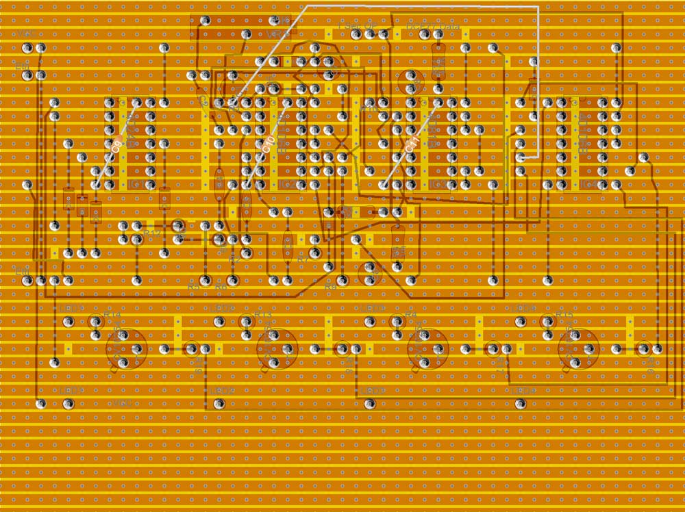

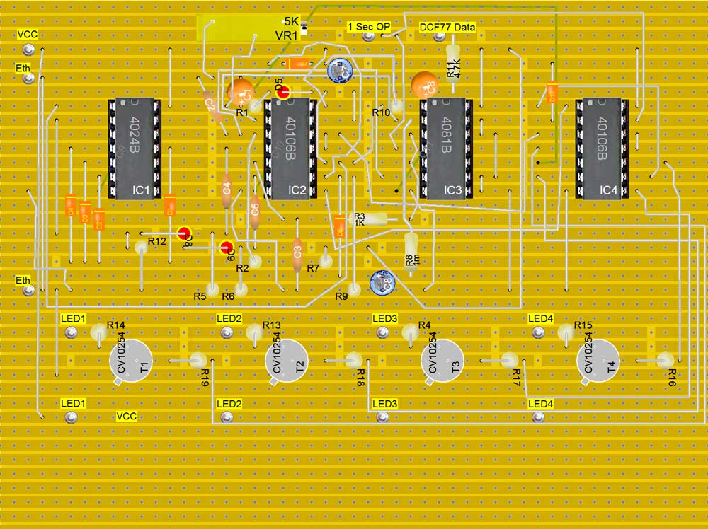

edit see diagram C1= 10microF R1 =500K , Vero layout C8 above IC3 should be C6
On testing C6 should be 1microF.

Gave the circuit a quick power up this evening and found the "Frame sync" and "Pulse Error" LEDs lit.
Once the DCF77 started generating pulses the 1 sec pulse LED flashed in time to the pulses. 100ms and 200ms pulses could be clearly seen (you could prob tell the time from these with a bit of practise). After a few pulses the "Frame Sync" and "Pulse Error" LED went off.
Every thing was fine until the 1.7 sec gap the "Frame sync" led came on as expected very closely followed by the "Pulse Error" LED.
I checked R8 and found I had been supplied with a 100ohm not a 1M resister. I double checked all resisters out of the packet with my meter before installing but must of missed this one. At least it made the extra work fitting the LEDs worth while.
After replacing the resister the circuit cycled correctly and the "1 min pulse LED" flashed to show a full cycle. I'm not sure the circuit reset itself correctly as the 2nd cycle failed.

Circuit is now up and running. I changed C6 to 1 microF as I could not get IC2f to trigger off the DCF77 pulses with the 10 or a 4.7 microF capacitor. The main thing is there have been no false 1 min pulses even when I position the receiver at the edge of reception.
