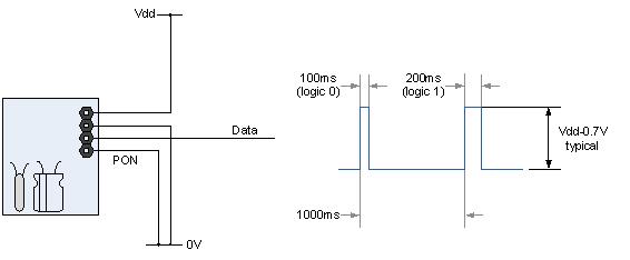

I see and understand clearly the DCF format, what I am not sure about is the output from the module that Brett has bought from eBay.
If you look at the eBay link it just shows 100mS and 1sec later 200mS.
I would like to see what other information is on the documentation that was supplied with the module, thats all I keep asking for.:)
Hi the output format is as the DSF77 but pulse amplitude .7v below VDD.
There is no other info with the module bar the pin outs and info on the DCF77 code.
The module works from 1.2 to 5.5v.
edit The diagram with the module just shows a random sample from a frame of data.
The module output is the demodulated dcf signal, inverted.

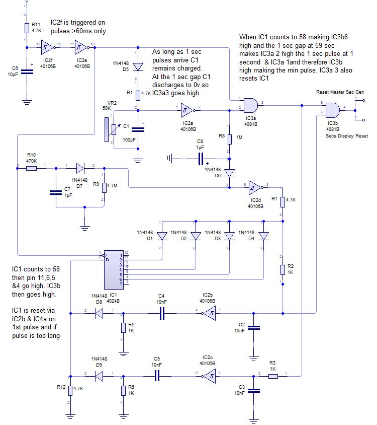

I have now built the circuit on vero board and have drawn out your circuit in live wire and uploaded a copy.
I have changed the values of VR1 and C1 (on my diagram) to 50k and 100µF as IC2a was being held low.
I am having a few problems with the circuit and think I need to tweek a few components.
The circuit works fine if I disconnect R7 (R4 on dougy83's diagram) where it goes to IC2d and connect R7 to +ve.
The inverter IC2d with R7 disconnected is perm high on it's output.
Can anyone explain how the 2 RC combinations C7&R9 (R12&C8)and R8&C8 (R11&C7) work in this circuit so I can work out what components require changing?
I think R8 & C8 will charge for a pulse longer than a second so that will be 2 seconds as IC2a only goes high after a 1 sec pulse?
Does C7 only discharge on very long pulses over 4 seconds so normally IC2d OP would be low?
I suppose I could disconnect each RC combination in turn where it goes into IC2d and see which one is the culprit. Then adjust values to make it work.
