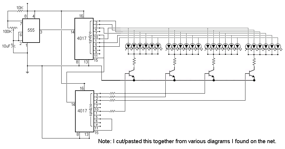

I have. That is, if you mean what I think you mean. I have done it several times using something similar to the enclosed diagram. ( note that this is not the actual diagram I used, it's one I've just thrown together to give you the idea )
Have the 555 as a clock pulsing the first 4017, counting from 1 - 6 then moving the second 4017 on 1 then resetting. When the second 4017 counts past 4, it resets. 4 x 6 = 24. :)
Put "555 4017" into google for example circuits of chasers.
Hope this helps.

Hi houseofwax,
Yes, a chaser is the basic idea, but i need it to 'stack on' the LEDs instead of one after the other.

I cant see how the circuit posted does that, but if it does, please tell me how...
-mike

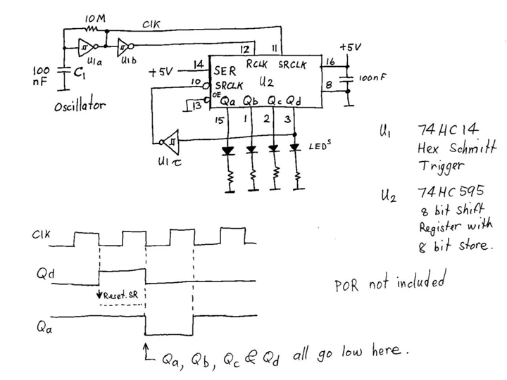

Hey dch222,
Thanks for that. im not very good with shift registers, do you know any good sites? Is the 74HC595 what I need? Its the only shift reg. my supplier stocks.
Thanks all
Yes, it will do exactly what you want.
Connect:-
the oscillator to SRCLK & to RCLK (pins 11 & 12) via an inverter.
+5 Volt to SER (pin 14).
Gnd to OE (pin 13).
Qh (pin 7) to SRCLR (pin 10) via an inverter.
When the power is first switched on there will be a random pattern in the SR so it will need several clock pulses to shift this out.
If this is undesirable, you will need to install a "power on reset".

What I described is for 8 LEDs. So if you only need 5 as per your initial post, then take the output from Qe not Qh.
You will need 2 ICs, the 74HC595 and a 74HC14.
The 74HC14 will do the inverting and the oscillator functions. And if you really need "power on reset" then you will need a diode and a resistor wired as an OR gate and a capacitor and resistor for the timing.

mike11298 said:
3 volts... I think
To check, I suggest you connect one in series with a 330 Ohm resistor and connect it across 5 Volt and measure the LED voltage. If it is 3 Volt, then 330 Ohm will set the current at about 6 mA. Iled = (5 - Vled)/R
Attached is the basic circuit, configured for 4 LEDs. You may wish to build and test this one before making the full 24 LED version.
I have not included the POR. I have chosen C1 and the 10 M to make the oscillator frequency about 1 Hz. If you want a different frequency, change C1.
I'll draw the full circuit later.
