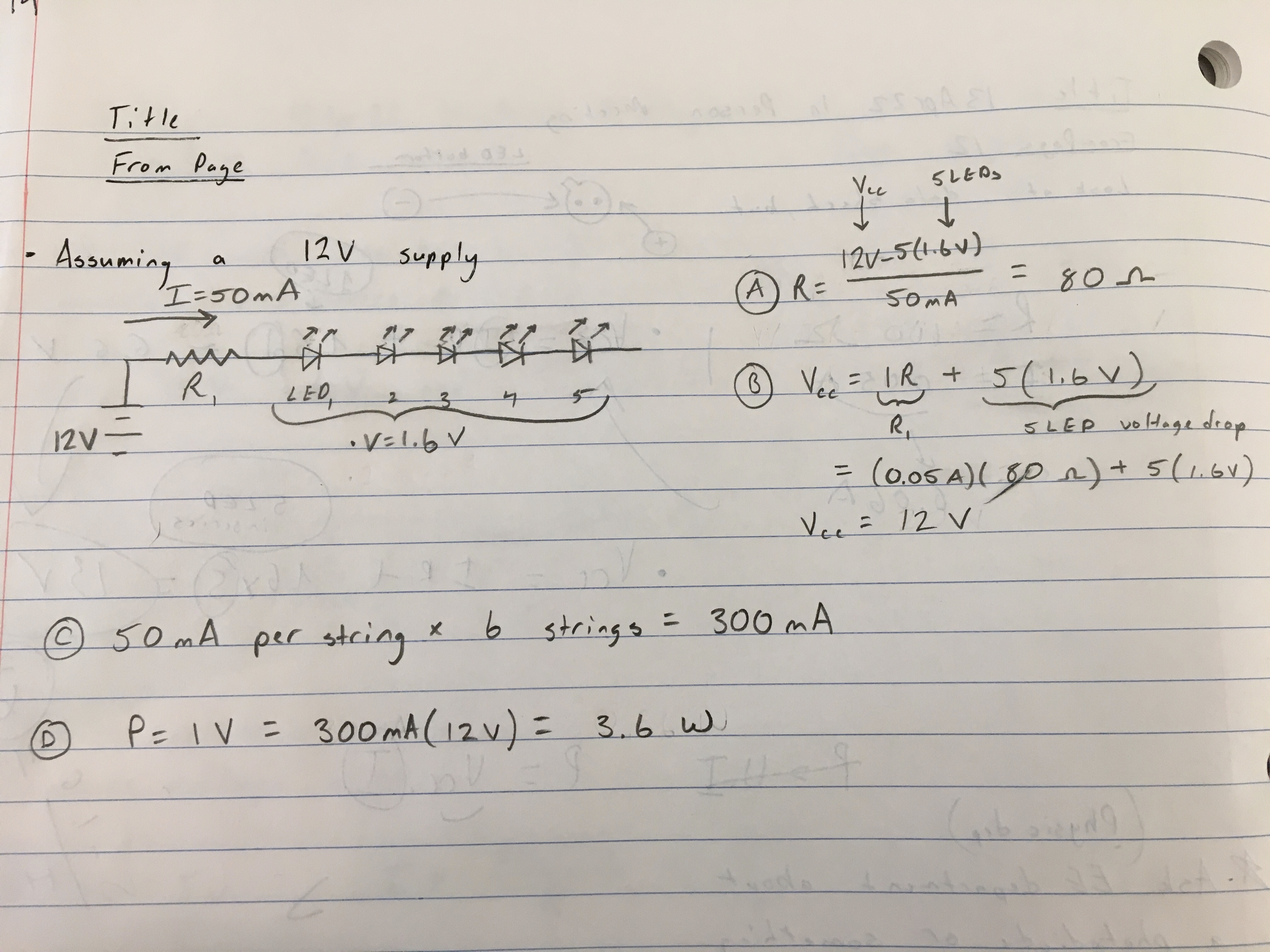

I'm very much looking forward to fully understanding everything here one day, but I'd love some clarification/verification please and thank you. lol :D
I'm going to include a picture of my work, with letters to serve as a guide.
A) I know that current through a series circuit stays the same and, since I need 50mA and am assuming a 12V source, I can calculate my resistor requirement for a single branch with 5 leds. I get: 80Ω
B) This was work from a previous page, but verifies that my calculations are correct.
C) It seems pretty obvious (now that I think about it) that the current needs would just add up.
D) P=IV gives me the wattage requirements for the circuit.
And for the source, if we use this battery as an example:
It has an I=2.5A, V=3.6V nominal. If I do P=IV = 20(3.6) = 9W
Then I can simply divide that value by my circuit wattage requirements to find around how long in terms of hours?
9/3.6 =2.5 hrs (ideal)
I thought watts were in terms of joules/sec? But we can treat these in terms of hours?

Yes, all correct.
Batteries are rated in Ah - your battery is 2.5Ah (not 2.5A) meaning it can supply 2.5A for 1 hour or 0.25A for 10 hours or 1.25A for 2 hours. So to say it contains 9W is wrong (sorry, I started that) and it should be Wh. This is why we can use the number to calculate the time the battery will last.
Calculating your series resistor was also easy. I know that 50mA is one twentieth of an amp so to drop 4V requires 4*20Ω.

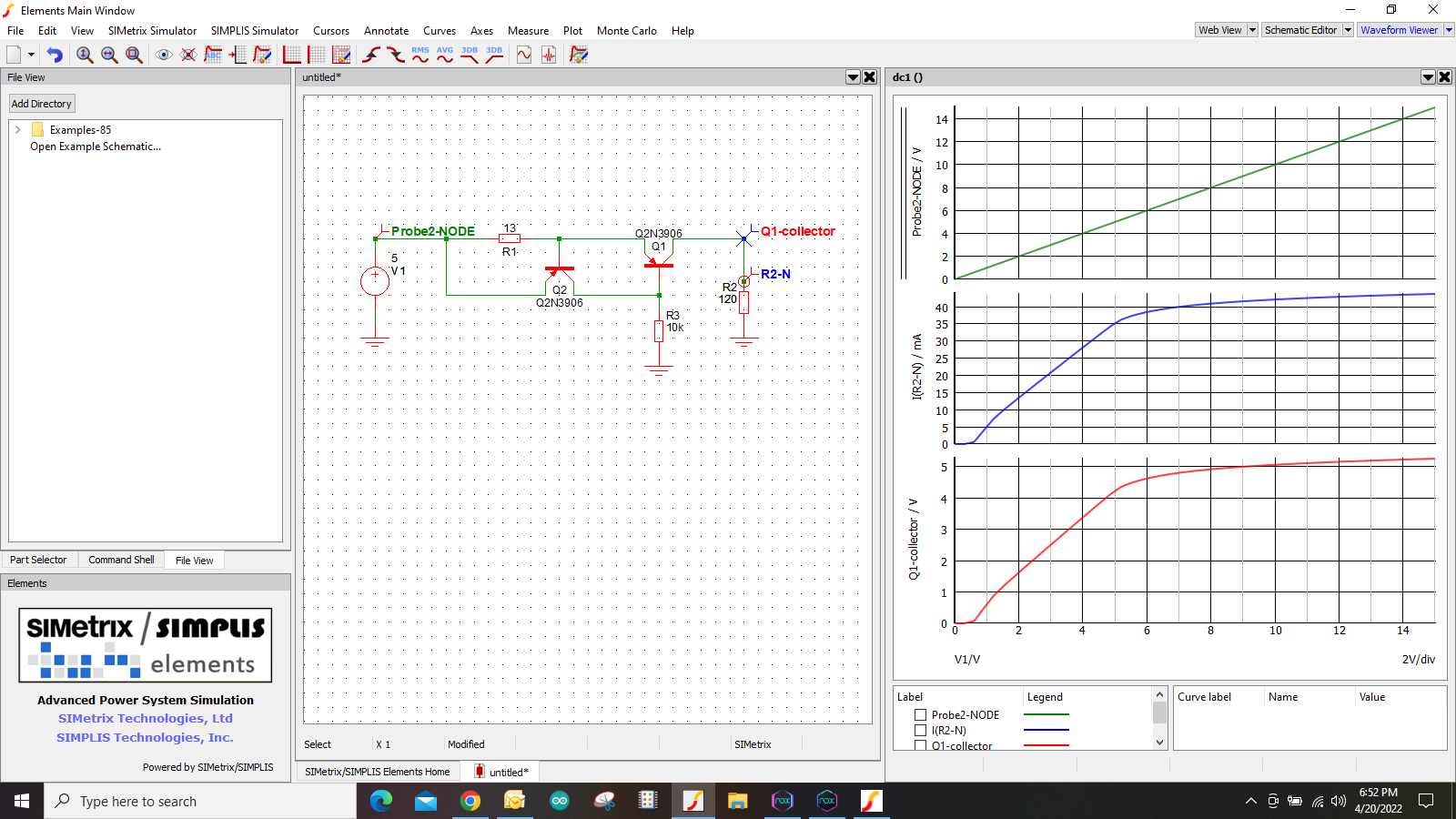

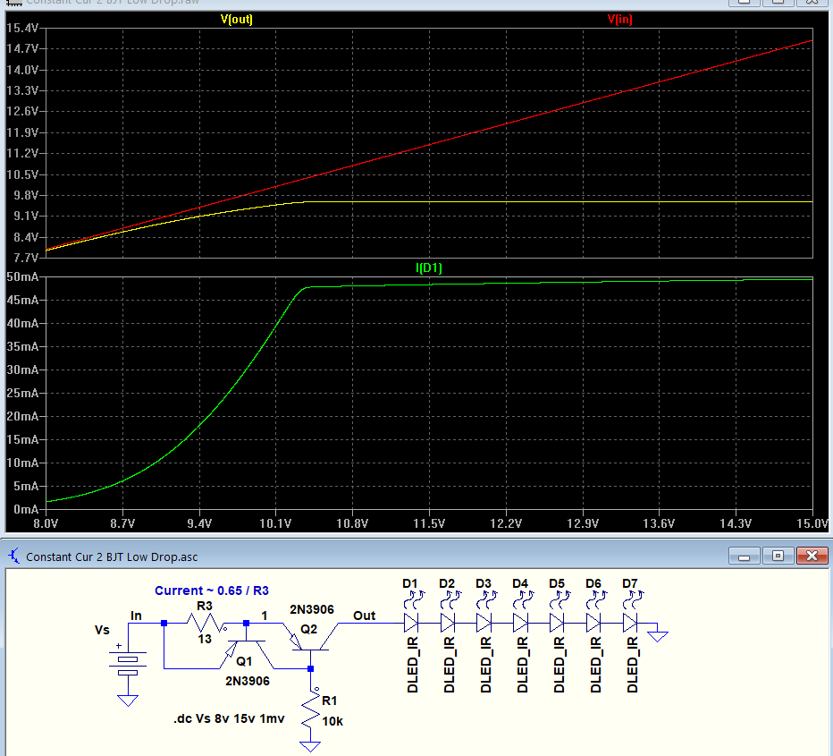

Below is the LTspice simulation of a simple two-transistor constant-current circuit that will operate with an LED voltage (yellow trace) to within <1V of the battery voltage (red trace) with the LED current (green trace) staying quite constant above that:
That allows good use of the battery voltage for better efficiency, and minimizes change in LED brightness with battery voltage.
Note that the LEDs I used in the simulation have about a 1.37V drop @ 50mA rather than the 1.6V drop of your LEDs.
For ones with 1.6V drop you should be able to put 6 LEDs in series, giving 5 strings, to operate below 11V battery voltage.
Hey Crutschow, thank you for your response! I had been told that a transistor might be better at controlling the current through the leds, so that there's no variation in intensity. I do have a microcontroller that can simply issue the command to flip the transistor.

I noticed that there's no resistor immediately before the leds. Is that because the resistors in your constant-current circuit make up for that? Would the 5 strings just be put in parallel at the OUT point?
Yes, the value of R3 determines the LED current, as the equation next to it shows.
No, each string needs its own current limiter circuit to avoid one string taking more current than the others.
do you have any recommendations for me to better understand what you've shared?
If you understand how BJTs work, then understanding its operation should not be difficult.
R1 provides base current to Q2 to turn it on (current from emitter to base turns on a PNP transistor).
When the output current through R3 generates sufficient voltage across it to turn on Q3 (about 0.65V) then it starts to conduct and raises the voltage on R1 until Q2 starts to turn off, thus limiting the current to that value.
The circuit could also be built with NPN transistors, but the circuit would be put in series with the ground side of the LEDs instead of the high side.
Make sense?
If you simulate the circuit, then you can look at all the node voltages and currents to help understand how it works.
Might be a good time to try that with LTspice, since it's a simple circuit to start with.

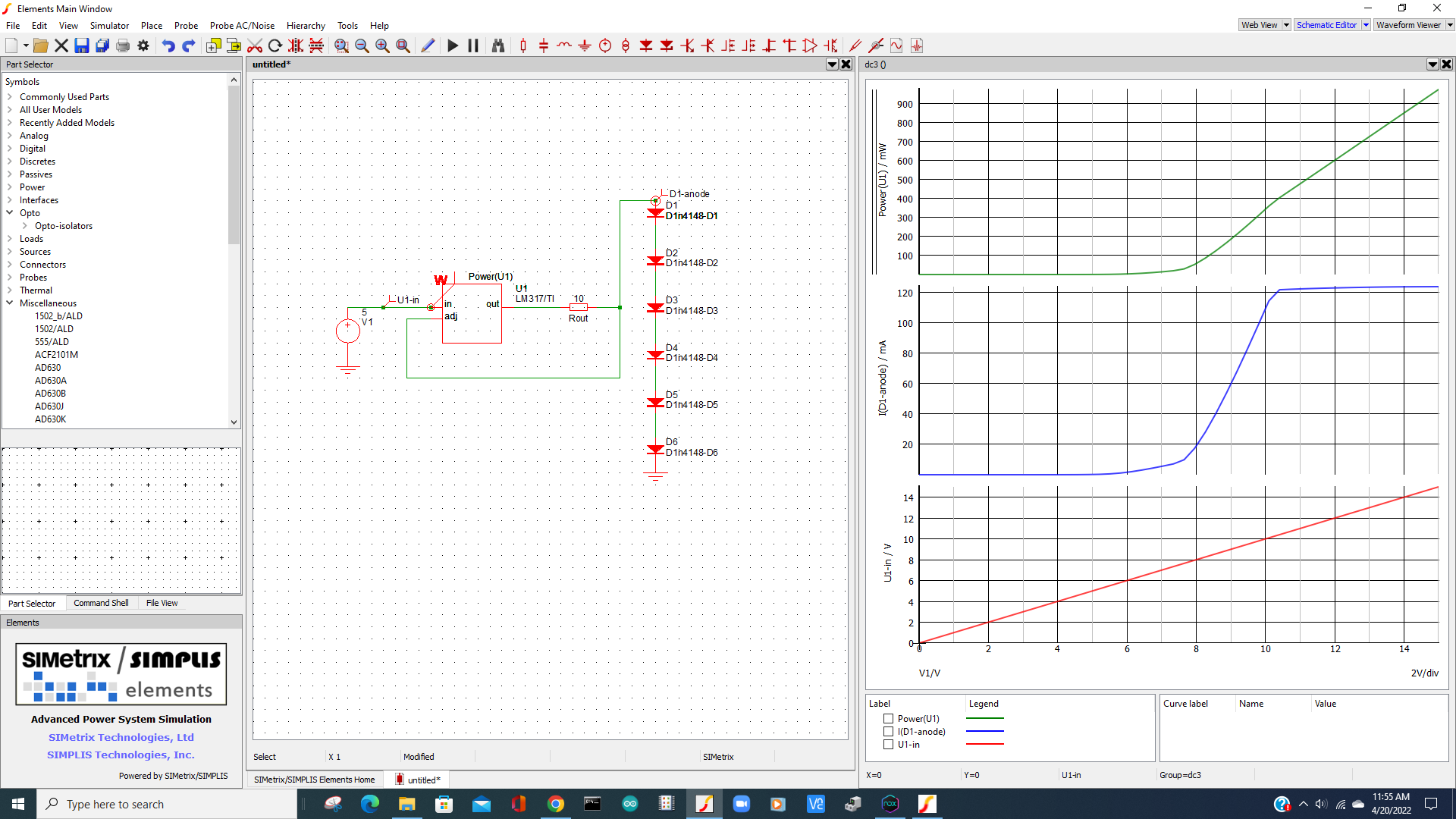

This uses a 3 Terminal adjustable regulator for a constant current source.
Has advantage it is both internal short circuit and thermal protected.
The current is Iled = 1.2V / Rout
Note I used regular diodes as I did not have a spice model, and modified their threshold to 1.6V.
Regards, Dana.
The downside for battery operation is that its dropout voltage is about 3V, whereas the circuit I posted requires less than a volt.
Of course depends on # LEDs / string and what battery V he plans on using.
Otherwise use an LDO....dropouts << 1V, plus you get short circuit and thermal protection.
Regards, Dana.
