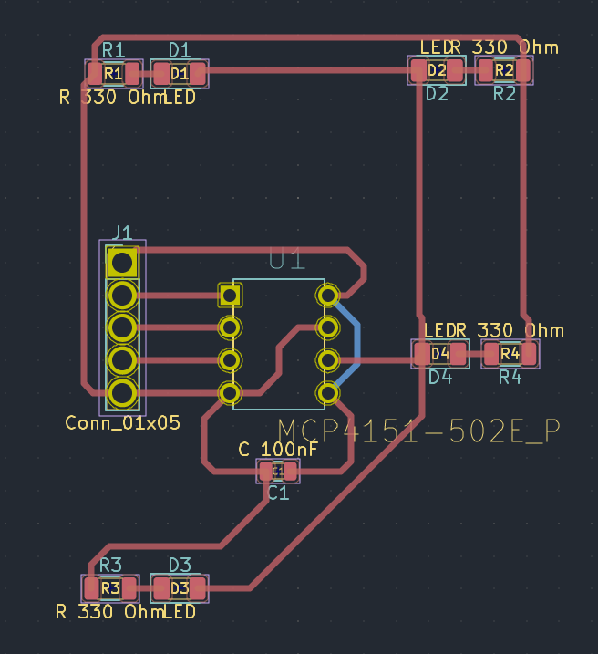

Basic idea is such that I want to drive 4 infrared LEDs with MCP4151 digital pot (I need to have a programmatical control over the LEDs brightness – no knobs). I have used this schematic as a starting point: Original article
I have amended it to drive 4 LEDs instead of a one, but then of course I have hit issues. Main one being that the pot in question can only output max 25 mA (each of my LEDs can output 70 mA). I had some help on one of the Facebook groups but that only went so far.
Here is my first working circuit (that works fine with SMD LEDs that use very small power):

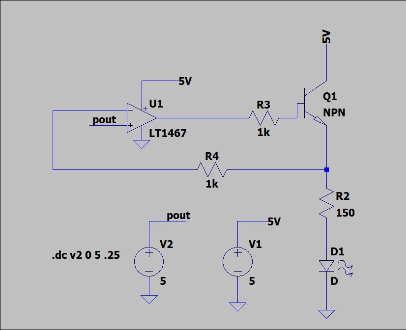

The latest suggestion I received form a very helpful fellow on one of the facebook groups was to use transistor and op-amp, below I post his diagram. Problem is that I do not understand (even on a most basic level) why this is a good solution. He suggests using four of those mini-circuits to drive each LED individually.

the principle used in the example circuit you give is OK, but the exact arrangement is not ideal.
Move the LED from the emitter / ground side to the collecto (5V) connection. The collector current will then start at zero with zero voltage from the pot.
If all LEDs should change brightness together, connect a low value resistor in series with each, eg. something around 47 Ohms, then connect all four LED+ resistor circuits in parallel between the transistor collector and power.
The value of the emitter resistor will define the current, in proportion to the pot output voltage; eg. if it were 100 Ohms, the current through it with 1V from the pot would be 10mA; 22 Ohms would give near 50mA at 1V.
With only 5V supply, you may need to divide down the pot output voltage with more than around 1V to the opamp, otherwise there will not be enough headroom to drive the LEDs.
Edit - that should say "divide down the pot output voltage with no more than around 1V to the opamp..."
