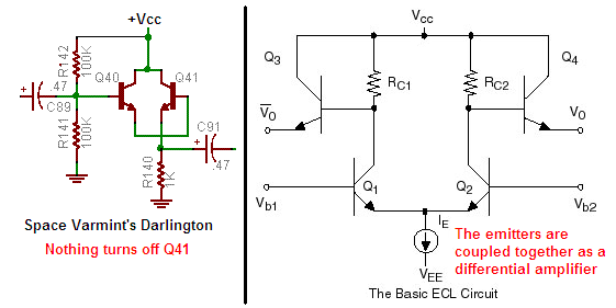

Darlingtons work very well in rf. A Darlington is actually an ECL device and they switch faster than CE amps. Thats why cray computers use ECL in the data & address busses.
No.
A darlington transistor is very slow and is hopeless at radio frequencies. I won't use them for high quality audio. The problem is that the second transistor "floats" off slowly.
An ECL logic circuit is very fast because it uses an emitter-coupled differential amplifier that is not allowed to saturate. It is completely different to a darlington, but The Space Varmint draws his darlingtons with one transistor backwards so it resembles the look of an ECL differential amplifier.

I've had really poor results using darlingtons for RF, too. You can get some improvement adding a pull-down resistor to the base of Q41 there, but they still aren't super-fast.

Darlingtons are great rf circuits.

Nothing turns off Q41...oh brother, where do you the signal output comes from on Q41 idget?
Also even in audio it has become common practice to use Darlingtons for speaker drivers instead of using audio transformers. Integrated packages like the TIP120 are good for this.
The whole trick to using them in rf is to match the impedance. It's very simple. The input Z is R1 / R2 and the output impedance is RE. They perform a whole host of very useful and desirable functions in rf as I mentioned above.

I showed your slow darlington emitter-followers and I showed an extremely fast ECL gate with its emitters coupled together. They are completely different.
Darlington emitter-followers are not the same as an ECL differential amplifier.
Guess What ECL means? Emitter Coupled Logic. The emitters are coupled together.
Your darlington emitter-followers have the base of the second transistor connected to the emitter of the first transistor and their emitters are not connected together.
A TIP120 darlington has built-in resistors to turn off the transistors as fast as possible. Your darlingtons have nothing to turn off the second transistor. It slowly floats off.
The datasheet for the TIP120 darlington transistor shows that its current gain is half at only 50kHz and is 1/10th at only 200kHz. It is 1/100th at 800kHz.

Oh, so all configurations are the same? My my how you knit pick to try to prove yourself right since you can't make a radio. All you got to do is read and learn. What do you think emitter follower is? It is the basic building blocks of ECL. ECl is based on emitter follower. Let's go back to electronics 101. You just got to prove me wrong about something...don't you?
Hey guru. If you study real hard, you might be able to make a crystal set. Let's see, I made my first 3 transistor radio when I was about 11 years old. At least get your ham ticket. Stop bashing me....buzz off!
Basic Electronics.....transistors switch faster in emitter follower configuration.....HELLO?

Here is a quote from an article.
Darlington pair transistor circuits are not normally used for high frequency applications. The Darlington pair is inherently relatively slow because the base current for the output transistor cannot shut off instantly. As a result Darlington pairs are generally used in low frequency applications including in power supplies or areas where a very high input impedance is needed.
Here is link to article.
Transistor Darlington Pair :: Electronics and Radio Today
