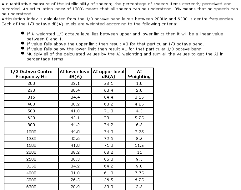

My upper hearing drops out above 12k and I can understand English speech just fine.
This chart suggests 7k is more than enough.
From **broken link removed**
