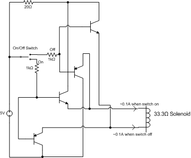

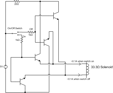

Hi can someone verify my little circuit please.
When I switch on I need 0.1A to go one way through a solenoid and when I switch off I need the 0.1A to go the other way.
Much appreciated.
Craig
Can you use a center off double pole switch? Really easy to reverse current with one.
Your circuit has floating bases, you may want to add a couple more resistors to keep the tied to power & gnd.
Yeah I can use what ever I like....I just thought transistors would work ok.
Instead of having a manual switch I am going to send 5V directly to the Base of the transistors from a PIC chip. I.e. to turn ON I send 5V to the Base of the ON transistors and OFF sends 5V to the Base of the OFF transistors.
Thanks.
Craig

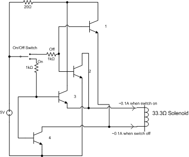

You need two PNP and two NPN transistors.
Thanks for that...missed the PNP, NPN relations.
Attached is new circuit. I still have floating bases though as pointed out by blueroom....how do I stop that?
Cheers,
Craig

Sorry I didn't notice before... you also need to swap the PNP emitters with one another.
Your bases won't be floating when you hook them to the PIC.
Sorry I don't follow that one. The PNP Emitters go to either solenoid terminal to make the current go from 0.1A one way or 0.1A the other way....that's correct isn't it? Oh that little symbol in front of the 0.1A is a ~ for approximate. It looks like a "-" negative when its small.

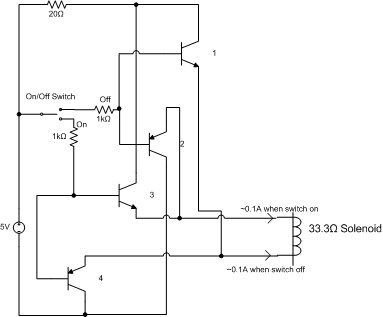

I think I know what you mean....I needed NPN transistors didn't I?
As in the diagram.
Transistors 2 and 4 should be PNP. Emitters 1 and 2 should be connected together. Emitters 3 and 4 together too.
Sorry I took so long to reply, my internet at home is down.
But if 1 and 2 emitters were connected together then the current would go straight to ground wouldn't it? I wouldn't get any current going through the solenoid.
Sorry I am not following what you mean.
Here's what I mean: The two inputs are MCU ports. Won't work with a switch without additional resistors. Probably should replace the 1Ks with 220 or 270 ohms.

Thanks, but when the Off/On switch is on wouldn't there be a straight path down to ground missing the solenoid?
EDIT: I think I am not clear on what a PNP transistor does. Is it the opposite of an NPN? In that it is on when the Base is Low and Off when the base is High?
When the top input is high, T1 acts as an emitter follower and its emitter is at approximately 5V-Vbe. T2 is not conducting. When it is low, T2 acts as an emitter follower and its emitter is at approximately GND+Vbe, and T1 is not conducting.
Similarly for the other input, with T3 and T4 respectively.
Note that as emitter followers T2 and T4 don't turn on unless their bases are actively pulled towards GND.
Consider the following 4 cases:
A) HIGH/LOW - T1 emitter pulls to 5-Vbe. T4 emitter pulls to GND+Vbe. Coil receives +5V-(2*Vbe).
B) LOW/HIGH - T2 emitter pulls to GND+Vbe. T3 emitter pulls to 5V-Vbe. Coil receives -(+5V-(2*Vbe)).
C) LOW/LOW - T2 emitter pulls to GND+Vbe, T4 pulls to GND+Vbe. Both ends of coil at the same potential.
D) HIGH/HIGH - T1 emitter pulls to 5V-Vbe, T3 emitter pulls to 5V-Vbe. Both ends of coil at the same potential.

I tried it out on my solenoid and it worked fine when I changed the bases from 5V to 0V on either transistor. I then connected it up to my PIC chip and drove the base via that. However this didn't work.
I am setting PORTE.0 and PORTE.1 as the two outputs. I set PORTE.0 to $FF and then PORTE.1 to $0 and I would expect the bases to be 5V on RE0 and 0V on RE1 however RE1 carries a voltage of 1.4V and instead of the negative terminal being 0V it is 2.2V and the positive is 4.9V going in to the solenoid. Is there any reason why this would be?

My actual voltage differential across the solenoid is only 2.5V either way....I'm a bit confused as to why? Any ideas how to correct this?

G'day Rich,
Which circuit version are you using, any chance of a posting, of the latest.?:)
