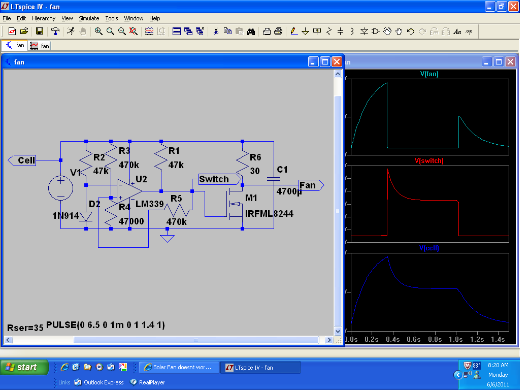

Fan start circuit
This seems like a lot of work to get a fan started.:) It might be easier to get another solar panel. But, here is a circuit that uses a logic level MOS FET. This will eliminate the voltage drop across the SCR. It includes a comparator to set the turn on voltage close to the maximum output of the panel and a much larger cap to store some energy to get the fan started. The diode for the voltage reference is not the best but will probably be ok.
