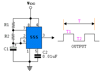

If I use this configuration of 555 can it be tuned to 55930HZ?
555
Sure. Make R2 a 10k pot so you can "tune" it.
For your amplifier add a pot (50K?) between the transistor amplifier and the input of the comparitor.

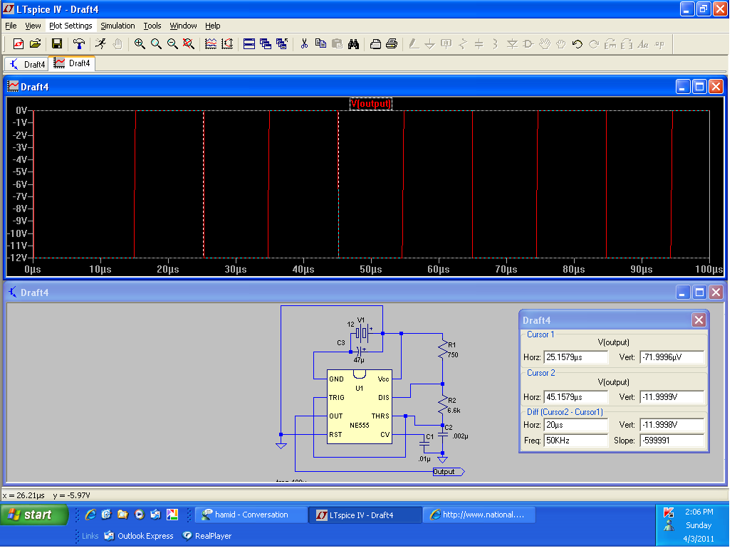

Hi Ronv,
Thanks a lot.
I notice your 555 simulation is set to 50K, will it be ok for 55.930K that all of my COILs are tuned to? I want to keep everything uniform, so that it is interchangeable.

If you put the pot in place of R2 you can adjust it for maximum output from the receiver.
I think your good to go. I guess I forgot to post-- You should also be able to put a pot between the output of your transistor amplifier and the comparitor to adjust the gain. maybe a 50k pot.

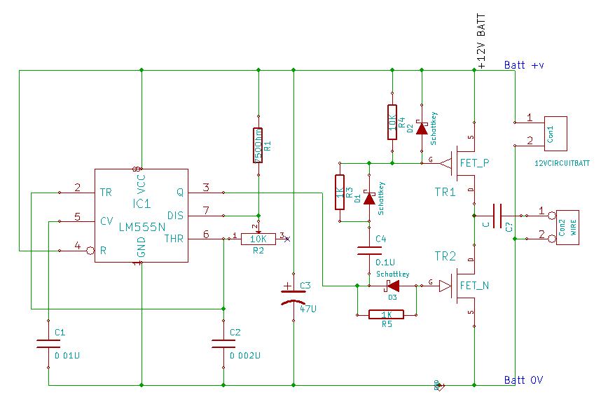

Hi Ronv,
If you get chance would you run your eye over my circuit (Attached) Especially the FET orientation.
I noticed a GND joined to 12V on your PNG, I didn't add this !?!?
Cheers.
If I had remembered to ground the battery it might have. :)
I'm surprised the timing is OK.
MMm that's interesting. So I presume the 'real' GND on the circuit also isn't connected.
What happens if you remove the offending GND and add a Battery GND, on your simulator?
Hi Ronv,
I made the circuit, lovely even square wave from the 555.
With NO WIRE connected, the PFET gets hot. This could be my circuit making skills!!! Or does it need a WIRE connected for the circuit to work properly?
I couldn't test it with a WIRE stretched out today.
Cheers.
With no wire they should be pretty cool. There is a little current during switching, but not much. You should see a 12 volt square wave at the output with or without the wire, but good to test without the wire first.
