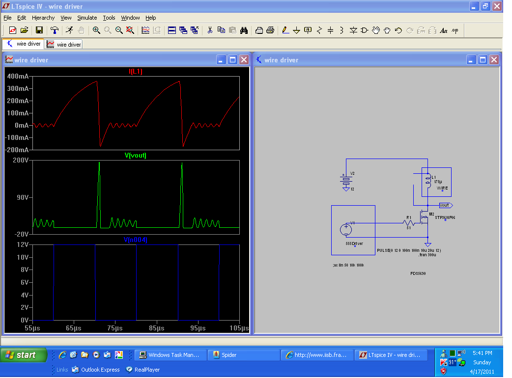

Hi Ronv, A bit of feedback:
NFET WIRE SIG GEN.
Test on the bench with 2Xseries 15ohm resistors instead of WIRE. And 2X parallel Schottkys instead of suggested diode, to be
ordered soon. = even Square at D-pin, NFET cool, tot current Circuit + Resistors 200mA, Diodes cool, Resistors hot.
Test with Long WIRE 27ohm = only bottom of square wave at D-pin visible, NFET tepid, Tot circuit + WIRE 100mA, Diodes cool, WIRE cool.
COIL CIRCUIT, with long WIRE +NFET SIG GEN. COIL 100mm above WIRE.
At Circuit output 100mV DC (Bit low I had hoped for up to 5V)
Using a spare COIL simply connected to Oscilloscope, COIL 100mm above WIRE = 50mV
So I'll do more tests, and check all of the COILs and Circuits.

Good, Just about there. Should be a nice square wave now and everything cool?
Your output should be about the same as the short wire was with the 555 driving it. Is it?
We should be able to increase it by adding another battery so that there is 24 volts going to the top of the wire. The 555 still needs to be at 12 volts. Lets see if this doubles the output.

I was puzzling about the first test I did on your circuit with the Diode incorrect. The square wave seemed to show only the 'bottom part of the wave', at the D pin, but there must have been some 12V part of the wave, for the COIL to 'see' How does this small 'top part of the wave' signal give a signal?
Without the diode the voltage due to the inductance of the wire makes the voltage go very high (few hundred volts) until the FET breaks down. There is still the same current flowing in the wire it's just not good for the FET. (see picture)

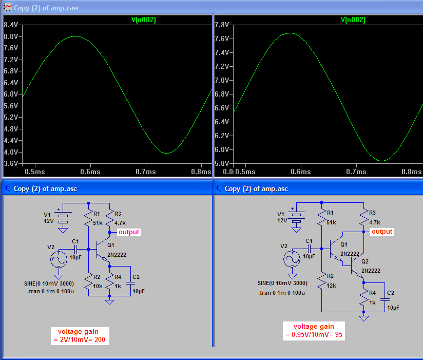

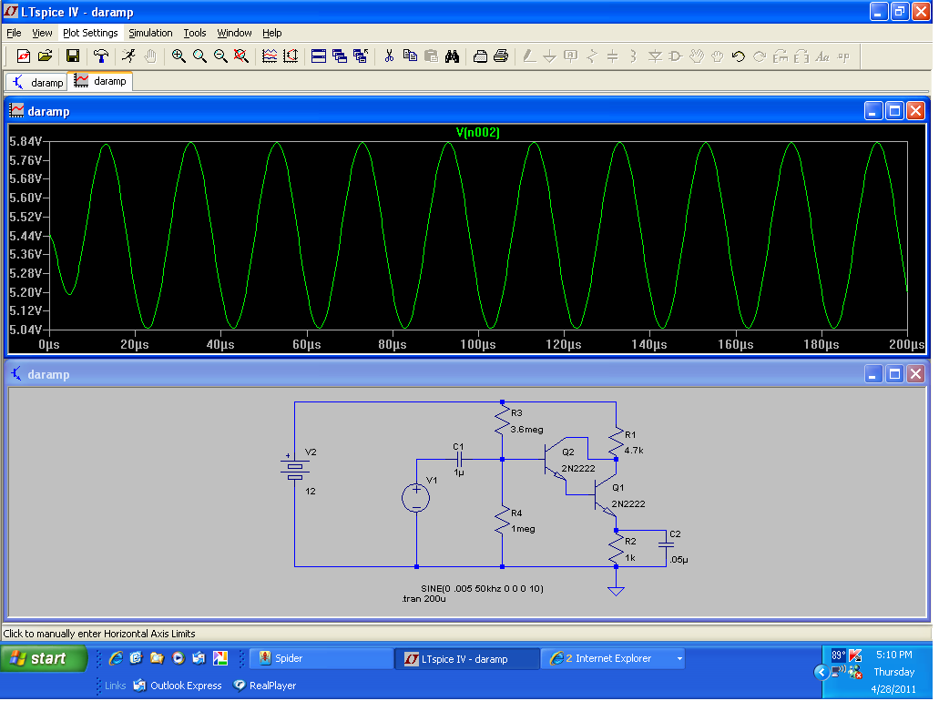

Many moons ago we were working with .1 volts minimum and 10 volts maximum - we didn't need any gain. now we are down to .01 volts to .05 volts.
Anyway, No we can't just add a couple of resistors. The fet amplifier has lots of current gain but little voltage gain. So maybe what we can do if you think you need more gain is switch the fet out with a darlington transistor. There will be some component changes but only one new resistor I think.
The 2 transistors in the simulation represent the darlington transistor. You can use something like a 2N6426 or another with a Hfe of 10,000 or so. You can adjust the gain by changing the cap in the emitter. Larger is higher gain, lower is lower gain.
Maybe you can post a schematic of what you have built?
The circuit I've built is as your suggestion #52. Then a 50K Pot was added between C3 and R1, in case of over load.
I know that a darlington has a very low input current so its input resistance is very high.
I simulated an ordinary transistor and a darlington that uses the same collector and emitter resistors. The gain of the darlington is half the gain of the ordinary transistor.
