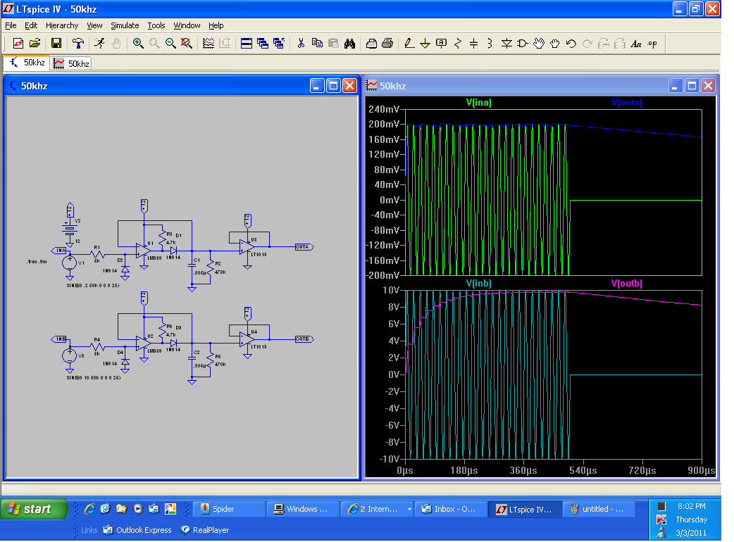

Peak Detector
Maybe something like this would work for you. The op amp still needs to be rail to rail for the .2 volt signal.
Not sure how accurate you need it to be.

Should be ok. You will need to divide the outputs by 2 to get the 10 volt level down for the PIC. Will you build the deadband into the PIC?

I can't quite see the component values on your schematic. Is D1-2 1N914 (I have 1N4001 and 1N4148) Is U1 LM339 and is U3LT1013 (I have LM324 LM358 TL081-2)
Thanks.
Rail to rail means the input can swing to ground and to Vcc without problems for the op amp. It also means the output can switch from ground to Vcc. The op amp must work with the input at only .2 volts and the output must go down to .2 volts. Your op amps are ok for this. Your op amps may be marginal with the 10 volt signal and the 12 volt power supply. Spec. is Vcc -2 volts.
The ground symbols are 0 volts.
I think you are building a servo with this circuit. You will need some band where the motor is not told to move otherwise it will always be seeking zero error and not being able to find it. I call this deadband. You should be able to do this with the PIC. If for example the A to D is within a few counts (lets say 10) don't drive the motor in either direction.
Bottom line... The circuit will probably be ok with your parts.

What I have already is: A 2X channel coil circuit, going through a PIC chip, and a cmos H bridge Motor Drive. The existing Coil circuit is the problem section. As an option I was quite happy to have a 'New Coil circuit' and add it to a 'new' analogue Servo circuit. The existing PIC chip has a good program for working with a stable Coil circuit and has a 'Deadband', and if your circuit is good, it will be fine with my existing circuit. P.S. it also copes with, if there is no Signal it stops the Motor drive.
With my existing Coil circuit, one of the problems I came across, that I was baffled with, it couldn't cope with the Input going more than 0.3V negative. I am an amateur, but read in the LM339 information PDF that it also suffers from the same problem. Does your circuit get round this problem?

I'll make a circuit, with what I've got. Also I have also ordered the components from your Schematic, my normal supplier has LM139 not LM339, I think it will be ok though. Let me know if definitely not.
