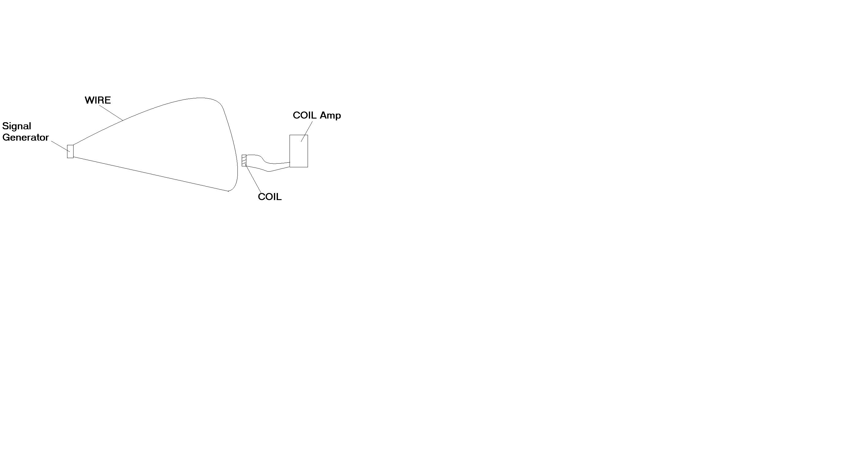

I'm still not clear. How many turns on the coil and what diameter? You talked about shorter wires. What does that mean? Is it just a single turn? Can you make a picture?
The bit we are talking about is like this: Attached.
The WIRE can be any length, the longest is perhaps 300 Yards/Mts. I measured 6-Ohm on the shortest WIRE and 27-ohm on the longest WIRE.
The COILs I wound myself from experiments about 300 turns, with a tuning Capacitor, 3/4 inch long 1/2 inch wide APP.
So basically all I need is to detect the WIRE by the COILs, the signal amplified and turned into as near 0V to 5V as possible (for A/D PIC inputs).

It focuses the COIL distance from the WIRE, in this case APP 100mm (4Inch) by giving an A/D signal to a PIC/Motor system which moves the COIL nearer or Further from the WIRE.
1/ and 2/ I don't understand the effects of Resistance Inductance.
The WIREs are never coiled up always stretched out in use.
I can use any Voltage, but lower is better (safer) for me. Also I don't want to get into special insulation if poss.
I assume there is a big loop of WIRE being fed from the high frequency signal.
Then there is a toy car or something that has a pickup COIL and amplifier that detects the magnetic field from the WIRE and the toy car drives toward the WIRE or drives away from the WIRE.

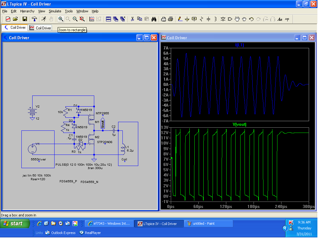

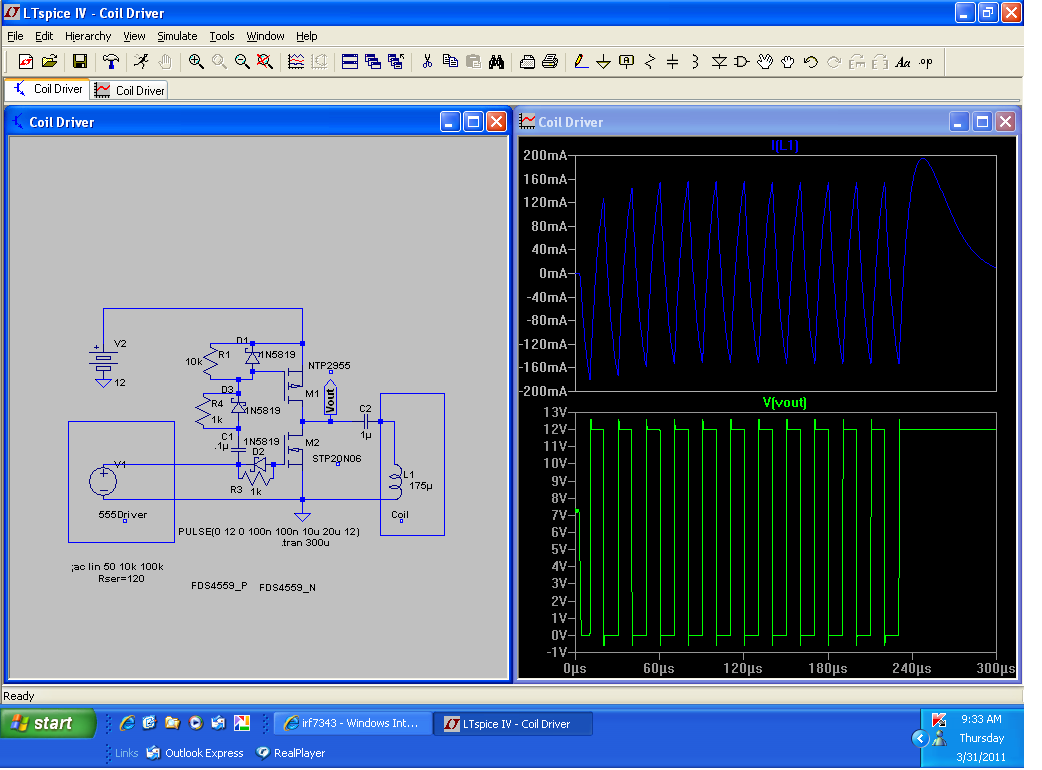

Wire driver
OK. Here we go.
I think your driver is a little to slow for your frequency, so here is one using FETs.
It is important that you use the FETs in the schematic or they may smoke.
The input to the driver should be from your 555 oscillator because the other circuit won't drive them. The 555 should also run on 12 volts.
The short wire should be at lease 10 meters and should be 24 gage. The wire may get to hot. I'm not sure. You will need a heatsink on the FETs.
This should give you an output from your coils for the long wire of about twice as much as the 555 circuit gave you on the short wire. Use 2 of your 470 nf caps in parallel for the output.
Hi Ronv,
Fantastic!
True the short WIRE is just for tests.
I assume that L1 is the WIRE, is this correct?
Thanks very much.
Yes, sorry I meant wire not coil.
PS. The parts are available at Mouser.com in the US.
I will look for the components in the Uk first. Would the STP36NF06L work as alternative to STP20N06, as I have a couple?
