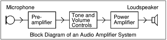

Dear all,
Thanks for your prompt and valuable response.
I want to use piezoelectric crystal here. I don't want to use any optical communication .
I am sharing simple block diagram in my mind.
Suppose I used the circuit as above and instead of loudspeaker I use piezoelectric crystal to transmit audio signal at the transmitter end.
Similarly at the receiver end I use Piezoelectric crystal to receive this signal and similar circuit as above to power the loud speaker.
Will it be ok or is there any wrong concept in it please guide me.
Thanks all...

Dear Sir,
Thank You for your response.
Sir I have some doubt.
1) Is modulation necessary or will it be done without modulation?
I have electret mic, amplifier circuit, speaker and piezoelectric crystal.
I assembled the mic, amplifier and speaker It is working in the room.
Now my plan is to assemble another same circuit and use one as transmitter and one as receiver. In transmitter circuit there will be piezoelectric crystal in place of speaker and at the receiver end there will be piezoelectric crystal in place of mic.
Will it be able to transmit and receive the signal?
If you have any block diagram or circuit diagram in your mind, Please share I will try it.
Thank you

Amplitude modulation of TX and Demodulation of Rx. is required.
Your concept wont work. More importantly the audio pickup , filtering and squelch (VOX) is essential, stated by Externet. A throat mic as used by jet pilots and ear buds is one option which I have used in an air suit where ambient noise is high which you will want to cut out of the transmission.
Also if you haven't read Crutschow's link do it next.
Modulation must be a more sophisticated single-sideband modulation, which transmits a single ultrasonic carrier signal to eliminate the reflection and multipath problems of AM.

You will have to use some modulation no matter what you do.
If you use ultrasound you could use amplitude modulation or frequency modulatiom, neither are particularly difficult, to get get noise reduction you could use a noise gate and a compressor/expander.
These days all this would probably be done digitally.
A piezo mic and a piezo speaker produce very squeaky sounds. A real throat mic produces vowels only and is difficult to understand its speech because important consonant sounds in speech are missing.

Yes, modulating the resonant frequency of that particular piezoelectric crystal is necessary.
A piezoelectric crystal has a very narrow range uncapable of emitting or receiving intelligible audio.
One of the ´You need...´ is a pool for testing, not a room.
Go head, keep building your receiver...
For unidirectional communicator, coarse transmitter 'block' diagram:
Voice mic--->preamp--->filtering--->modulator
Throat mic--->preamp--->vox--->oscillator--->power amp--->piezo element
Coarse receiver block diagram:
Piezo--->preamplifier--->filtering--->demodulator--->audio amp--->earphone*
*Forgot that one on the 'You need' list, also waterproof-depthproof.
In the transmitter or receiver, if the "speaker" can be heard by the microphone then you will have acoustical feedback howling because a sound will go around and around and around and around.
