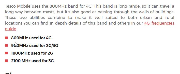

The polarisation of the aerial needs to be the same as the transmitter, this is less critical at uhf, and I assume the 900 means 900mhz.
Not sure which frequency is being used, seems the Sim900 uses 2G, so at could be 900mhz or 1800 mhz with a Tesco Sim.
