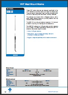

What is the construction of the Vhf MME-101 or similar and how do they go about making this type of aerial.
Where do you begin to build and the process to achieve the working aerial
i can't find an MME-101 on the web.... who makes it?
it seems their web server is on the fritz. i keep getting a 505 server error on their page.
Here is a Print screen of the aerial if you have trouble seeing the print screen let me know and I will post the photo in sections.

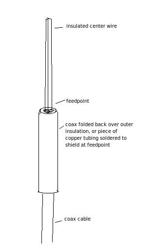

ok, after a little poking around on their web page, i was finally able to get to the home page which (unlike the rest of their site) seems to be at least partially working. i was able to get a copy of their antenna catalog. the antenna you're asking about is a coaxial dipole.. a simple (well, sort of.. depends on the length, because as you'll see, making one is a bit problematic with frequencies lower than about 75Mhz) to make antenna. the simplest way to make one is to take a piece of coax, and strip the insulation off for about 10% longer than a quarter wavelength. then the shield braid is squeezed down the outside of the insulation, leaving an insulated center wire and a quarter wave or so piece of coax with the braid folded back over the insulation. the braid and the center wire are then trimmed to exactly 1/4λ (which is why it was cut 10% long, you lose braid length as it's folded back over the insulation because of it's increased diameter). the hard part is folding the braid back over the insulation because it has to be done a little at a time or the braid will get tangled with itself. a simpler way to make one is to get a piece of copper tubing a little bit larger inner diameter than the diameter of the coax, and cut the braid off leaving enough to solder to. strip off 1/4λ of insulation and braid leaving the insulated center conductor. slide the 1/4λ copper tubing over the coax and solder it to the braid. where the coax is stripped and the braid is joined to the braid, becomes the feedpoint, and the coax goes back down through the tubing back to the radio. the whole thing can be housed in PVC pipe or a fiberglass tube.

Thank you I will try this out and let you know.
What size coax should I use any one will do ?
The frequency range is 156 to 163 MHz VHF
Greg
rg-58 is usually pretty easy to work with.... rg-8 is larger and will hold it's "shape" better in a PVC pipe. 75 ohm catv (rg-59) cable is cheaper and will work, but usually has a layer of foil stuck to the inner insulation which is a pain to strip off of the insulation, but the braid is easier to fold back, and the 75 ohm cable impedance presents a slight mismatch to a 50 ohm radio (although if the antenna is matched, the mismatched cable will still generally be less than 2:1 SWR, which is not great, but not bad (anything over 3:1 is usually not well liked by the radio)
