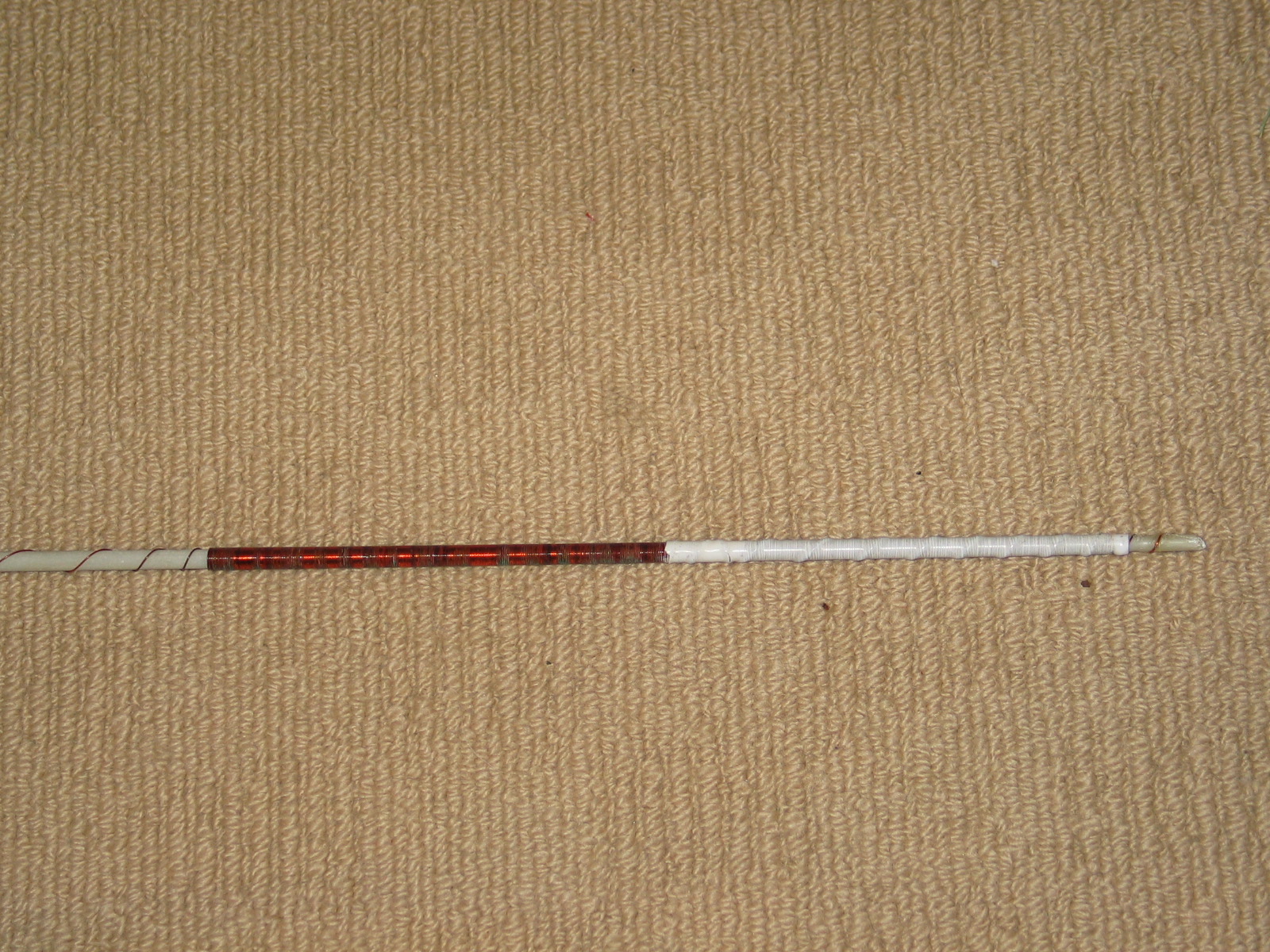

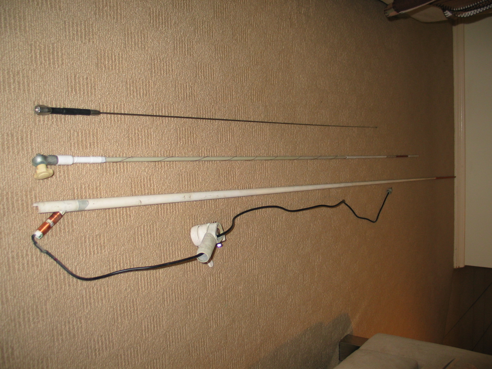

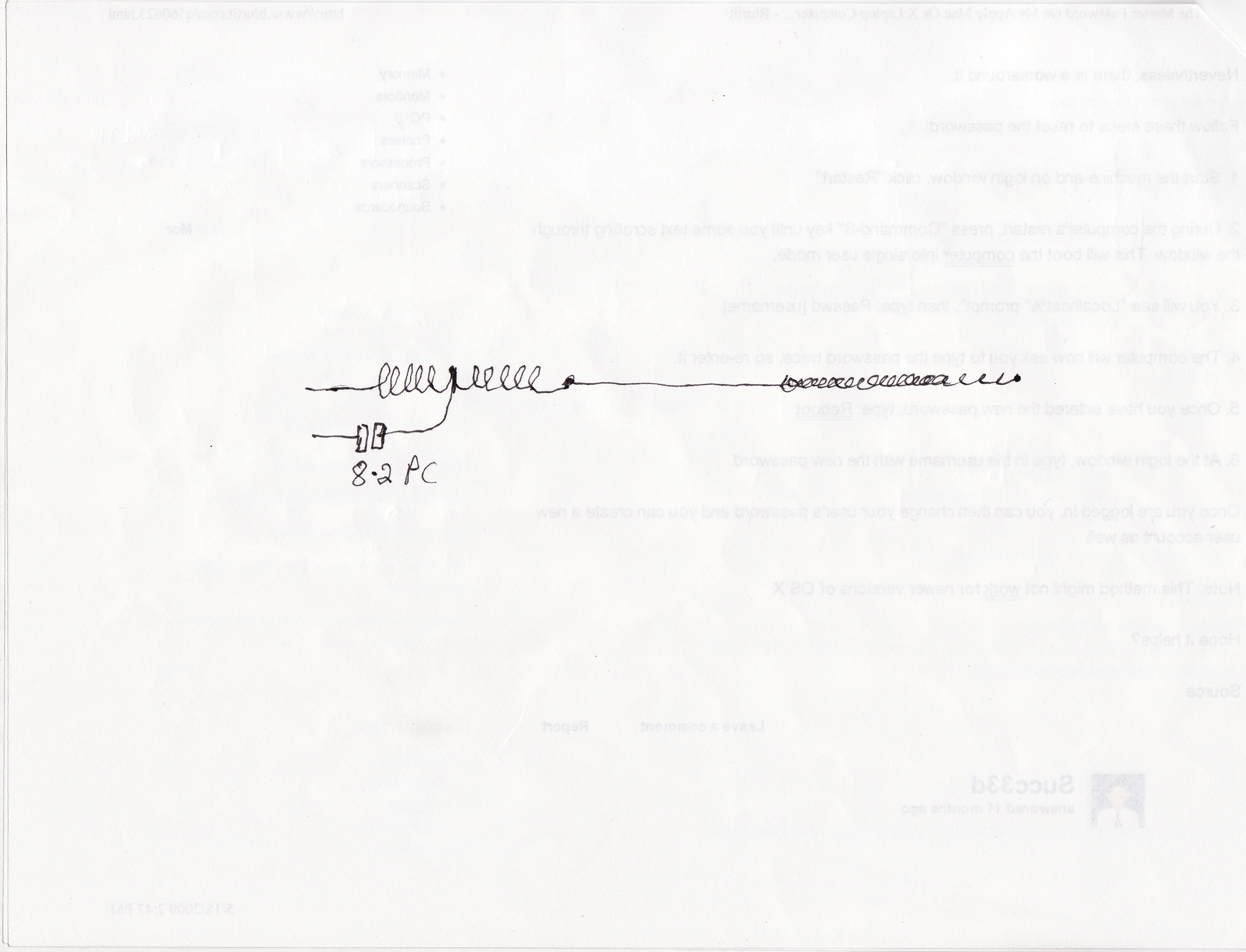

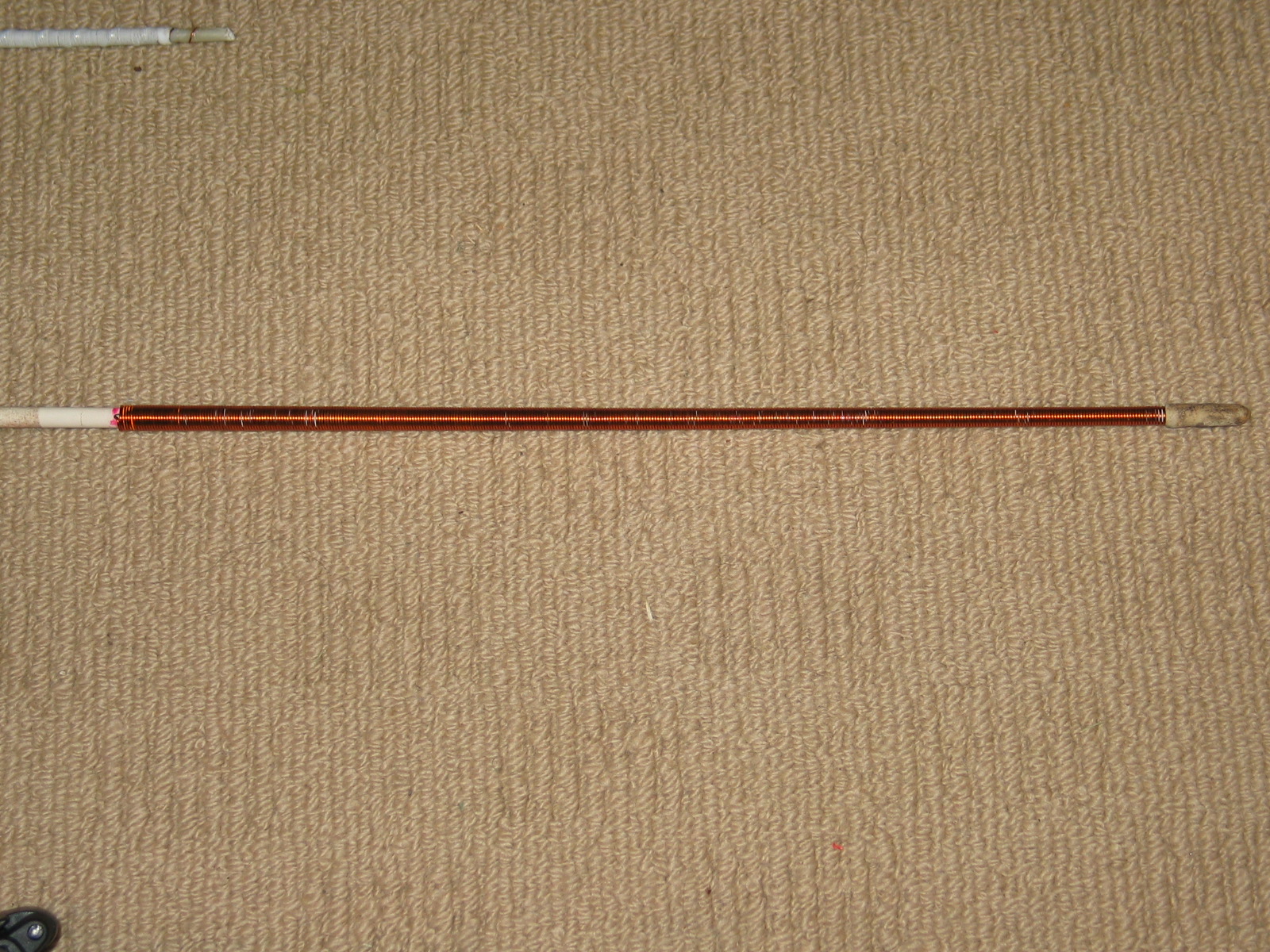

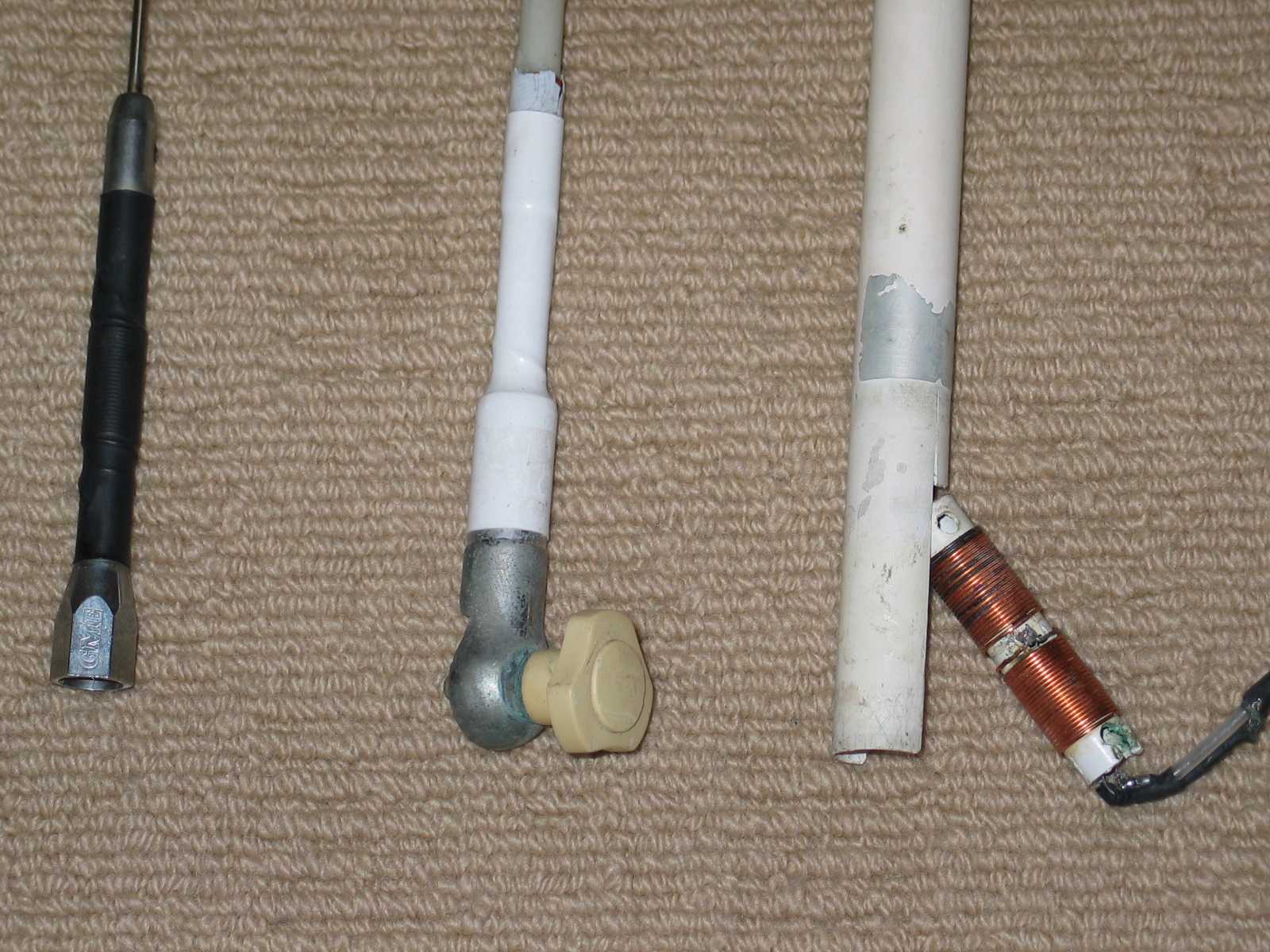

I have photo's of the three aerial's The longest aerial is 2.360 ,
the middle one is 1.750 and the solid wire is 1.310 Meters long an I have photo's of the base area of the aerial's. I have placed a sketch of the long aerial to show what is at the base
I hope this helps.

In my opinion these are antennas designed for use on a vehicle and for frequencies somewhere in the range of 2 to 30 MHz. Amateur HF comes to mind, and perhaps CB 27Mhz. It is difficult to say exactly what frequency bands though. In general, the longer the antenna and the greater the number of turns of wire, the lower the frequency. That long one with the many many turns of wire seems to be for the lowest frequency (perhaps 14 or 7 MHz?). When we see the coil pitch change dramatically in a short distance, this might indicate a design for multiple bands.
OK, here goes with some inspired guess work!
All the antennas are for 27Mhz CB.
They were all made be "GME", (the black one certainly was).
The black one was intended to mount on a road vehicle.
The white ones were intended to mount on boats.
The white ones are loaded to present a high impedance feed point to minimise the loss due to being fitted to a fibreglass boat.
As a general rule a monopole antenna needs a conductive ground plane to work against, in a metal bodied vehicle this is easy, the bodywork is idea. A fibreglass boat? difficult unless the boatbuiler made special provision by incorporating a conductive mesh or whatever when he built it.
The longer white antenna has a built-in matching circuit to provide a 50ohm feed to the radio. This antenna looks fit for the scrap bin!
The shorter white antenna probably has the matching unit in the base and is useless without it.
To run a meaningfull test on any of these antennas would require the mounting/matching base, suitably mounted on something representative of the normal working location.
As for the test equipment to use, an antenna analyser would be favourite, a cheaper solution would be a 27Mhz CB radio and a VSWR meter.
