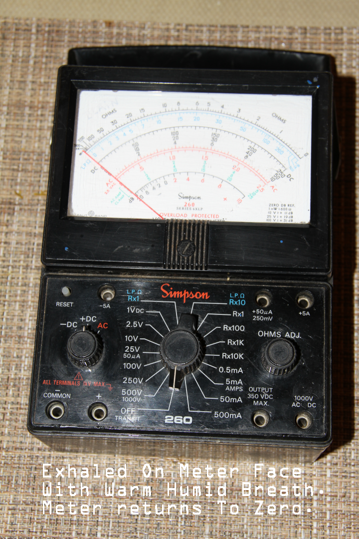

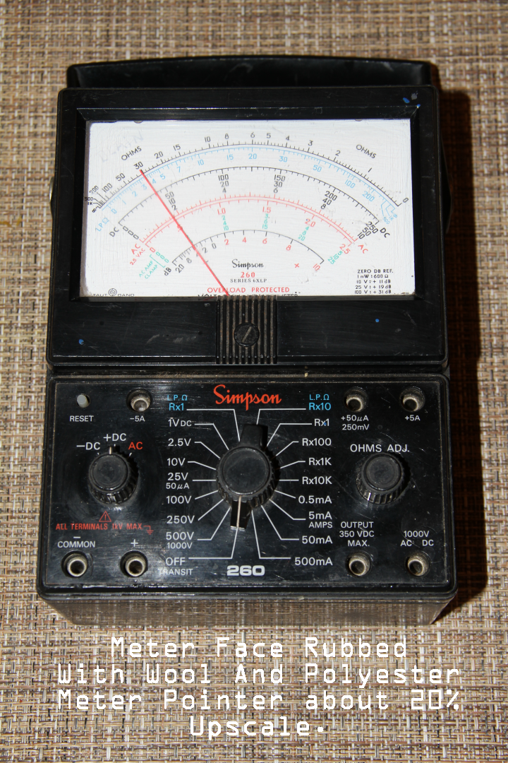

I guess I could drag one of my old Simpson 260 meters up and brush it with a wool sweater. Then simply exhale on the meter plastic face and see how my warm moist (humid) breath. The Simpson 260 has 50 uA meter movement and 20K Ohm / Volt sensitivity. No it is not an old wives tale. More than once I removed a static charge from the face plate of an analog meter. This was before clothes dryer anti-static sheets were popular. There were also anti-static pump spray solutions used on these meters.

Here you go, I just dug out one of the old Simpson meters I have. Wearing a part wool part I don't know what long sleeve shirt I brushed my shirt sleeve over the meter face a few times. The before is about a 20% upscale as a result of static charge. I gently exhaled on that meter and in about 15 seconds had a nice zero. Another interesting fact is how these meter movements were actually balanced with tiny weights and counter weights on the needle. The meter, when properly mechanically zeroed should maintain a zero regardless of how the meter is positioned.
