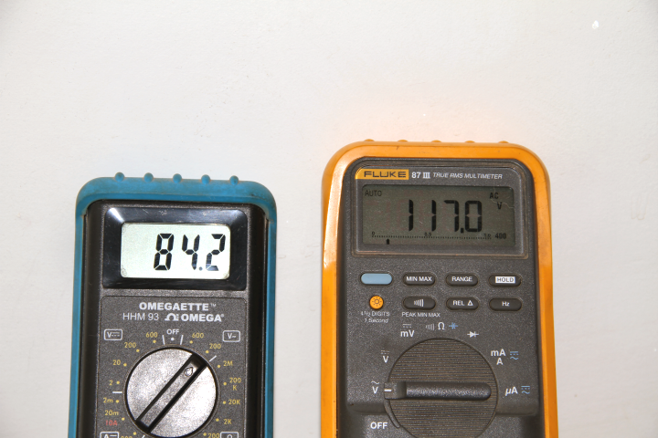

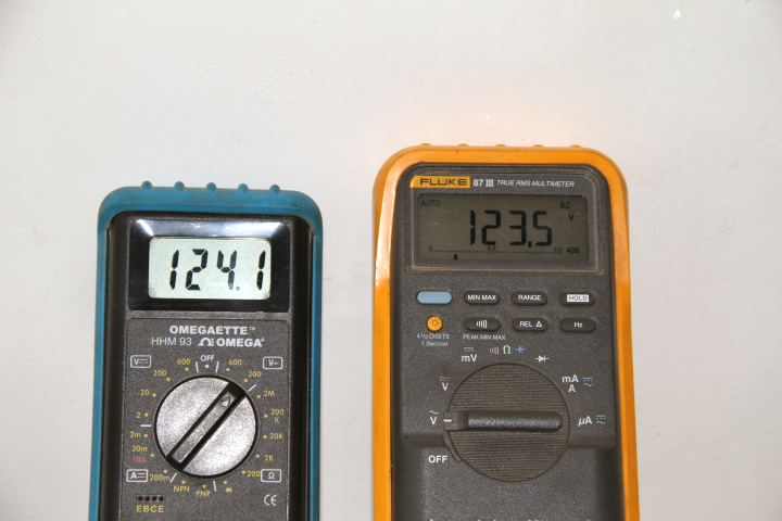

Some of what you are asking depends not only on the meter used but also on the inverter output signal. Inverters, depending on design may output a MSW (Modified Sine Wave) or a TSW (True Sine Wave) as well as a few other waveforms.
Most low cost handheld multimeters are Average Responding RMS Indicating while the better units are True RMS Responding. In the below image both meters are measuring a true sine wave.
The same two meters measuring a Inverter modified sine wave.

Almost all of the older VTVMs like HealthKit and similar were average responding RMS indicating designs. In the above image both meters are measuring the same signal at 60 Hz.
