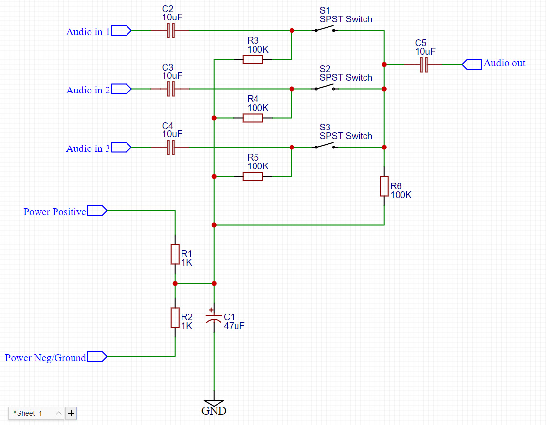

I would like a advice on how to filter out the DC analog signal that comes out from analog multiplexer. It contains noice kind of spike. I very much appreciated if you could reply me back soon as possible. Thank you
Do you have a scope capoture of spike waveform ? If its real
narrow a LPF sill help remove it. But what is signal into mux,
range of frequencies ? Can you show a scope capture of normal
signal with spike ?
So a series cap with above low pass filter, at ist input, will remove DC.
The filter the spike.....
The simplest way to eliminate switching spikes or glitches is to bias all the signals to the same DC level around the multiplexer.
eg. This is an example I did for another user, but the exact same principle applies with a multiplexer; consider the three switches as a three way multiplexer & adjust the number of input bias caps and resistors to suit.
