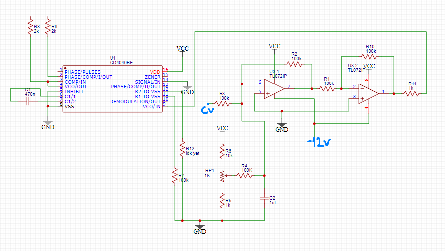

Also: "-A LFO for modulating the delay clock. This also requires some sort of circuit that allows the slowly varying voltage from the LFO to influence the timing of the delay clock. Once this is in place, the effect can go from being "just a delay" to also having flange/chorus/vibrato ability." I have an voltage controlled LFO. If I can use a VCO for the clock like CD4046 can I achieve those effects. Can I use an existing VCO based around CD40106 and just invert the output for clock. If I can I may just build a board to connect to me triple VCO (it even has 3 unused gates of the CD40106) and it would be awesome.

This may not be important to you now, but when I saw capacitor C2 going from the inverting input of op amp U3.1 to GND, it raised a red flag. This capacitor causes a huge peak in the gain of the amp at around 3kHz - just the opposite of what you want. Put a cap across R2 if you want to filter input noise.
This may not be important to you now, but when I saw capacitor C2 going from the inverting input of op amp U3.1 to GND, it raised a red flag. This capacitor causes a huge peak in the gain of the amp at around 3kHz - just the opposite of what you want. Put a cap across R2 if you want to filter input noise.View attachment 139399
Didn't know a decoupling capacitor to stabilize the voltage divider output could effect frequency response like that. Wouldn't putting a capacitor across R2 decrease high frequency gain. In this case it makes sense since it is only used to add voltages and we don't want high freq ac. If I put C2 across the RP1 to ground instead of R4 to ground I think it would also fix the issue.
