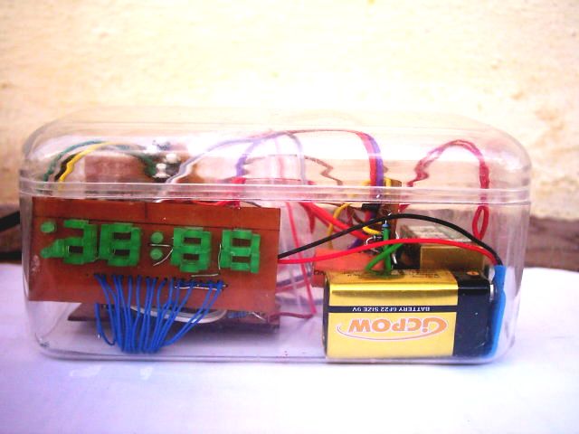

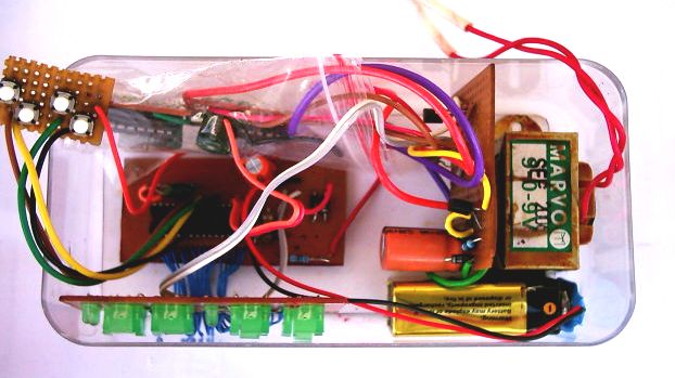

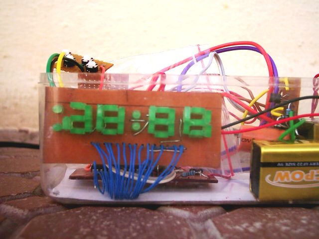

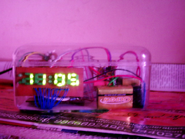

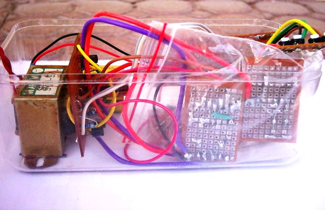

Hello Friends !
here are my Project Pics which i'd like to share with you all! :D
bye
Arun
