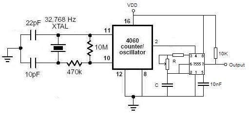

Here's an idea.
Use a high stabality capacitor for C and trim R to exactly 120Hz using a frequency counter to monitor the frequency.
The CD4060 produces a 4Hz squarewave, resetting the 7555 every 15 pulses so if it's slightly out it will remain as accurate as the crystal. Providing the astable 555 doesn't go to far out of cal it couldn't effect the clock.

However, I continue to face some hiccups. I want to generate a very stable 50Hz or a 60Hz signal using a crystal and a single IC. (Thus i dont want to use the Resistor / capacitor based oscillator)
I did some google, but could not get anything helpful. I browsed website of some of the crystal manufactures to enlist all the frequencies of the crystals available. To my surprise, I have not been able to find a single crystal frequency that could be divided by a counter and give a accurate 50Hz or 60Hz signal.
I am attaching an xls sheet for your reference.
Any clues ? Am I doing the right thing ?
Note : 1.6384Mhz is the only frequency that gives 50hz, but i am not able to find here in local stores and also google gives very less references.. looks like its a very uncommon frequency

Of course a 3.2768MHz crystal can be divided by 65536 to get 50Hz.
Use a CD4060 followed by another flip-flip or if you can find a counter and oscillator IC with a 16-bit counter then go for it.
Of course your clock might actually use 100Hz because it's the output from the rectifier so the additional flip-flop might not be required.
