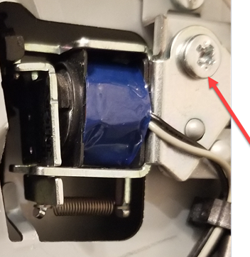

Here is the view of the actuator arm showing the single screw that should be removed to easily access the pads.

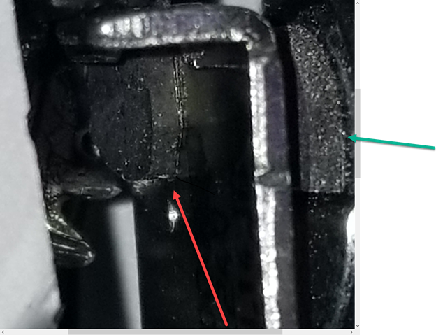

Here is a view of the new pad to the left and the original pad to the right of the actuator arm
120811
Red arrow new pad. Green arrow the original pad that did not need to be replaced. Note that I tried to closely match the thickness of the remaining pad.

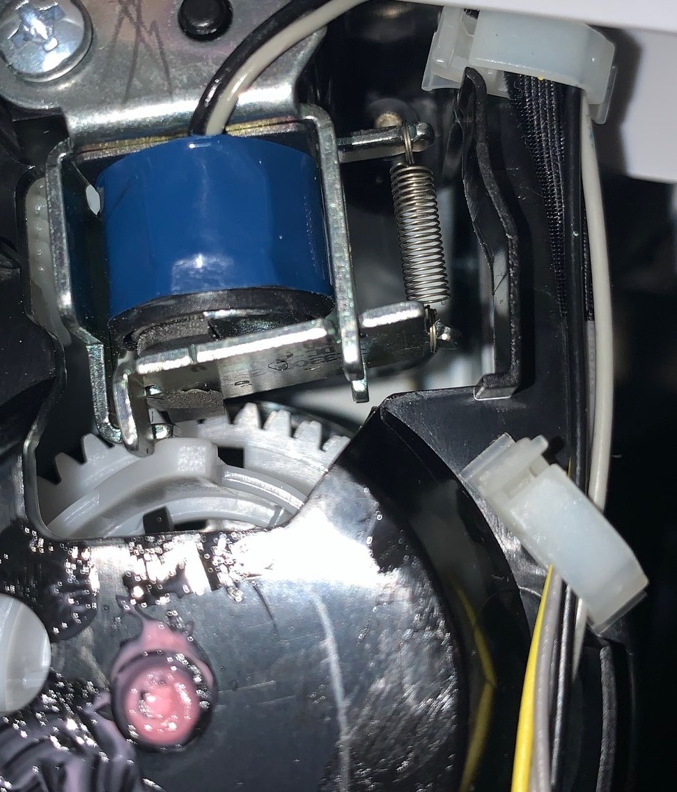

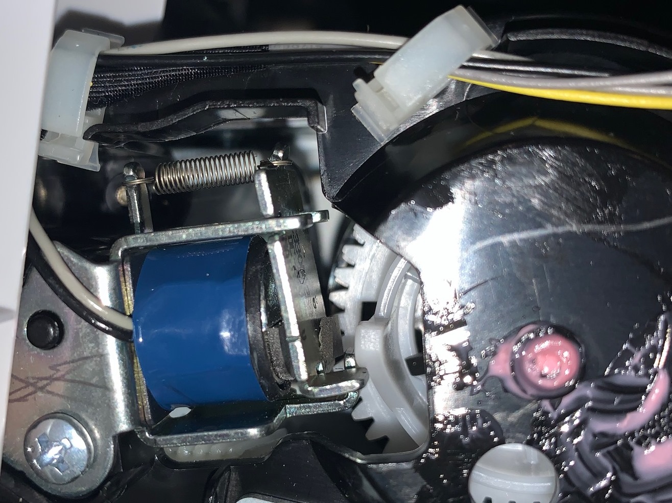

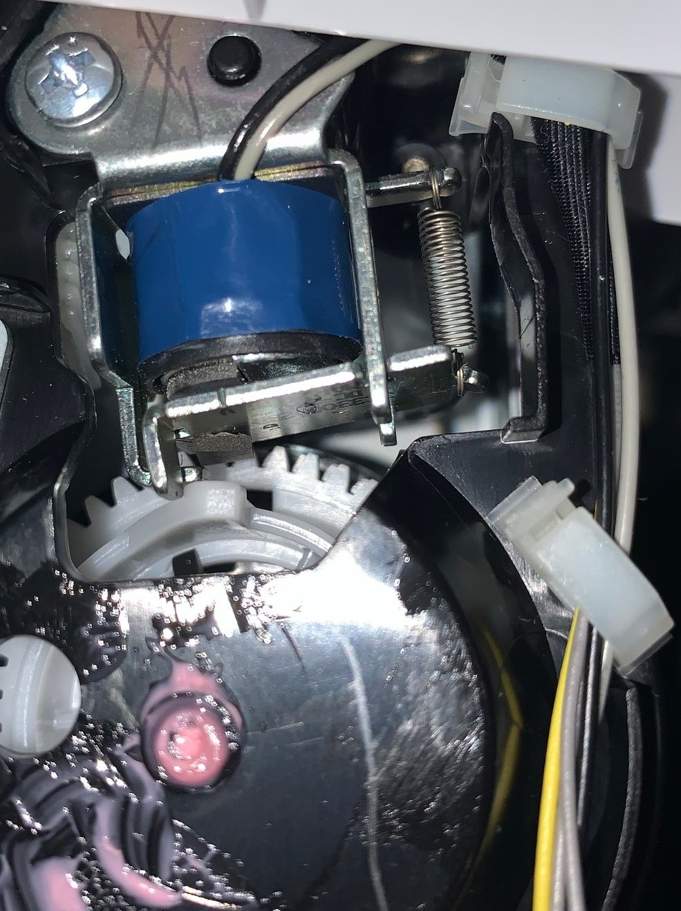

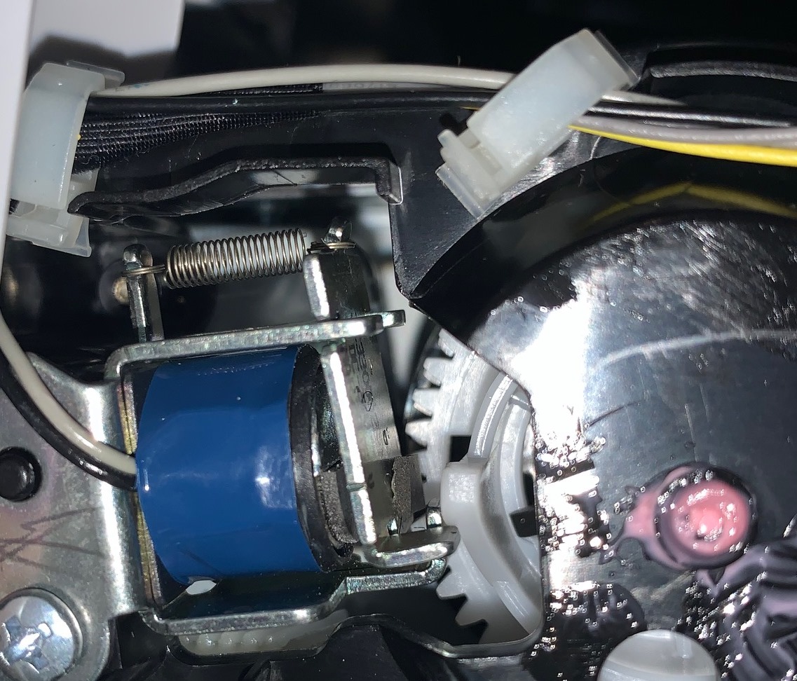

Hello Pommie, can you look at the posted images from my Samsung and see if what adjustment it may call for to remove the error message? I did try to move the tape with a screwdriver but only succeeded in removing some tape glue at the top it didn't seem to have moved in the first place.

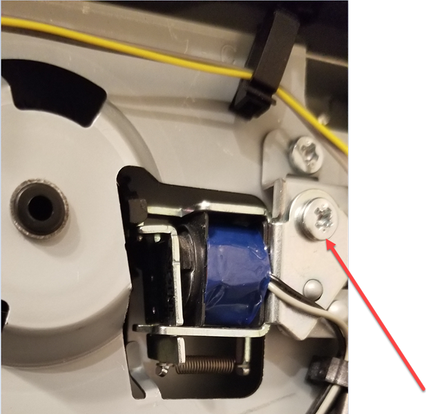

Hello Mike, I have a different model machine, but did the new pad went on the inside (right-side of the image) of the inverted '' shaped metal or on the outside left- side)?

Apparently, your pad is slipping, You might try Scotch 90. Multiple coats. Dry till tacky between coats.
It's a spray adhesive. so spray on some sacrificial paper and apply wit a Q-tip. It's important to do the multiple coats and dry process.

I took Mike's advice and stuck a piece of tape over the foam piece he identified and made sure the motor rotated freely during startup. Looks like that did the trick. Thank you!
