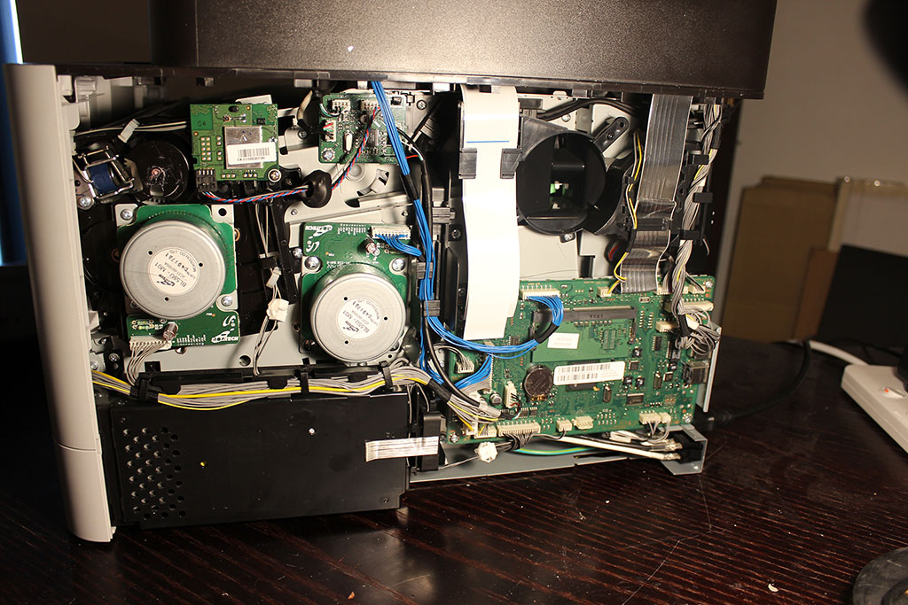

I have a Samsung C1860FW multifunction colour laser and yesterday it errored with error A1-4111 - Actuator Motor Failure.
Check manual and removed the right hand cover ( to remove unscrew 4 screw, two at the back and two at the front and slide it backwards - the manual just says "Remove right cover"!!!). Found this,
I identified the broken bit from an internet post that indicated it was the blue relay type thing in the top left corner. I found that if I "helped" this relay during the switch on sequence the error went away.

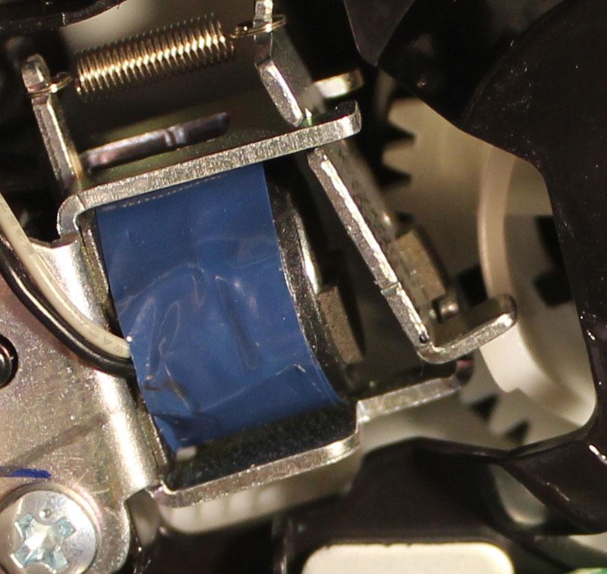

I then noticed the foam pads on the relay, one on the coil and one on the actuator arm.
Notice that the one on the top of the actuator is not under the stop. These appear to be small self adhesive pads that can slide around and mine had sliden away from the stop.
A little shoving with a screw driver moved it back where it belonged under the stop.

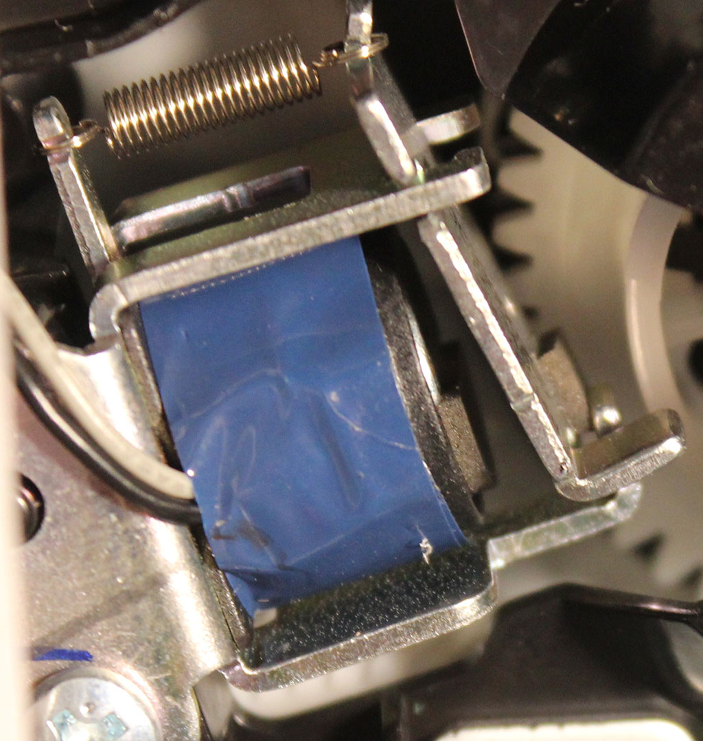

And Voila, all fixed.

I had a similar problem where the pad had gone sticky. Not a foam pad like yours, a much thinner one. Replaced it with a bit of tape. Worked fine ever since. That solenoid should have a sibling somewhere, probably yellow. I think they control the timing of when the paper goes through, pretty important job, so first place to look if print is high or low on the page.
Thanks for your help Pommie, could you please put an arrow on the picture? Because I have the same problem, but I don't understand what you moved in your fix
It's the little foam pad that should sit under the metal stop but moves along.
I've circled it above. If you compare that to the above "before" photo you will see the difference.

hmmm... i hate to say it, but it looks as if the foam pad was either a "fix" for a problem discovered after production began, or to save assembly time (applying the foam pad takes less time than adjusting the stop). they could have used a solid rubber pad there, but used foam which will wear out (foam pads tend to crumble after several years). the foam pad on the face of the solenoid coil suggests the foam was originally a noise reduction measure
