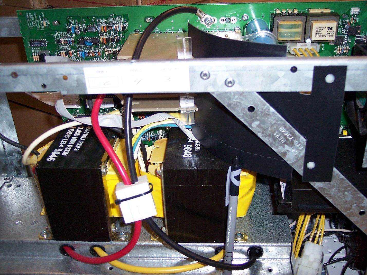

I will get you one tonight. Thanks :)
The weird thing about it, is what appears to be the primar winding is connected to the heatsink(a sheet of metal) that the voltage regulators are connect to.
Sorry it took so long, but here is the pic. I put a ballpoint pen next to it so you can get a size reference.

This is an old version of UPS. The two transformers are 60 Hz (or 50 Hz if Europe) which are good to salvage. You may find some rectifier diodes used for charging mode. There will be some power transistors, likely MOSFET's used for and H-bridge for generating the modified sinewave. The rest of the electronics if for sensing of A.C. and charging control. You may find a 24v DC power relay for making the AC crossover from mains to UPS output.
New version UPS's use high frequency switching circuitry for DC boost. They are much lighter weight as they use small high frequency ferrite transformers.
I have very similar transformers from a UPS. You say they are for the output side, as in, take the 24V modified sine wave in, and transform it to mains level? Thus it would be possible to use them in reverse for very high rated linear supplies, taking 120V wall in and 24V out?
I had always figured they were input transformers for taking the 120V wall down to battery level for charging, but it makes much more sense that they are outputs. The UPS I scavenged them from was something like 3000VA, so they are massive transformers.
As far as discharging the caps - look at the capacitance rating on them. It is probably in the 1000's of microfarads. Just pick a resistor that won't dissipate them too fast, but not too slow either. And make it a high enough power resistor. 1kohm, 10W for safety, or the 10ohm 10W suggestion made before, depending on size and voltage of the caps. They should be discharged quite a bit by the time you get to them.

I'm sorry, so what are they? Step-down or Step-up?
Also why are the transformer coils connected to the heatsinks(with wires) that the voltage regulators are attached to?
They are used in a step up application here. But technically transformers are bidirectional. If you apply line voltage to what was the output it them becomes a step down transformer.
Most likely they have the leads attached to the heat sinks because of the type of switching system they use. Its normal in many UPS designs.

I should be able to use them as linear transformers though? Connect them right to mains?
I think it should work just fine but be aware that your output voltages will be lower than what they originally used as an input voltage when used in the inverter.
But being designed for inverter use your going to have some super reserve capacity if you need to ever overload them!;)
