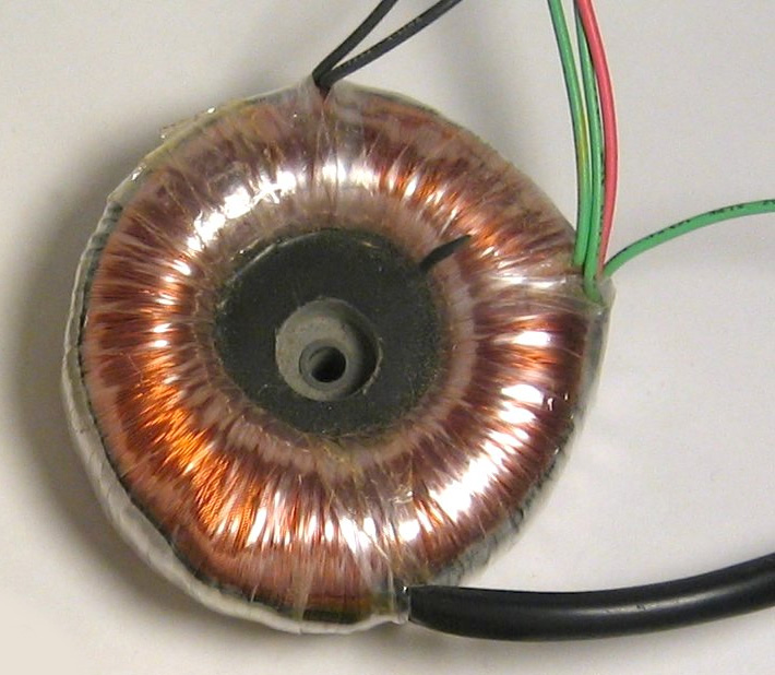

Small, toroidal inductors can be wrapped very crudely and still perform surprisingly well. Just make sure to use magnet wire when you wind. I would recommend a bobbin to hold the toroid when you mount it on the PCB and use a foam adhesive to suppress any physical vibrations that can develop from magnetostriction when pushing at core with high magnetic fluxes.

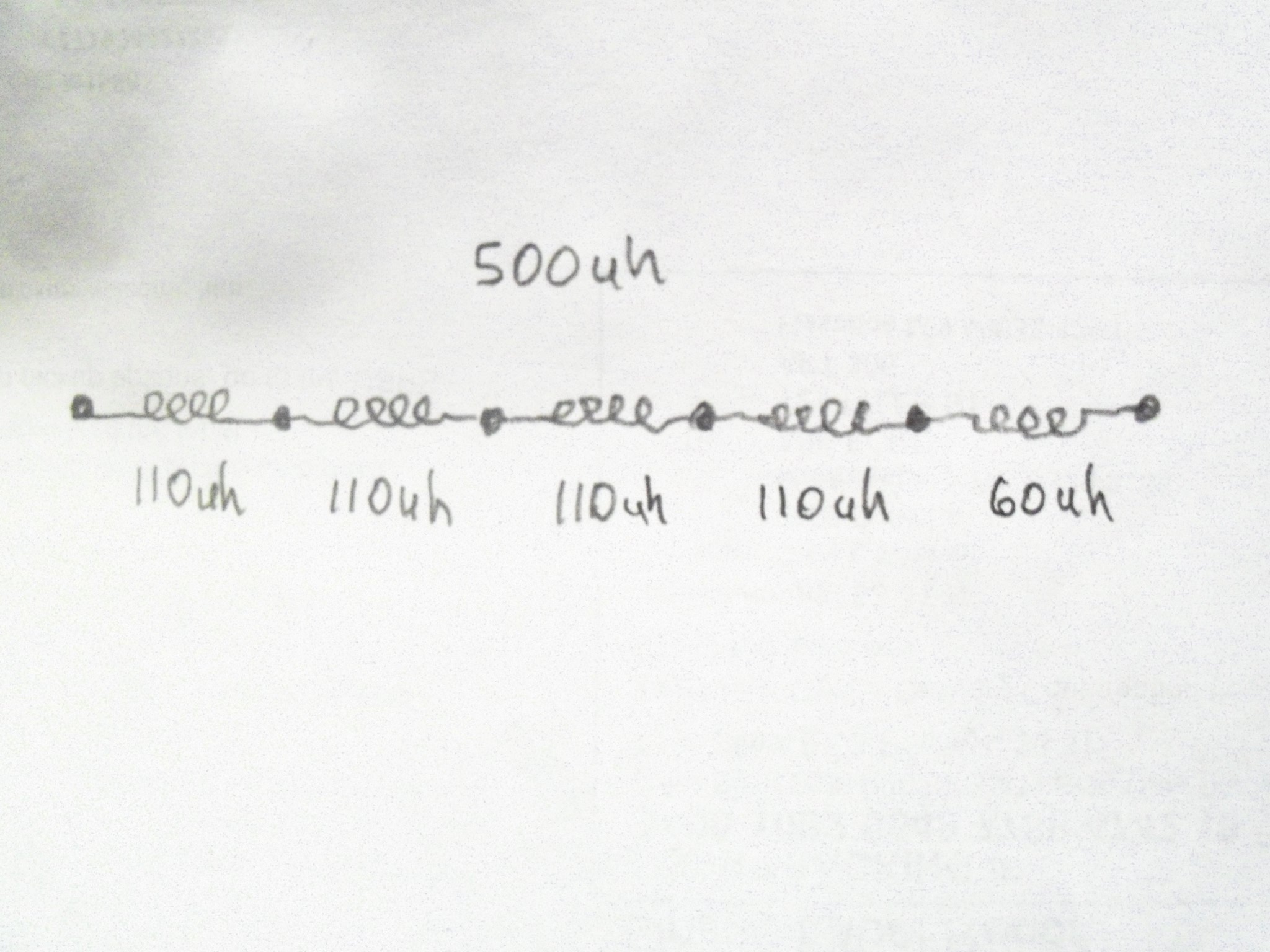

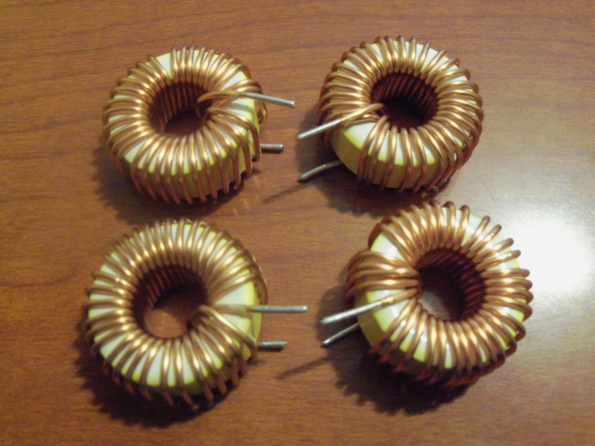

4 inductors from Australia. Time to test them with my meter. 5 inductions in series works better than before. Nothing is over heating.
What is the best way to mount inductor toroids so the magnetic fields do not interfere with each other?
If they are toroids, there is no external magnetic field so, in theory, it doesn't matter.
Coupling will be maximum when parallel < OD range
What?
There is no external magnetic field around a toroid inductor. That is the key benefit of taking the time, effort and odd equipment to wind wires through the hole of a donut. Known as total magnetic field confinement.

Yes very little B field escapes the torroid, but to say there is none is false.

Will it affect your application?
Probably not unless designed to sense crosstalk of small changes in inductance but may add or subtract (if reversed) some amount unlike parallel coils like a solenoid not wound like a toroid.

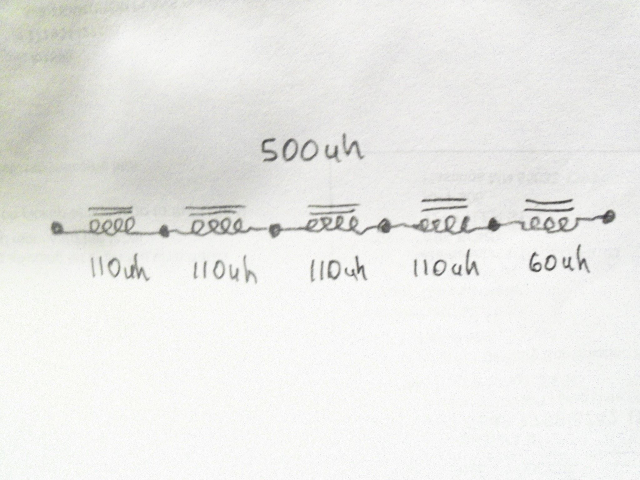

I forgot to draw the lines on the drawing that indicates metal core. Here is new drawing. Is this the correct way to make toroid inductor drawings?
