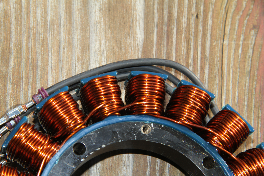

Below is an image of an 18 pole stator. Notice the cores are laminations and not solid. The reason for laminations are as shortbus just mentioned. This is a 30 Amp stator assembly. Magnets rotate around the stator coils and the coils are wound opposing. That means each coil in the rotation is wound in the opposite direction of the previous coil.
This is a 30 amp 3 phase stator but you should get the idea.

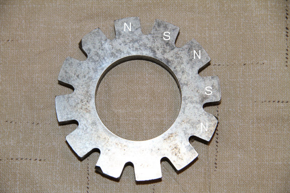

Here is an example of a magnet which could be rotated. The poles alternate N, S, N, S, and so on.
So on a stator if you want alternating magnetic poles you don't turn poles on and off you simply wind the coils in alternating directions.

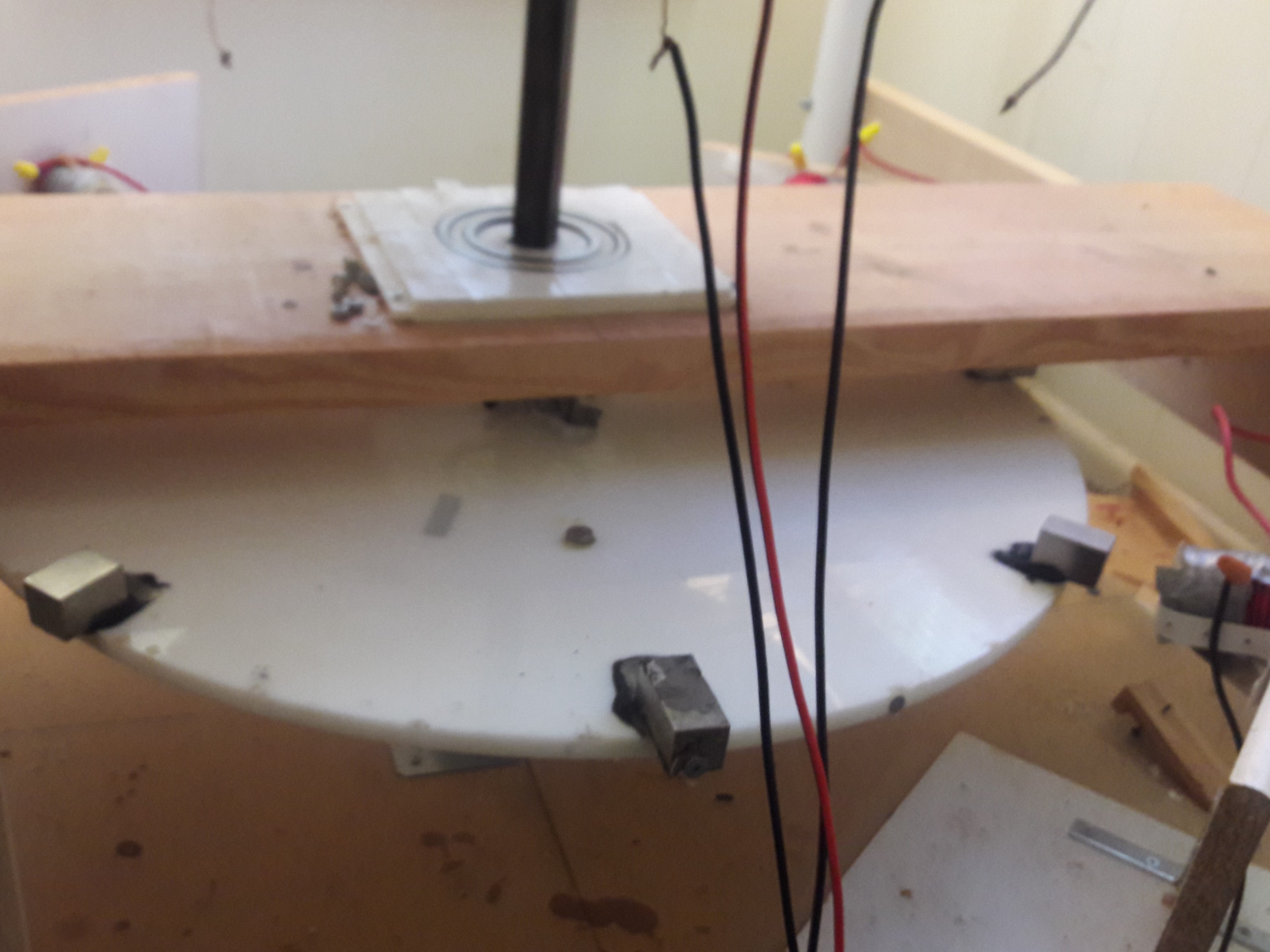

This is the 3 electromagnets with 4th space for a sensor (north pole) to turn on as each of the 8 magnets pass the coils. DC current will make the coils north pole, will push permanent magnets away.
Sorry, thought pic may help.
You seem to be missing the point in this, motors don't just use a single pole to make them rotate. Like Ron said the PM (permanent magnet) poles alternate, N-S-N-S and so on. The solenoids(electromagnets) are situated opposite each other. When a N PM is lined up on one side a S PM is on the other, and the solenoids are made to be similar poles this pushes the PM away and the rotor rotates.

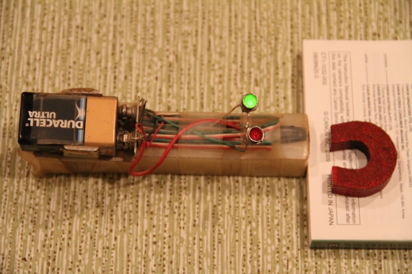

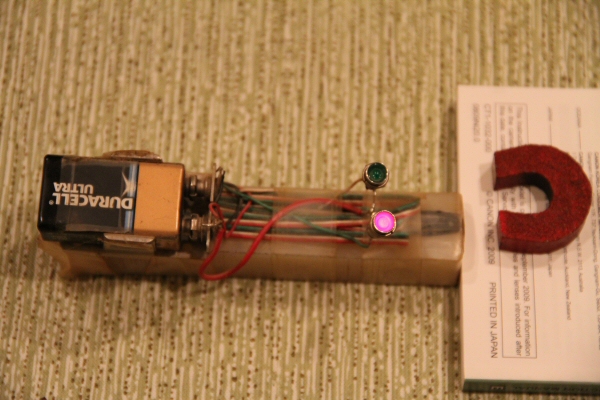

Below is a hall effect sensor circuit I made years ago. I forget the sensor part number but recall it was Allegro manufacture. It also had 4 leads, Vcc (power) Gnd (ground) and an output for both North and South pole.
Mounted on a piece of nylon the green LED indicates North and the red LED indicates South.
Back to the hall effect sensor. In the last thread I provided a link as to the different types of hall sensors, they all behave differently. I would look for a 3 lead SIP (Single Inline Package) type which has an output go high when a North Pole field is present since that seems to be what you want. I would use the output to turn on a MOSFET to power your coil. This is just based on what you have posted. Choose your hall sensor based in part on magnetic sensitivity thresholds, and polarity. Since you want a North polarity decide sensitivity (distance at which the output changes state) and if you want an active High or Low output. Remember what was mentioned about inductive kick and the need for flyback diodes across the coils.
