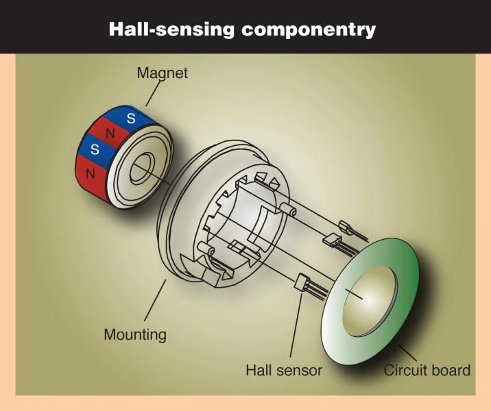

I think that the motors use quadrature encoders where each encoder outputs two signals. Please correct me if I'm wrong. This link might be helpful here: https://www.dynapar.com/technology/encoder_basics/quadrature_encoder/ .
But I'm confused about the number of poles being used by the disc of this magnetic hall effect sensor. Is this encoder using 4-pole magnetic disc? (2- pole would mean one north pole and one south pole).
Thanks.
I think it may have rather more poles than that?
The specs say 90 RPM out, via a 48:1 reduction. That's 72 revolutions per second for the motor itself, at nominal speed.
The scope displays show a square wave frequency from the encoder of around 890Hz, which indicates around 12 pole pairs.
If that is the actual motor rather than a generic quadrature display.
I cannot see any specification for the encoder pole or line count in that data.

This is how I understand it. The section in green is hall effect encoder. The section in green is microcontroller with its internal resistor. The dot in red shows the connection between hall effect encoder and microcontroller pin.
M1 would get turned on/off depending upon if the hall sensor comes across north pole or south pole repectively.
The instruction "INPUT_PULLUP" notifies the microcontroller that an internal pull up resistor needs to be connected to its pin.

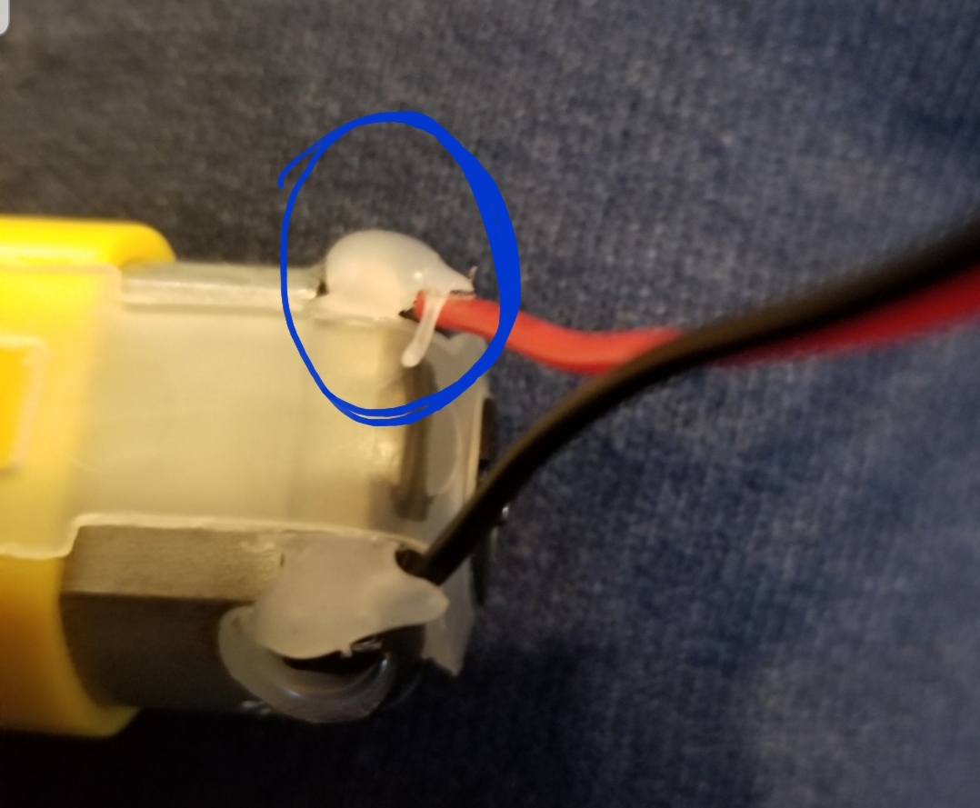

What is that gluey material called? I have circled it in the attached picture. Thank you for the help.
yes, it is hot melt glue. The hot melt glue made a "strain relief" for the wires.
Be careful when you encapsulate with adhesives or structural polymers that cure from liquids to solids. They usually shrink during cure by about 0.5% (range 0.3% to just over 1%) and that small shrinkage is essentially unstoppable so the shear force is very strong. It can warp In unpopulated PCB or just wipe some of the components off of a populated board.
I suggest taking the corners. Using 3M high-bond adhesive double-side tapes. Unfortunately, full rolls are expensive but one version with foam inter layer is available as short rolls (e.g. from the auto store to apply trim). Even though it is tape, it takes about 24h to achieve full strength after assembly. For bigger rolls, search for "VHB" and "3M". If you want a tape with a foam core, make sure too look for that (usually with red or green backer film). The brown backer film tapes are usually just a film carrier or no carrier (a.k.a. "Adhesive transfer tapes").

What Gopher said;
Very true; I have personally seen the effect.
Most vulnerable components are small 2 terminal SMT devices. I.e. resistors and capacitors.
Usually what happens is that one of the solder joints shears with a microscopic crack, and creates an intermittent failure.
There are ways to relieve stress while curing, but usually involve long temperature profiles
