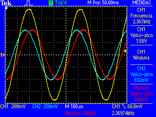

Inductor DCR = 12.5 ohm
Test load = 17.5 ohm
f = 2.37 kHz
I had to use discrete resistors (in parallel) to achive 17,5 ohms, because my pot failed to achieve values in between 1-50 ohms (suddenly drops from around 50 ohms to short; need to get better pots). This is why frequency is not 2kHz.
sqrt((17.5^2 - 12.5^2)/(2*pi*2.37e3)) = 0.1 H
Doesn't seem to be right. Inductance would be two orders of magnitude higher than expected.
The denominator for your formula on the image should be (2*pi*f)^2 , not 2*pi*f . The calculations are correct, however. It should not matter if current driven or voltage driven as long as the DV's are equal across the components. If the AC resistance is significant and not taken into consideration, then the value of L will be calculated higher than it should be. It might explain why your L value at the higher frequency is higher. That is why I would like to keep the frequency as low as practical.

His meter now matches the scope readings of 0.9mH

L = sqrt((17.5^2 - 12.5^2))/(2*pi*2.37e3) = 0.822 mH
When you make your differential voltage measurement, are you putting your VOM leads on points A and B simultaneously?
Both to ground and substracting. The same method I exposed and explained on post 19 and previous.
Scope probes on points A and B simultaneously (both to ground), then plot red trace as CH1-CH2 (yellow - blue).

Your setup looks correct as far as I can see. You appear to be operating the scope in the differential mode (one channel subtracts from the other channel). The frequency is low enough so that high frequency effects should not be a factor. I wonder if the permeability of the coil varies somewhat with frequency, and if the coil is designed to operate at a higher frequency. We know that the number of turns and the physical dimensions do not change with frequency, so permeability is the only thing I can think of that can change the inductance. The inductance at that frequency must be what you calculated because how else can those voltages equalize?
Ratch
I agree. As I said, my multimeter can measure inductance; 0,85 mH, so it nearly matches my results, and so it seems that at low frequencies, this inductor is well below 1 mH.

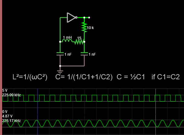

Since I dont know your experience or background,
Perhaps you can expand your parts and make new tools with this typical LC oscillator,
... which also measures L from f.
Since you have a scope.
This is a much better way than RL method.
Then you will have a generator up to ?50 MHz. or limitation of CMOS and your layout.
This is a starting point.
Get a pair of 1% caps from Digikey 10pf to 100nF in decades and keep wires short and decouple Vcc.
(cheap)
This is my design for you in an interactive simulator, where you can move, add change part values or select simple designs. Parts are ideal unless you add ESR.
Merry Xmas
Note: every PIC uC has such an inverter for using a Xtal and 2 small caps. (IN+OUT)
A crystal has similar LC properties in a Pi phase shift circuit.
(cheap)
Merry Xmas
At least one mistake in the image. The resonance formula is L=1/(w*sqrt(C)), not L=1/(sqrt(w)*C) . Did you want to give the formula for two caps in series, or in parallel? Image shows series.

Ratchit , note squared term on both side. Mine is correct
If you dont know already, this is a series C circuit formula.
//C's add just the inverse of //R's
and yes RL time constant is another way that is worse as all resistance influences results. unlike LC
OK, let's compromise and say we are both wrong. The correct formula for series resonance is L = 1/((w^2)*C) , because w^2=1/(L*C) .
