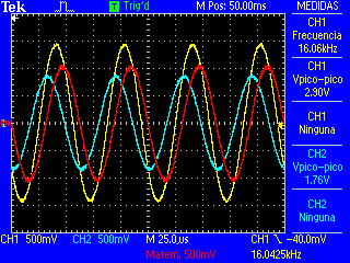

I got some inductances, and I just built a very simple RL (series) circuit.
The goal is to do a basic measure of real inductance.
L = 1mH (axial resistor-like inductance).
R = 100 ohm
Connected as:
voltage source --- resistor --- inductor --- ground
Approach:
A perfect voltage divider would happend when reactance equals 100 ohm. Right?
f = 100 / (1e-3 * 2 * pi) = 16 kHz
Simulation:
Peak-peak voltage across each element match. Current lags voltage.
Yellow : source voltage.
Blue: inductor voltage
Red: resistor voltage.

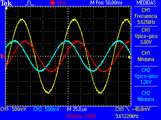

Real world:
1.- voltage on each element match at a much lower frequency (9.6k vs 16k).
2.- peak-peak voltage is not source/sqrt(2), but much lower (40% vs 70%).
I tried with 1 kOhm and 2 kOhm resistors too.
It seems that the gap between theoretical/real frequency narrows as R gets bigger.
It makes me think that the inductor has somekind of internal series resistance, but it seems far to big (I would hope to find something like 5 ohm ESR)
My multimeter measures 0.9 mH (within 10% tolerance).
I must admit this is all I can get.
Could anyone briefly explain what am I missing?

Your method looks solid to me. If the voltages across the resistor and inductor are the same, the reactance of the coil should be the same as the resistance of the circuit, even though the phases of the voltages are different. I notice that that the sum of the instantaneous voltages of the coil and resistor are equal to the instantaneous source voltage for the simulation. That is not true of the "real" circuit. Why don't the instantaneous voltages add up correctly? Where is that extra instantaneous voltage from the source going? What is the resistance of your voltage source? 50 ohms? That is half the value of your test resistance. See something wrong there? Don't try to measure the instantaneous voltage with your meter, you need a scope for that. No need to get tangled up in phase calculations of impedance either. Forget about resonance, you do not have enough capacitance in that circuit to make resonance happen. Use a 10k resistor instead of 100 ohms to swamp out the 50 ohm source resistance. Let us know what happens.

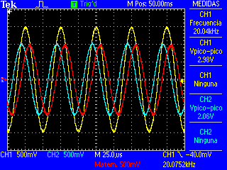

This is the good capture for 100 ohm + 1mH
At 16 kHz (theoric reactance = resistance; works on simulation, but on real circuit resistance is still bigger )
At 20 kHz we achive the point.

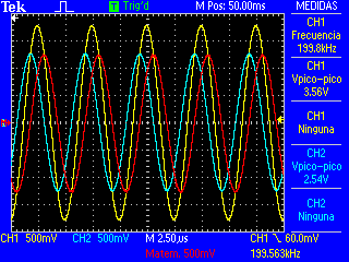

Next I tried with a bigger resistor. I'm using a pot set at 925 ohms.
200 kHz. Theoretical/simulation happends at 147 kHz.
The ratio of the "freq offset" increased.
From 20/16 = 1.25
To 200/147 = 1.33
Doesn't it suppose to decrease?

I wish you would have used a 10K test resistor like I suggested. OK, so (925+13)/(2 pi 200000) = 0.000746. The extra 13 ohms is for the resistance of the coil. Then multiply another (1+50/925+13)% because the test resistor is only 18 times greater than the source resistance of 50 ohms. That gives 0.000786. Next we multiply by 1.1 to account for the possible 10% variance of the inductance. That gives 0.865 mh. So that appears to be what the coil could be regardless what they labeled for its value. You can see how the values change if the test setup if not what you think it is.
